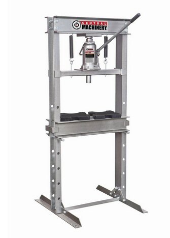

Is anyone using the H shape shop presses
( 10 ton and up) made for arbor pressing etc.for gluing/pressing wood parts? The have one or two hydraulic jacks that could be adapted using platens etc.
You could also put several in line to press longer parts.

There may be problems with the jacks leaking off over time. Most jacks will slowly bleed off though some less than others.

Wouldn’t a bar clamp or vacuum bag be more flexible, cost effective and efficient with space?

The jack may leak off with time.

I've seen this done once or twice. One company I know of was making laminated chair backs by stacking male/female caul sets about 6 sets high. The overall height of the press was about 6' so it could hold the 6 press sets.
I've often thought that on a smaller scale you could pull the same thing off with an inexpensive bearing press.
