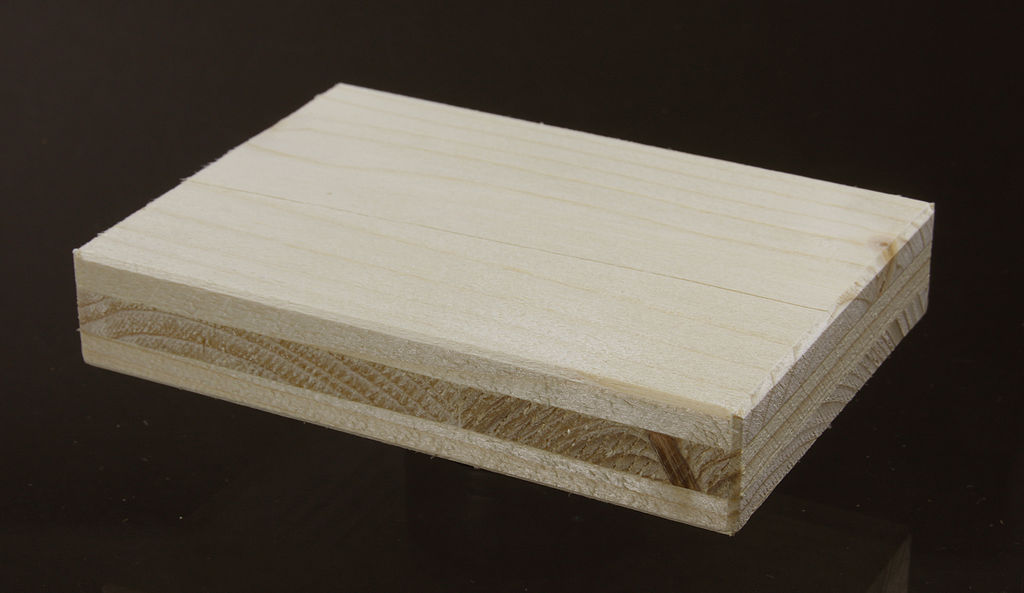

I am at the point where all I ever believed as rock solid in this craft is dissolving to less absolute, soft guidelines rather than rigid laws and rules.
Maybe 3/8" thick solid wood can act like solid wood, and maybe it can act like veneer. How much of one, or the other, and when and where it will work, or won't work, I do not yet know.
I do know the 3 and 5 ply mega panels in Europe have caused me to stop and think. These are sized to where they are building entire structures out of what most of us sitting here would call doomed panels.
How can it be? Should we let them know this will not work?
I personally have had no failures from thick wood being being used like veneer, only at 3/8" thick and seeing no problems. I also have never seen a problem with unbalanced laminations in door stiles and rails.

The Germans have been using panels that some question for a long time - see link below. They usually do their homework.
John
Link
