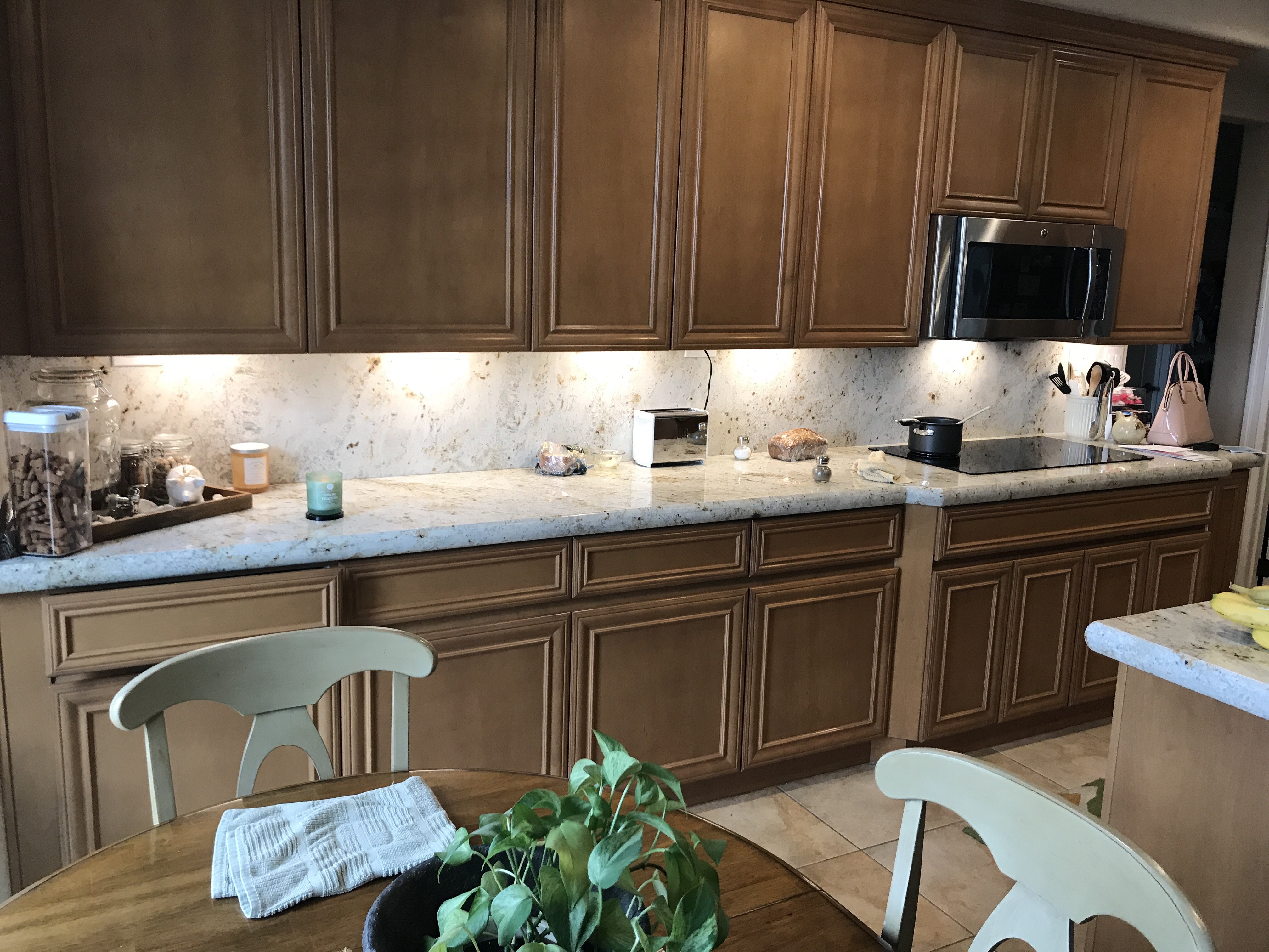

Hafele also has a service you send them a drawing of what you want to do and they will send you a list of what you need. Its pretty easy to connect and set up.
Pic is of my Kitchen 6 of the 6” square puck lights on a 24v transformer plugged into a wall outlet with a hafele dimmer
