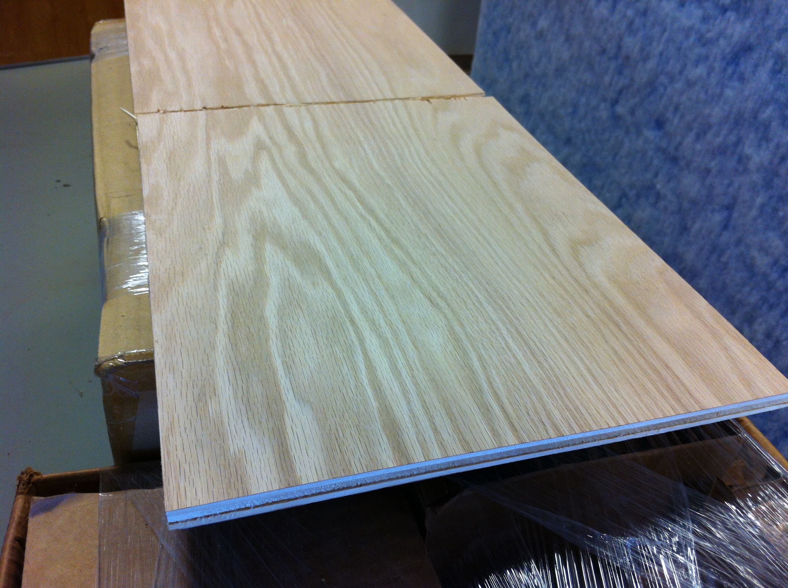

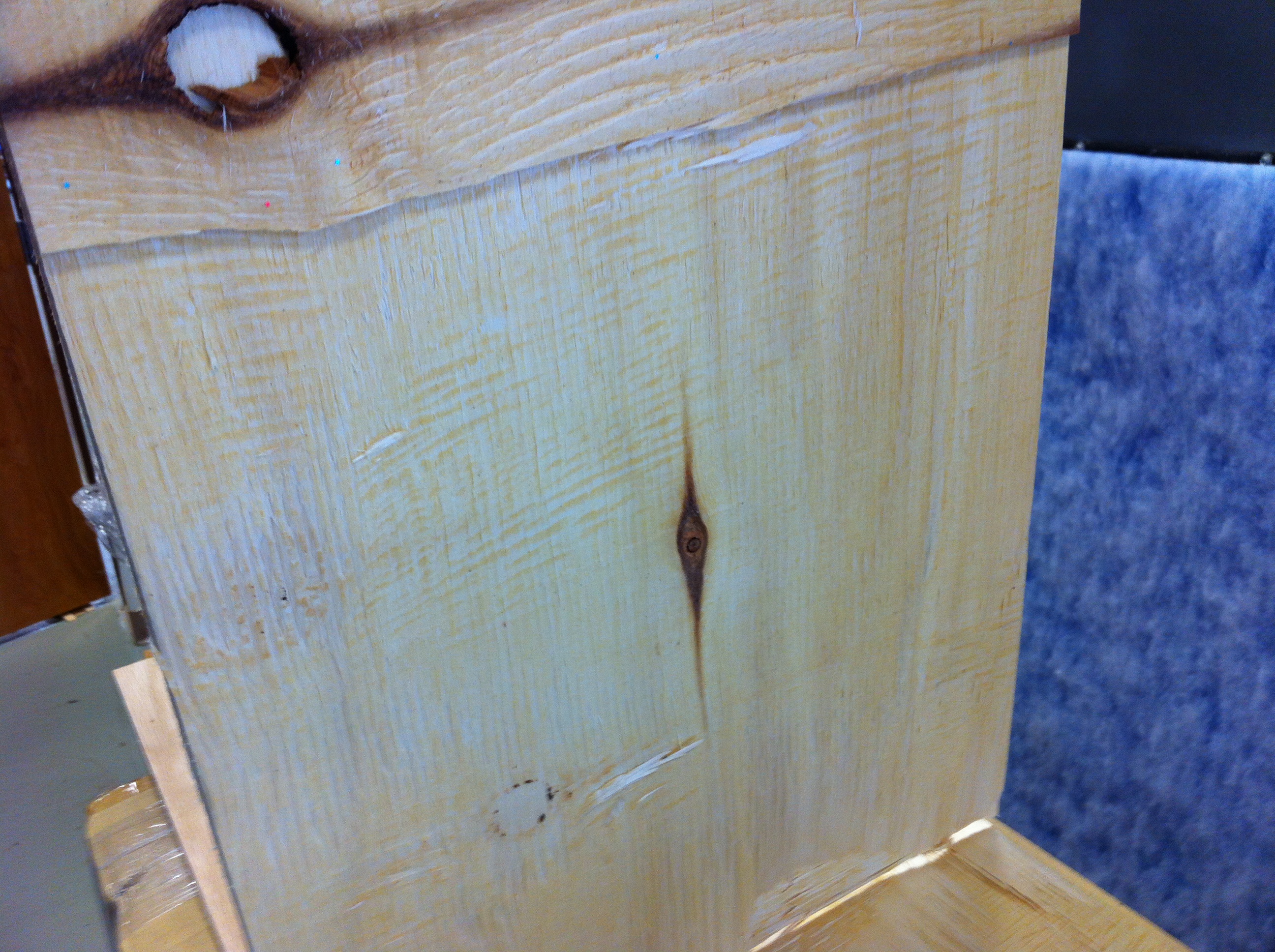

We have been using Home depot Plywood for some time (Columbia Forest Products).
We have always had problems with it but we liked the price. A few months ago we started seeing large areas that were lacking glue. We had someone from HD that came in and looked at what we had and was going to try and work with Columbia to see what the problem was.
It seems to be getting worse today we had a spot that was 8"x16" where the ply just pulled apart and there was no glue what so ever. So far we have not heard back from HD but we have fairly large areas with almost every sheet. we find it mostly on 1/2 and 3/4 oak. Anyone else seeing this?
Thank you for your time

I see several issues in your pictures, all of them can be attributed to poor manufacturing. Home Depot, being what they are, a retail outlet, probably has no one on staff that would have the faintest clue what is wrong, or how to get it fixed. Nor are they likely to go back to the manufacturer, unless they have droves of people coming in with the same complaint.
If I were you, I would search around for a local plywood distributor, they aren't hard to find. They will be able to supply quality material and should be ready to replace (at no charge) quality issues like what you are seeing. They should also have someone on staff who can interact with the manufacturer to get the problems resolved. They also may have plywood from more than one manufacturer and you can ask them about the differences, in price and quality.
When you calculate the "cost" of purchasing plywood as you do now, through retail, you have to add the cost of quality (or lack thereof) to the over-all cost of the product. Sure the "price" may be low, but add rework, lost time, tooling wear & tear, employee complaints (they have to hate that stuff) and all of a sudden the "cost" of that plywood doubles or more.
Don't be "penny-wise and dollar-foolish" take the time to find a good product at a good price that suits your needs. Maybe the "price" will be a little higher, but the "value" is the important element to focus on. If you buy a panel for $50 but throw half of it away, is that better than paying $75 and using all of it?

I've got to agree with all the above posts. We buy from distribution yards. Most of them have sales people that have some idea of what they are selling and a motivation for not causing you problems. On the panels from HD, look @ the edges and see if the word, "shop" is stamped on them. If so, what you are getting is rejects from the manufacturer's regular product line. That is some crappy looking core! If you feel you have to use plywood, get the stuff with the hardboard layer just below the face veneer. It doesn't telegraph and makes the panel a little closer to MDF or P. Bd. cores in quality.

I've been using Columbia for years and I can tell you there have been problems for years. Poplar core has more and more undulations (sometimes looks worse than fir core), delaminations, veneer peel at ends of sheets AND from the middle of the sheet once cut into, bowing in both directions (like a dome, though that's exaggerated), finish is bumpy sometimes, heavy discoloration at ends of sheets, etc. I tried states and mt storm and some other maker (roseburg?) less problems but less pretty sheets usually. These are C panels in prefin maple I'm mentioning from 2 very reputable hardwood dealers. I'm assuming Home Depot gets the off fall from what the wholesalers are selling but Columbia has become marginal on many occasions. My rep came by today and replaced 3 sheets of 3/4" prefin maple....veneer peeling after cutting. FYI

I found out today we are now dealing with Columbia direct on the problem. We buy C grade from HD and we were told its the same as we would get from anywhere else. We buy from HD because we save about $10 a sheet. I will update this as I get more info. Please remember I am not the lead on this problem, so I may not get all the details.
I did make the comment that if the C grade we are getting is the same as our distributors are getting lets see if there having the issues we are.
