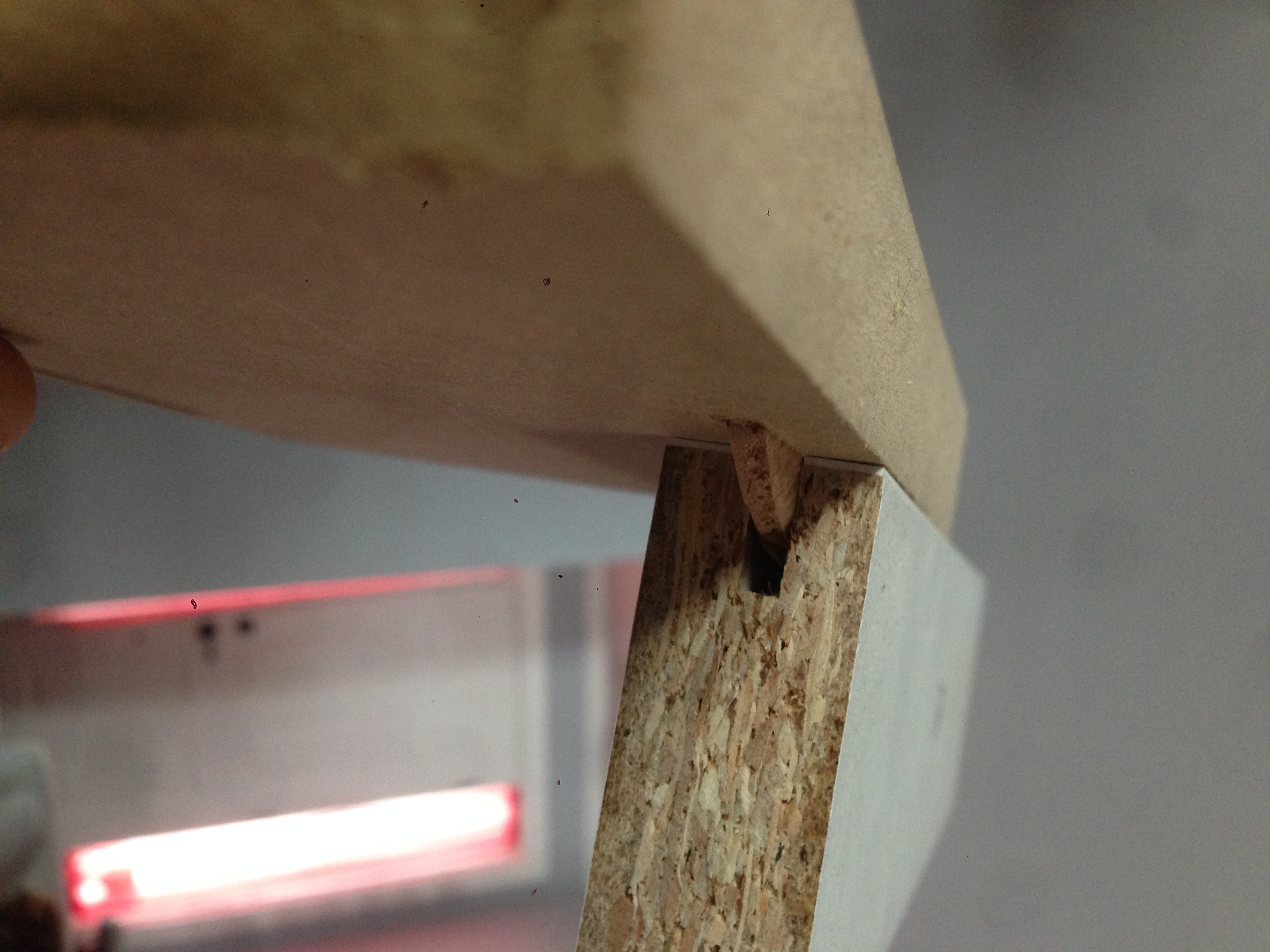

Alessio
If you want a screwless and nailless option, cut a strip, run a groove with a slot cutter along the whole edge, and screw it flush with the front edge of the cabinet, on the underside. then run lamello/biscuits on the back side of the base. After cutting the base to your lenghts you can just glue in place. I attached a picture in case my explanation doesn't make sense
