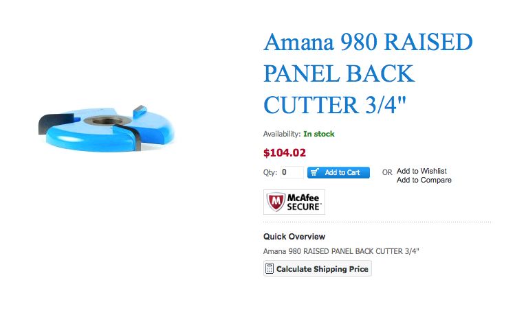

I just bought an old Sears shaper that has a 1/2 inch arbor. It was a pretty good deal and seems to be built like a tank. I want to use it as a dedicated back cutter for MDF insets in my cabinet doors.
All of my shapers to date have much bigger arbors. I am not used to this garage shop stuff. The attached picture shows the profile I want but this tool seems to only be available with a 3/4 inch bore.
Is there a way to get this tool with a 1/2 inch bore?
Or.....is there a way to bush the 3/4 bore down to where it will fit on a 1/2 inch arbor?

JoeW Member
All the shaper cutters I've purchased, to include the Amanas, came with 1/2" reducer bushings. I never use them but I'm sure they will work fine.
You could probably find them wherever you purchase your cutters.

Bob
If you email me your address, I will send you a couple. I have plenty that are not being used.

They make them with 3/4" bore and also why it's a hobby machine shaper with a 1/2" shaft. It needs the 3/4" for strength! Those little machines were never designed to spin a bigger cutter like that. They had little cutters, probably not bigger than 1 1/2" in diameter. Would you run that big shaper cutter on a router? Same 1/2" shaft. You are really looking at a major, major safety issue to push that bigger cutter on that little shaft. Don't do it! It might last a week, might last a year. But sooner or latter it's going to snap!

Ken Member
If it's like the Sears shaper I remember having then yes, they are built like a tank and are similar to the old Rockwell shaper, the one below the "Heavy Duty" model. That said the reason I got rid of mine was the cutter hole in the table was real small (this was 25+ years ago). Correct me if I'm wrong but the cutter you want to spin is 3 1/2" diameter. You would have to add a sub surface on the table top. I personally would give this a shot but you need to look at your rpms. That shaper since it was designed for small cutters probably spins in excess of 10k. You need to calculate this and possibly change pulleys to get down to something reasonable. You also want to keep the cutter as far down on the arbor as possible (closest to the top bearing).
