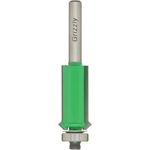

1/17/17 #4: Joined cabinet seam ...
Website: http://s51.photobucket.com/albums/f386/jcquack/Fur...
Here's a bit like I was referring to.
http://www.grizzly.com/products/Flush-Trim-Bit-w-V-Notch-Guide-Bearing-1-4-
Shank/C1470?utm_campaign=zPage&utm_source=grizzly.com
