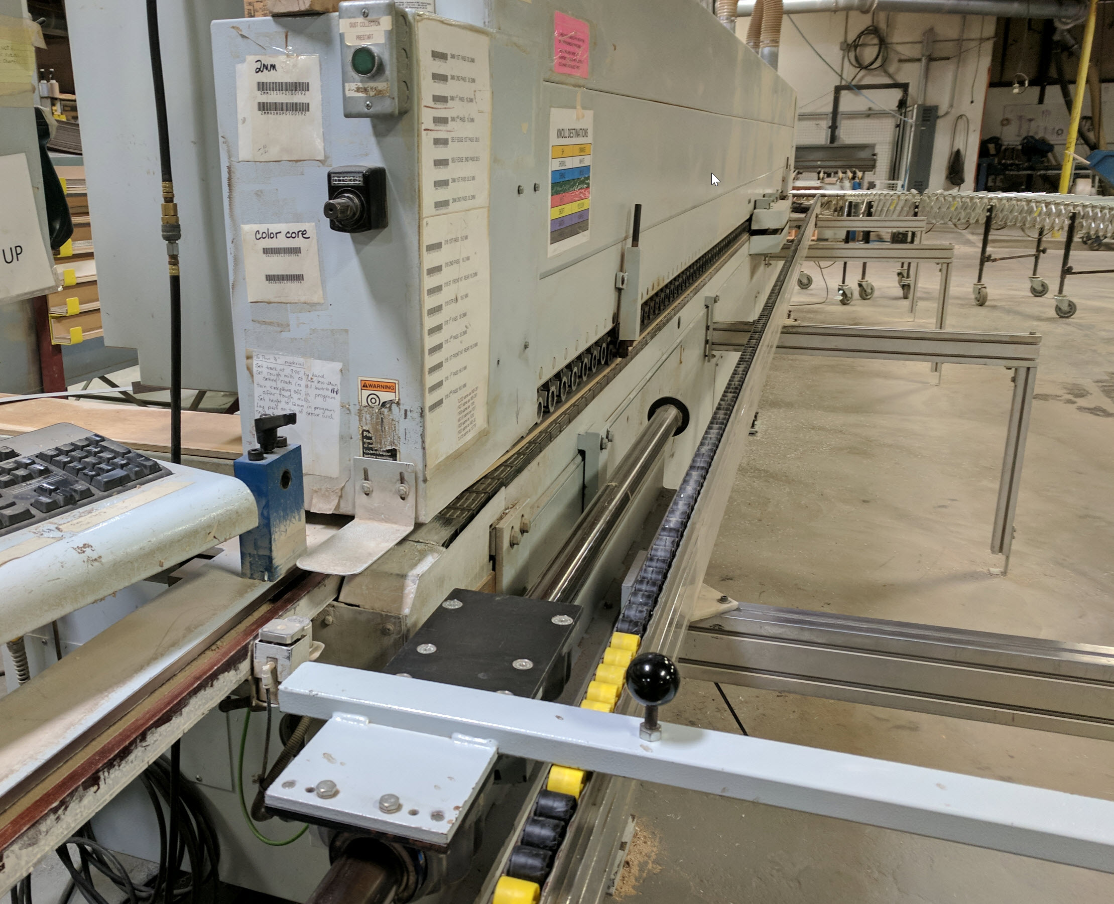

We don't normally have a problem with squareness either, but we mainly use our double sided for squaring. We do have a squaring fence mounted on one of our Homags though. It works well when it is used.

Thats neat, Chad. I've never seen a squaring arm on a machine like that.

I had not seen a squaring arm either. Why I asked. Assuming the arm came from Stiles?
12/8/17       #10: Problem with Square parts from Edge ...
Chad R  Member
Website: http://www.northwayind.com
Yeah from Stiles. I have seen them on IMA's also. Its in the Homag edgebander brochures also.
