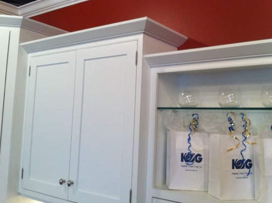

Shaker crown is just a flat board with 45º angles cut on the front and back. Very simplistic.

2/3/18       #5: Shaker style cabinets ...
Mike Fuson
I do it like Leo, use the back cutter on the front and back.

mike
Although harder to make I always liked this shaker crown; it has a lower bead which makes it easier to hide a nail and adds a simple detail. You could also use a simple cove molding.

Chris Payne
Thats what I am sorta liking the most i'm afraid that the flat one may be just to plain. Thanks

People often refer to 5 piece flat panel doors as shaker. It has nothing to do with the cabinet style. Many of our beaded ff cabinets have them and the crown can be small or big. Typically done with the colonial 3 1/4" crown.
I think I've done two cabinets like Mike's in my entire career. The two piece crown makes a major aesthetic difference in my opinion.

The Idea of Shaker (The only architecture Americans ever provided in cabinetry) was simple, they had few options back in the day,
Simple is the key, a single angled or cove moulding is needed to hold historical consistency, otherwise stack or ogee it
