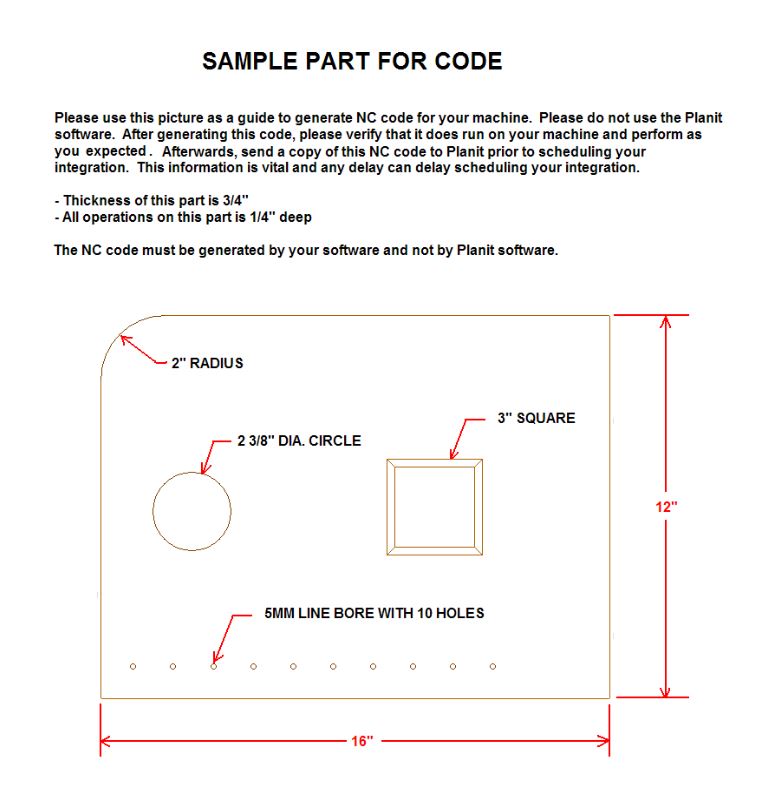

I am just installing a new router and Planit asked for some sample code that runs on my machine. They asked me to generate code for the part shown in the picture without using Planit software and then send it over to them. I have no clue how to write this and the tech installing seems to just be guessing. Was wondering if anyone out there could help me with this. We are trying to write the code in Xilog Plus. Any help would be greatly appreciated!

I just emailed you the .pgm file that Planit needs.
Bill

Thank you for the offer Leland but I think Bill's file is going to work.
