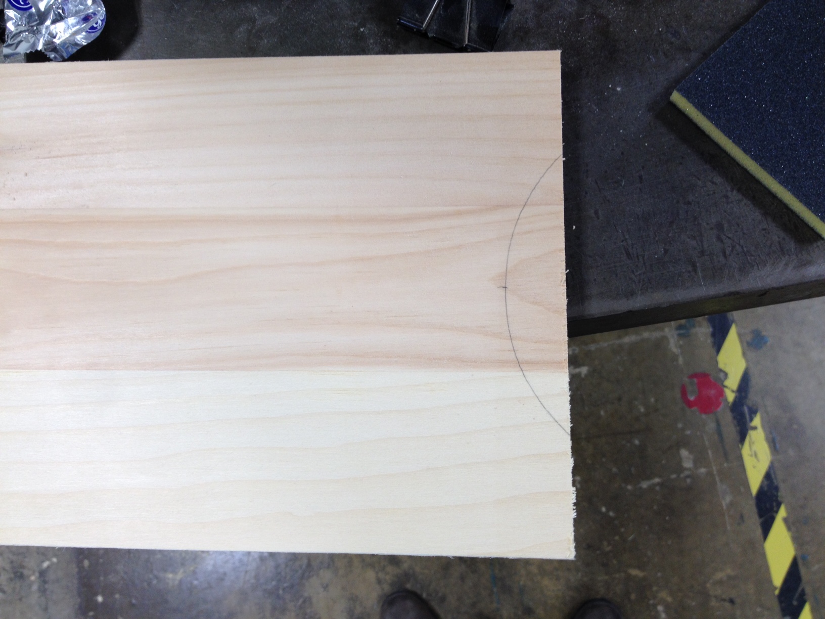

I'm new to programming and having a little trouble figuring out how to program an arc cut out. I'm using Xilog Plus, but can input simple G codes as well. I've asked SCMI for help but haven't received a response in over a week from them.
The panel is 863.6 x 230 x 18 and an origin of J. The tangent points are at 50 and 175mm on Y, and the depth is 26mm on X.
Thank you for your help!

The centerline code would be
G1 X863.6 Y50
G2 Y175. I925.72019 J112.5
This is EIA/ISO standard code, lower left corner of the panel as X & Y zero.
I typically do not work on SCMI so unsure if it will work within their syntax.
Mark T.
