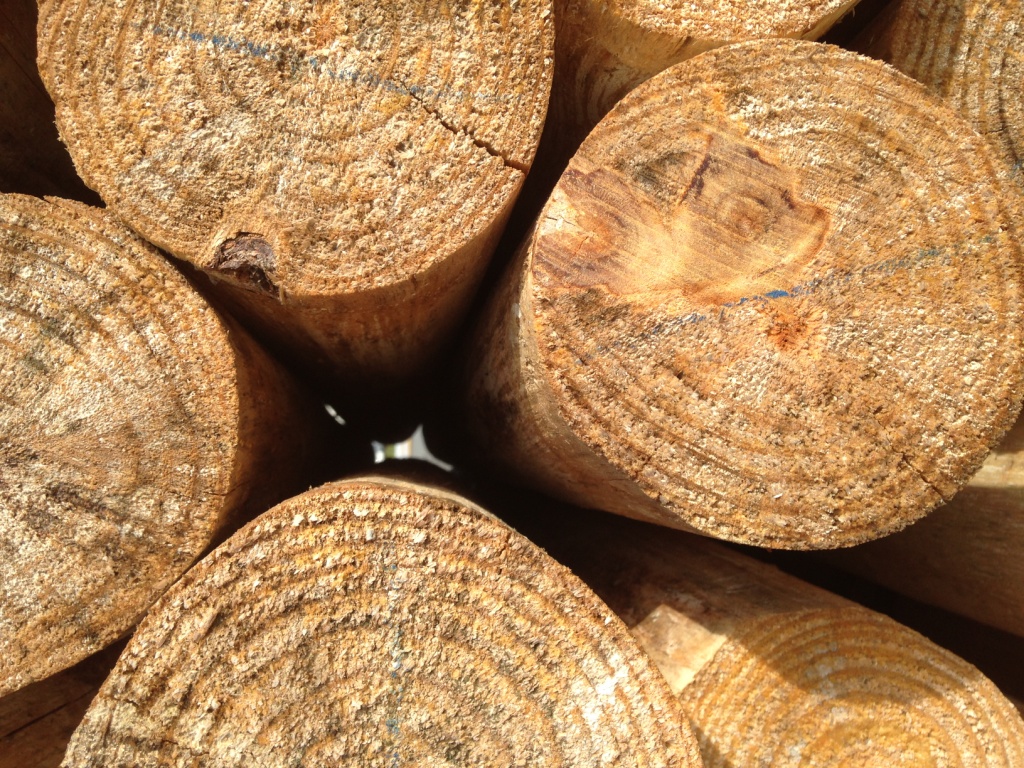

1st pic is bundles on kiln trams
2nd pic is closer image of sap and heart wood, and air gaps

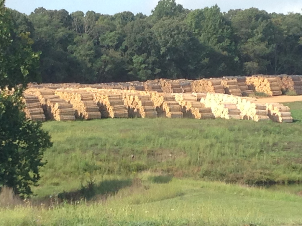

3rd pic is row in which they air dry
