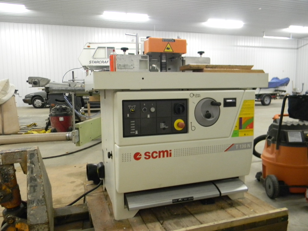

David Kumm
A standard T130 with a feeder and extension tables that can be removed would work well. Here is one I found, redid the bearings and will likely sell. A good feeder is a must and if you plan to do vertical profiles against the fence, look at new Wegoma or used Elu or older Steff Primomatic if you can find one. Old Gomad were good shapers as has been stated. Dave
