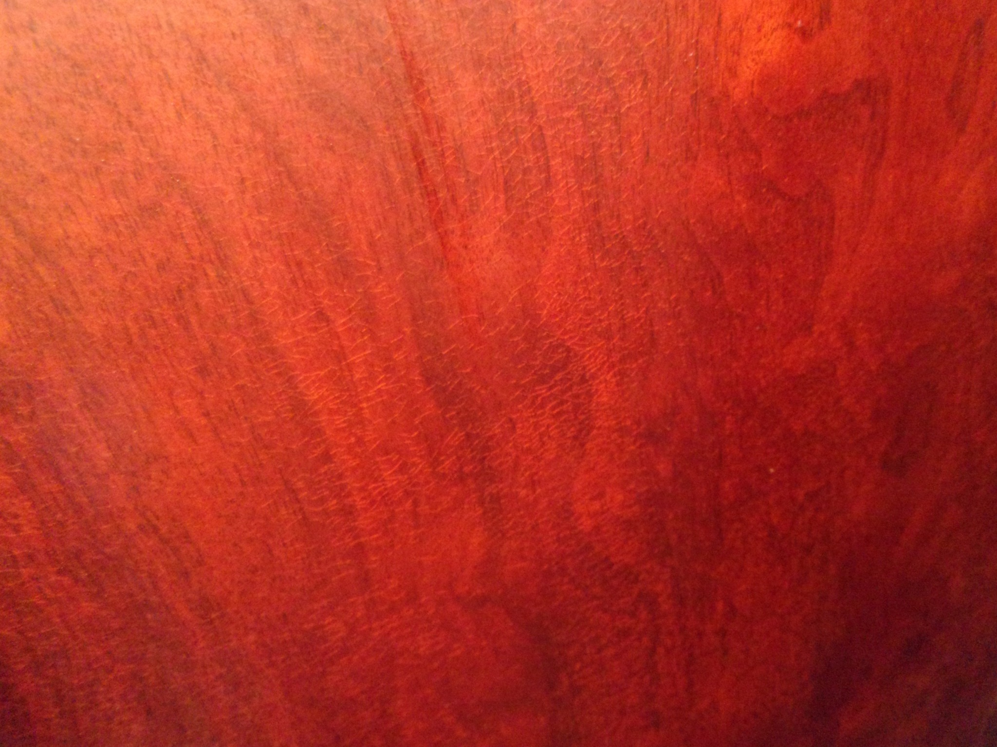

Walnut burl veneer, wiped poly into wood and wiped surface clean. This was done to help set off the grain.
After poly had dried (15 days or so), sprayed fresh shellac on.
Once shellac had cured for several weeks, began sanding the finish level. After a week or so, shellac began showing signs of crazing and wrinkling in some areas.
I would blame the poly, but it had thoroughly dried, and it was not built-up.
As notes:
I mixed up the shellac with some lacquer thinner added to control runs and blushing. Sprayed on with HVLP setup.
Any ideas as to the why's, possible fixes (without stripping and starting over)?

What poly? Minwax? I'd say the shellac is more brittle than the poly, and sets up a barrier issue. Basically a hard finish on top of a flexible one. I'd wash it all down with denatured alcohol to remove the shellac, scuff sand, then add more poly. Next time, ditch the poly if you want to use shellac. If you want a warmer color, use darker shellac flakes.

Shellac and lacquer are both harder than poly. Don't confuse durability with hardness. You also have to consider how "hot" the solvents are. Mineral spirits is a lot milder than denatured alcohol and lacquer thinner.

So you are suggesting putting a harder finish on top of softer again? No matter what kind of oil you put on the wood, the surface will always have some kind of residue on top. Wiping will never remove 100% of it unless there is some solvent used. Even then very difficult to remove it all.

Like Rich C said, you violated a cardinal rule of finishing by applying a harder finish over a softer one. This rule mostly applies to "film" finishes that are on top of the wood vs. penetrating finishes like tung or BLO. Crazing is exactly what you would expect to see in this situation. You may have luck removing the shellac with just denatured alcohol and some Scotchbrite. It may start out as gummy mess, but a few passes should get you down to the poly. Not sure what your solution is after that.

As the others are getting at, the suggestions that "well known finisher" is making are to use penetrating oils, not film forming ones.
Poly forms a film on top of the wood.
The oils in question soak into the wood and do not leave a film on top.
Oils that form films would be just as bad.
For most situations like this, you can find a set of alternative ways to accomplish your goal that are easier.
You don't need to use either poly or shellac, for example, you could probably just use some dyes to accomplish the same chatoyance depending on the wood.
(and them light amber tint or something in the topcoat to simulate warmth and depth)
