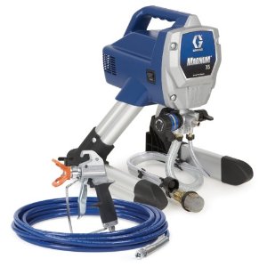

Has anyone used this sprayer for spraying pigmented lacquer.Does it do a good job?
looking for direction on what to buy.My compressor just does not keep up(too small)
I am a small one man shop and I am thinking about buying a Graco

At best, Graco 395 with Fine Finish tips.
Get a used one and try it out. Do you have large panels to spray?
You could try a pressure pot system if your
gun and compressor mates well to cfm requirements.

I use one for my shop. Spray about 15 gal / week of pre cat lacquer. Have been using it for over 7 months and it works just fine. Bought a better tip that the one that it came with for a better finish.

If you can swing it, take a look at the Titan ED655 Plus airless with a diaphragm pump, comes with a hopper that makes cleanup easy. The Graco 395 is a good choice too but a hopper is ~$150 extra.

What model do you use and what tip size did you buy

I have the X7 model and use the .013 tip.
