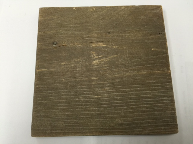

We're trying to match this aging, this sample is Elm. Elm is not available in the large dimensions we need, best I can find is sycamore, poplar, or oak.
I believe there is a wax rubbed on the top.
Thanks for any help.

Question is how to get the dirty gray/brown look. We've given the vinegar/steel wool wash a shot, it came pretty close on poplar but the open grain isn't there. Oak turns blue/black. The grain to me is Ash, but we can't find that in a 2 1/2" x 14" slab.

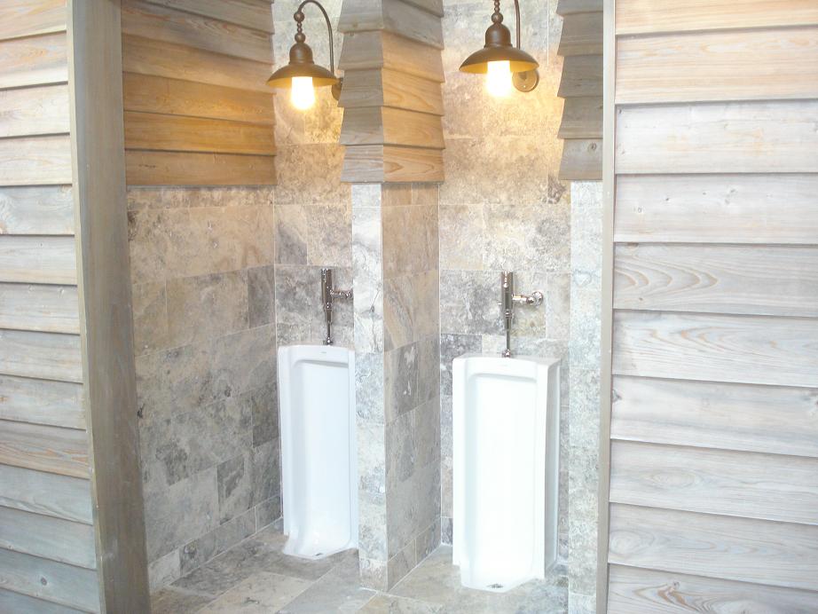

We did a huge restaurant with cypress that was to match Reclaimed cypress (had a beautiful silver/grey/black petina). Everything came out very believable. Im going to see if i can dig up some pics

heres a few photos.
View higher quality, full size image (922 X 692)
View higher quality, full size image (692 X 922)
