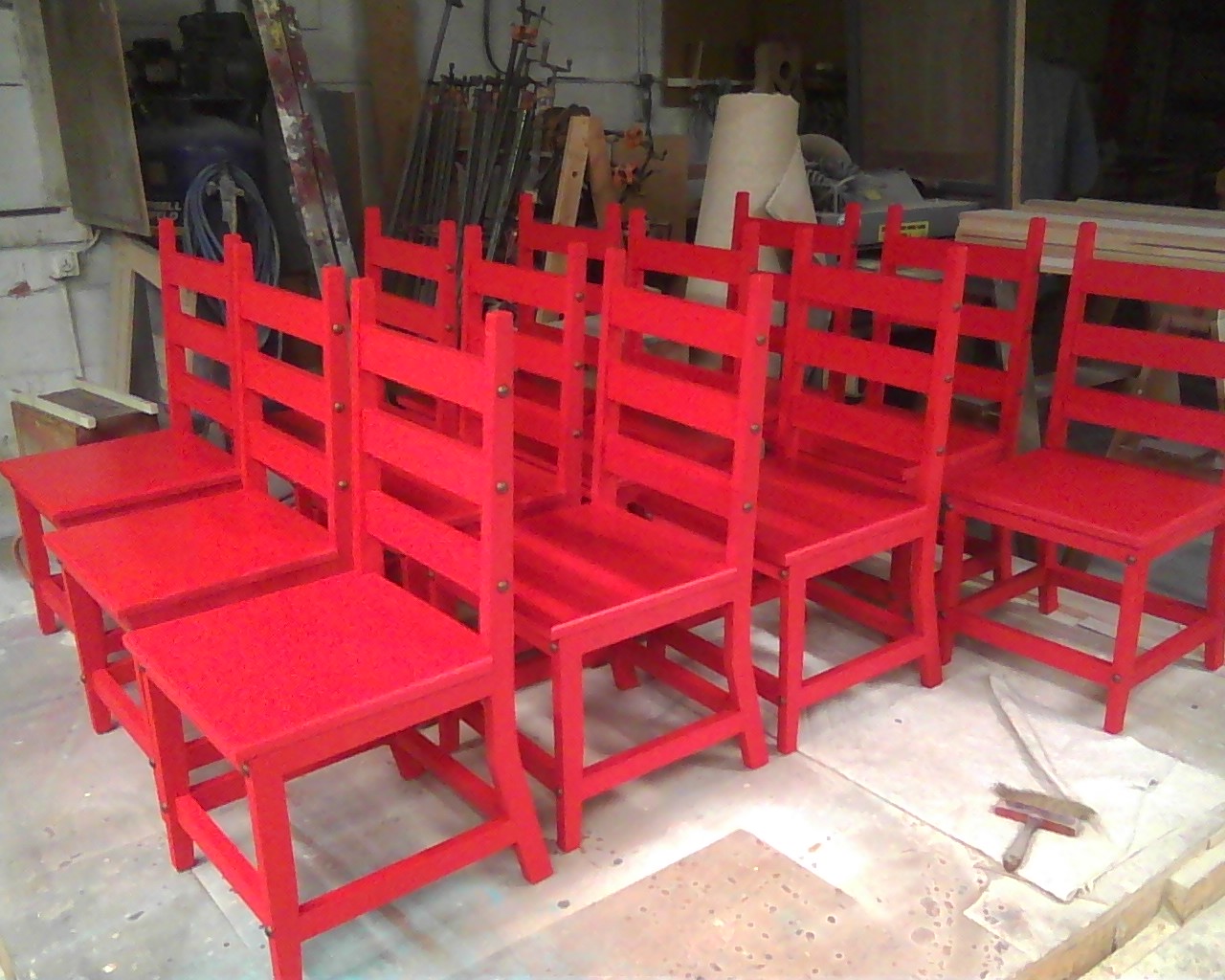

Harry Devrieze
Pretty much what John said . I use WB flat acrylic paint . Brushed and lightly sanded. Then I clear coat with a matte finish. I like Chemcraft vari-cure.
Color does not yellow of fade and the clear coat give great wear resistance.
Try a sample.
View higher quality, full size image (1280 X 1024)
