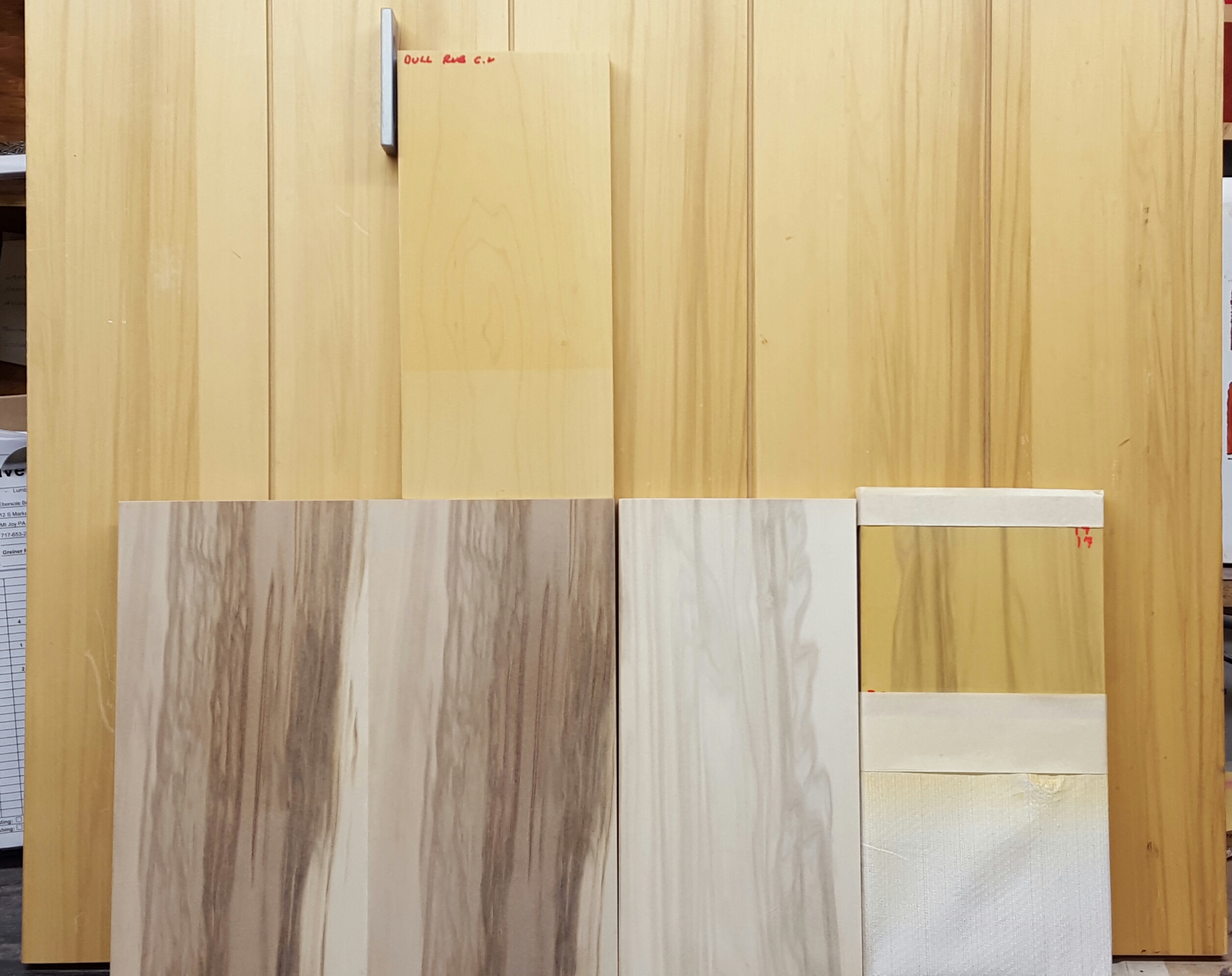

I have a high profile job that I need to match a color for. This is an addition onto an existing job. The original wood species used was Red Gum veneer. In the next room over, the customer has elected to use hard maple. I have matched the color on hard maple and it has been approved. However, the customer wants to add some additional cabinets and panels in the room with the existing Red Gum.
I am having a lot of trouble with the Red Gum because of the dark heartwood. I have bleached it 3 times and I think it is as light as I can get it at this point. Even with my best match so far, it still looks like the heartwood is coming through darker than the original. Also, the door I am matching has some sun exposure on one side making it not exactly the same color all the way across. At this point I would settle for matching any section of the door, but I can not seem to get the correct shade of yellow/orange. I am using a spray stain that I made from Sherwin-Williams P63 Vinyl Basecoats. I currently have white, a little yellow oxide and a little burnt umber and a tiny bit of red oxide mixed in a reducer solution.
In the picture, the door I need to match is in the back. Unbleached Red Gum on the left. Middle is the bleached Red Gum. On the right is the closest that I have gotten so far on the bleached Red Gum. The sample on top of all of the others is my match on hard maple. I find it hard to believe that anyone before has gone to so much trouble to cover up the heartwood on the Red Gum. Could it be that the heartwood has lightened up over time? Was it lighter to begin with? Is there a way for me to match the aged yellow/orange color exactly? Do I need to pre-stain the heartwood with something? I tried a S61 dye stain, but it was too intense for the spray stain to cover up. Also, if anyone has a better color combination than the one I am currently using, I'm open. I usually use the P63 vinyl basecoats for spray stain because I think that they are more consistent/even than a regular stain for spray stain. Any suggestions would be much appreciated.

nick
just a thought...after the bleach try a white wiping stain (you may need to try a few reduction ratios) then apply your spray stain or possibly just seal and shade/tone. SW's BAC wiping stain has a lot of pigment and 1 hour recoat time. Also since it has very little binder in it you can remove excess pigment by wiping with a thinner rag.
