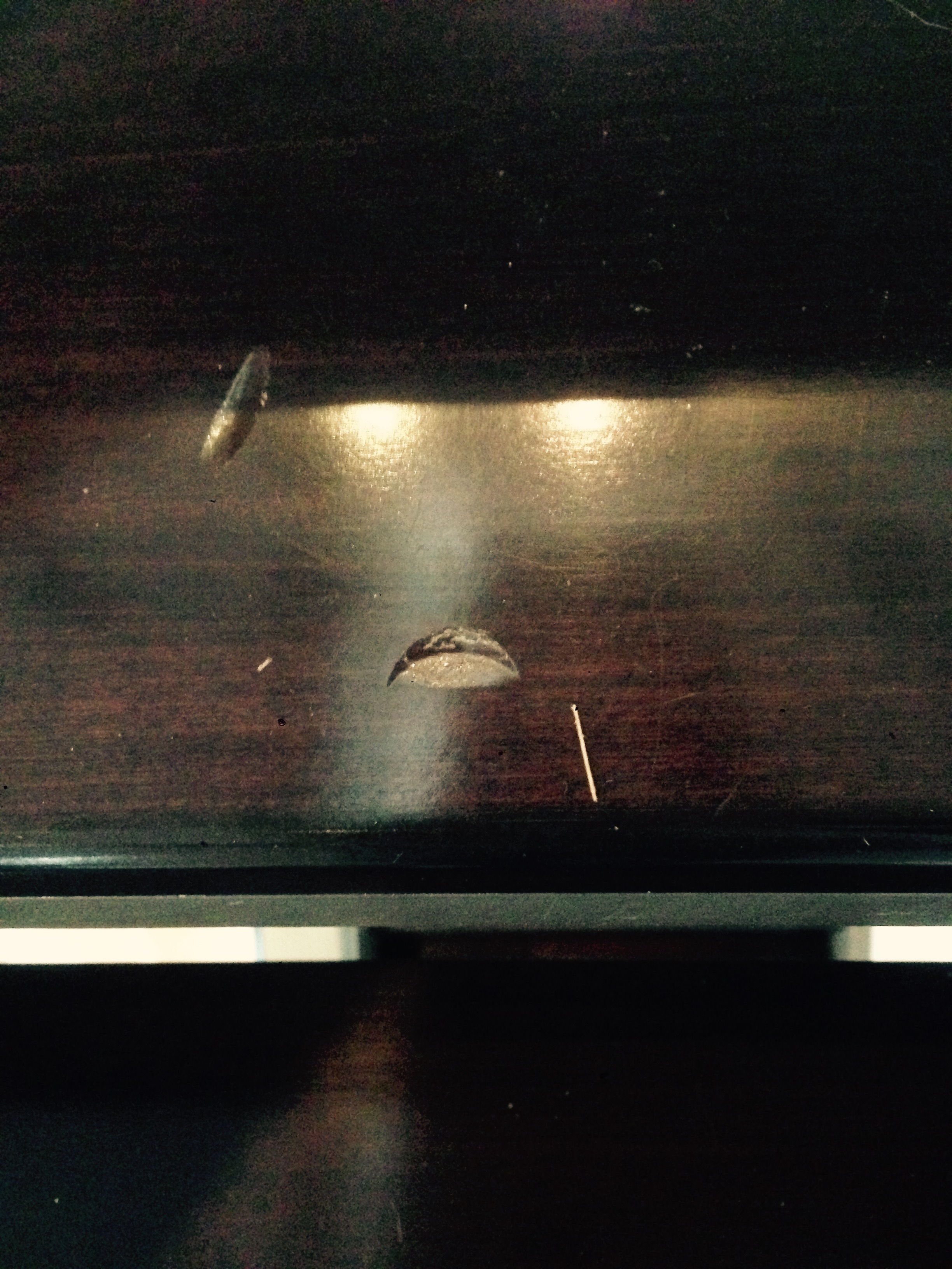

Hello,
A client of mine dropped his weights and they rolled down the stairs. I did not originally finish them, but he said they were installed finished, so they are either lacquered or varnished.
What is the best way to go about repairing them? I was thinking fill them with clear epoxy or something that won't shrink as it dries, then sand it level and apply one coat of varnish or poly.. Other option is using the mohawk hard fill burn-in stick, but not sure if it is well suited for big dents.

That is the classic scenario for using the shellac burn-in sticks.....then a small bit of gaining.....maybe a touch of over toning/shading as well...and then some clear that is designed for a horizontal surface.

might also consider the Mohawk Epoxy "tootsie rolls".

No fill yet!! Go buy a cheap steam iron. Tape off the area around the dent. A dent is a compaction of the cellular fibers of the wood. If you hit is with heat and a wet rag you will pull most if not all of the dent out. You have some breakage in the fibers that may not come back, but most will. Sometimes you need to cut the wood along the grain lines, with a razor blade, to break the seal from the finish to get the steam in. Do this several times then fill ( bondo or burn in) your choice.

I think the iron would work well for that "dent" at the upper left.....but I cannot imagine any amount of Heat/Steam is going to fix that gouge, the one at center, that looks like it is one half of a the head from a Framing Hammer..?

I second the use of steam. At least, as the first response. The remaining work will be more subtle.
