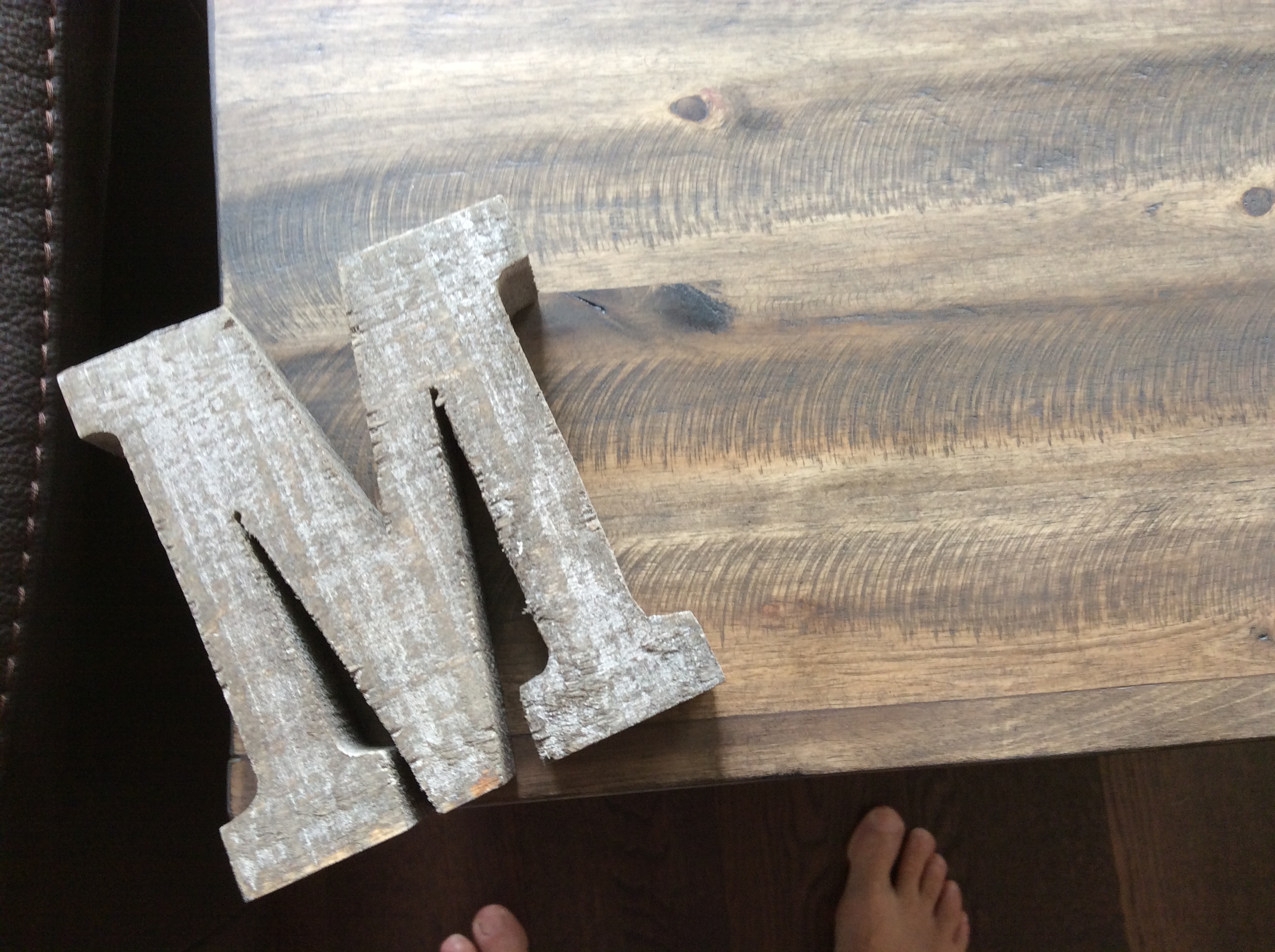

Customer wants a coffee table made of wood to have the same finish as the letter "M" in the picture attached. Any advise on how to create this kind of finish?

chuck a wire brush in a corded dril and go to town in the direction of the grain.... make a light wipe stain of your choice or dilute a dye stain and spray or wipe... your preference.... 2 coats of vinyl or sealer... reduced a bit but enough to lock in the stain and not burn through to bad when you scuff it.... scuff... apply a glaze made up of clear glaze base and dirty white tint.. or even a powdered break away type glaze and scuff back the powdered glaze or wipe out the oil based glaze to desired look or even get it wiped back even more with a naptha soaked rag... topcoat...done

There is no distressing in that letter M, it's just fresh off a band saw mill. The table under it is a different story. Just a really thin white wash coat with a quick wipe off on rough milled lumber gets you the result.
