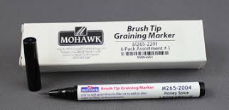

Pat
I have dealt with this successfully using Mohawk markers. One was a very dark stain on maple where the contrast was very stark.

We purchase doors, so don't have the option of pre-staining panels before assembly. We puddle stain where the panel and rail/stile meet and blow it in before wiping. That usually works, but these panels shrunk more than usual. We wiped stain on the newly exposed wood, and that helped. Just looking for something else we haven't thought of. The Mohawk marker idea has some potential. Thanks Pat.

Daniel Shafner Member
Mohawk Finishing makes fine line touch up markers called Brush Tip Graining Markers. These are dye-based markers, available in several colors. Get a set.
