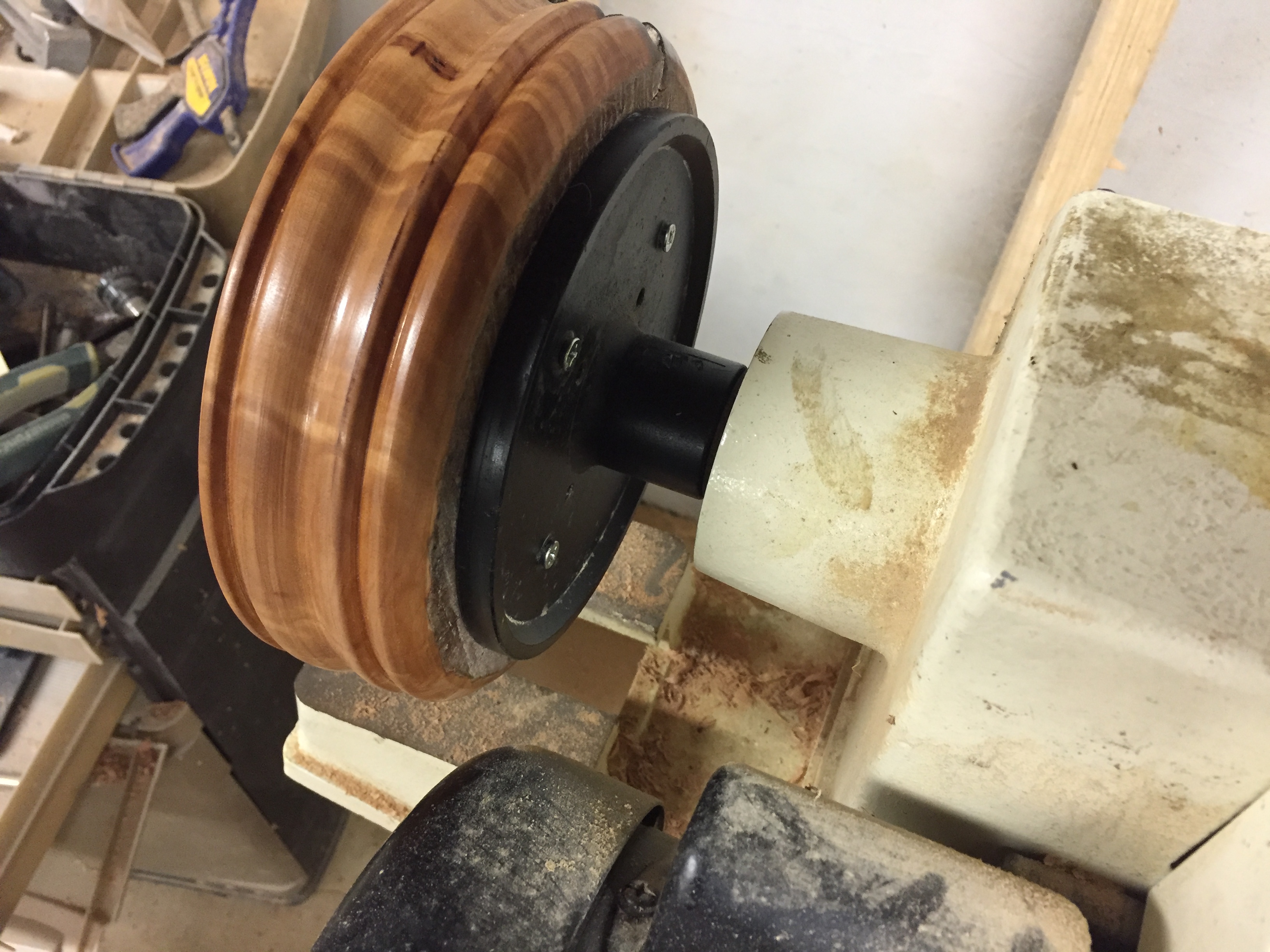

I was just turning a bowl and went to remove the faceplate and it's frozen. The faceplate is round, so i can't put a crecent on it
Anyone know how to unlock it?
6/27 #2: Jwl-1236 lathe issue ...
You could use a pipe wrench.
6/27 #3: Jwl-1236 lathe issue ...
The jet faceplate has 2 set screws did you remember to check both of them? If so then yup a large wrench and go for it.
6/27 #4: Jwl-1236 lathe issue ...
I would just take a piece of hardwood or brass and catch the edge of one of those screws and peck on it a few times with a mallet and I'd bet it'd pop free. Pipe wrench, channel locks, or strap wrench.
6/27 #5: Jwl-1236 lathe issue ...
Use a rubber shelf liner to grab the bowl and hand wheel, or buy a rubber strap wrench. Don't snap the faceplate hard up against the shoulder next time.
6/27 #6: Jwl-1236 lathe issue ...
It looks like you might be able to get the screws out as is. Then you could probably clamp a hand-screw onto the faceplate to use a a big handle.
