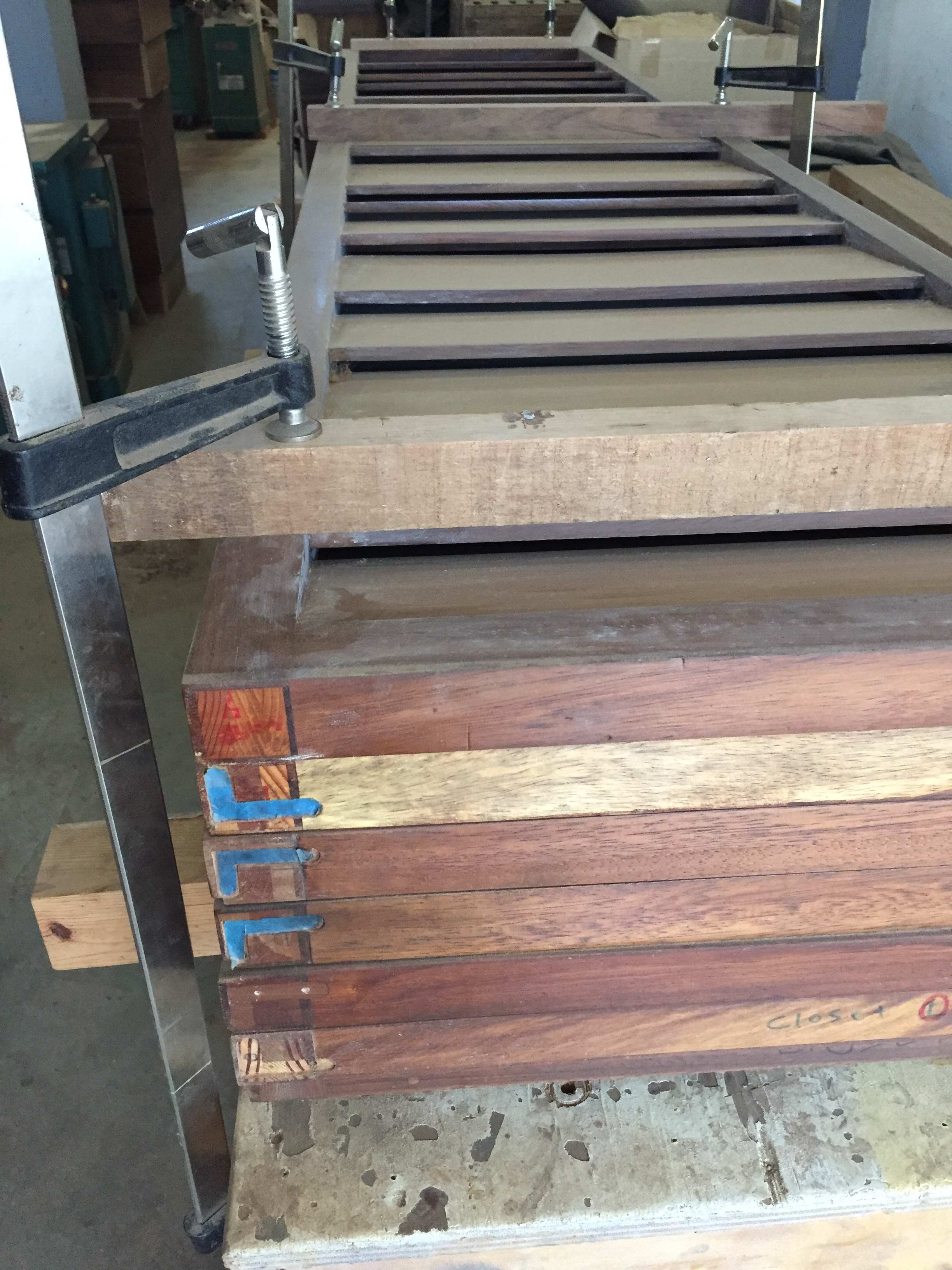

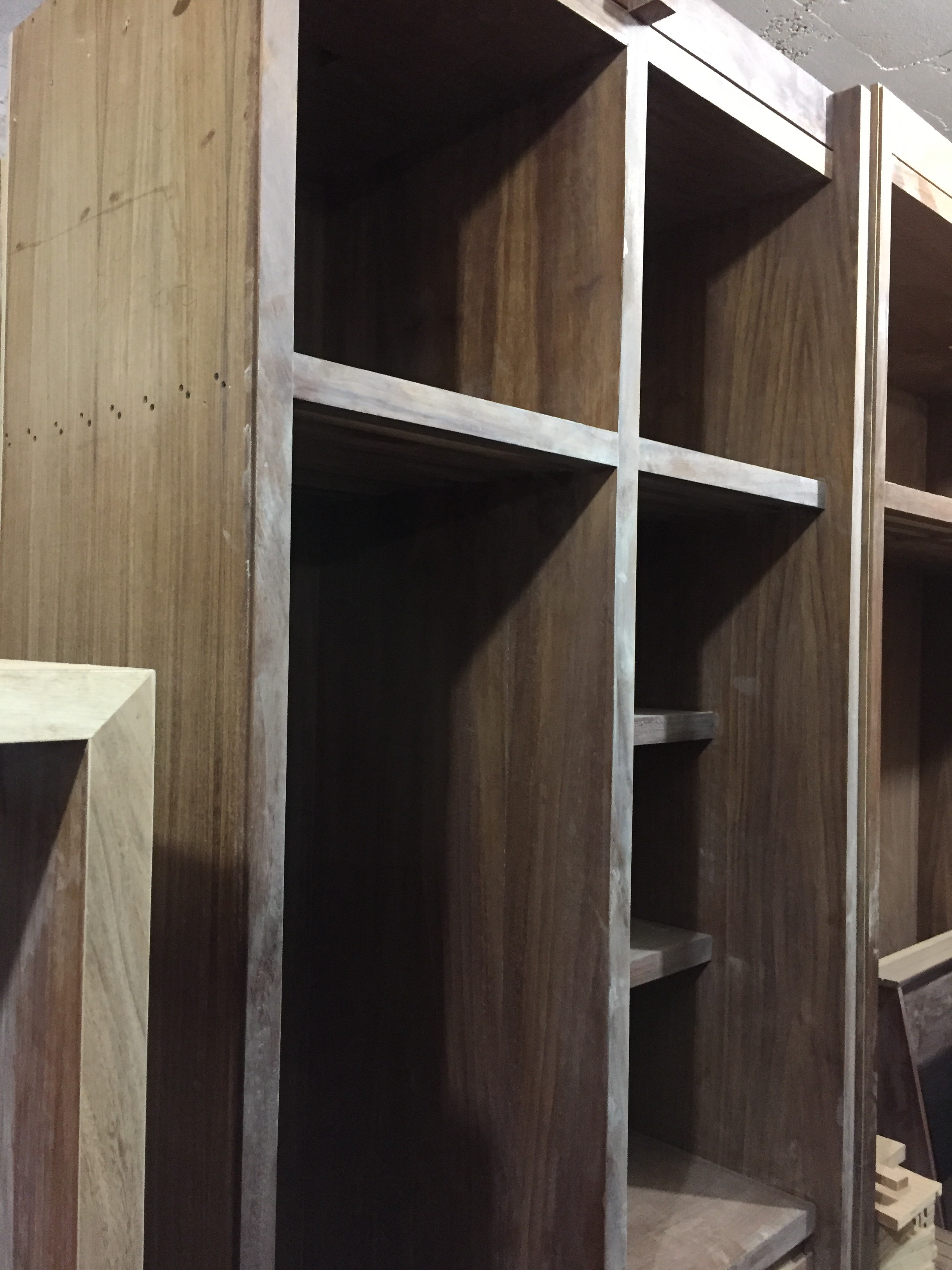

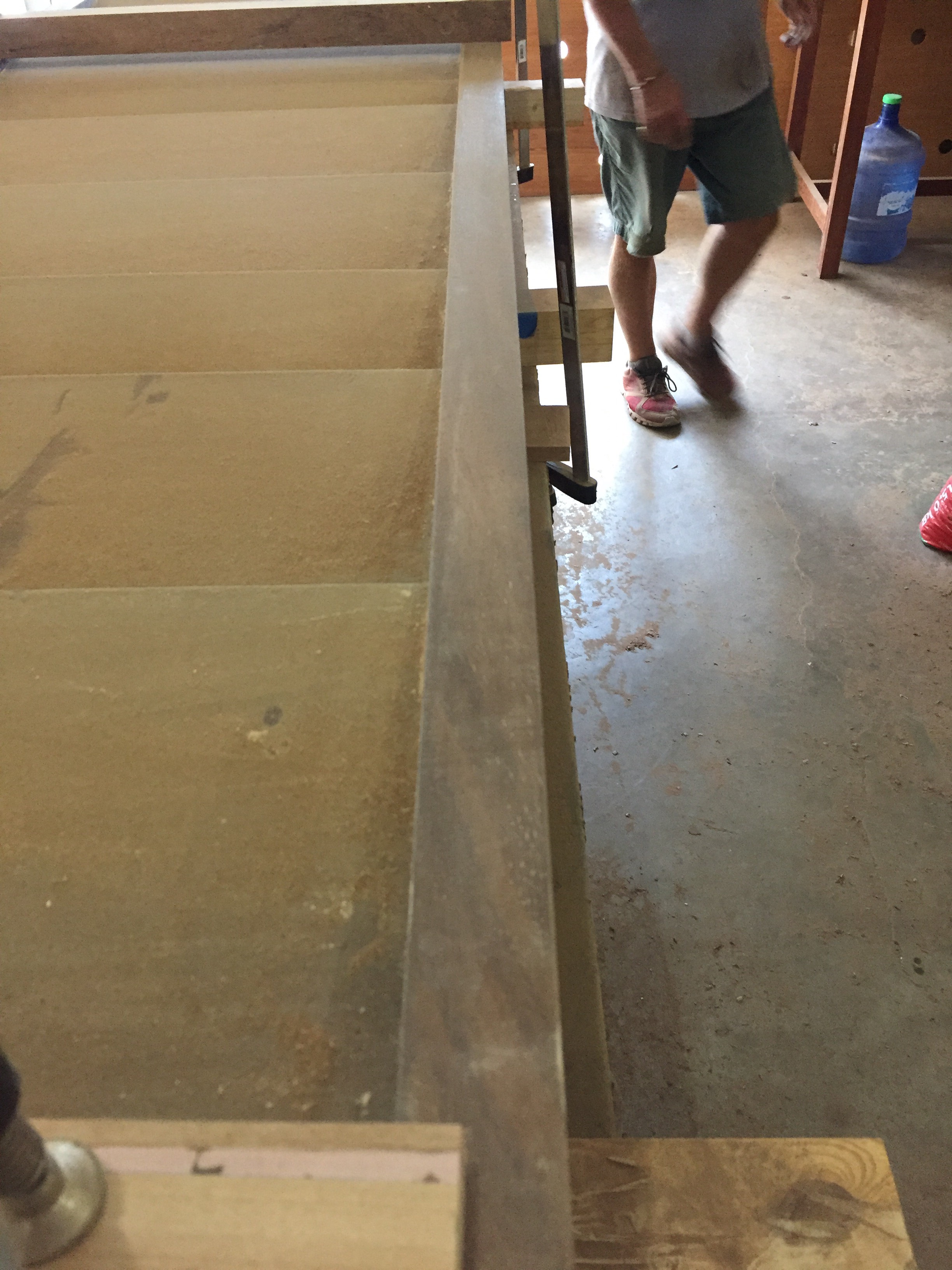

I have louver closet doors to mount with the stiles and rails 4cm x 4cm. The closet sides are 4cm wide and I need the overlay to be 37cm. I done the hours long google searching for the hinges but can't find what I need.The hinges need to be soft close type.
Anyone have any source for this type of hinge?
