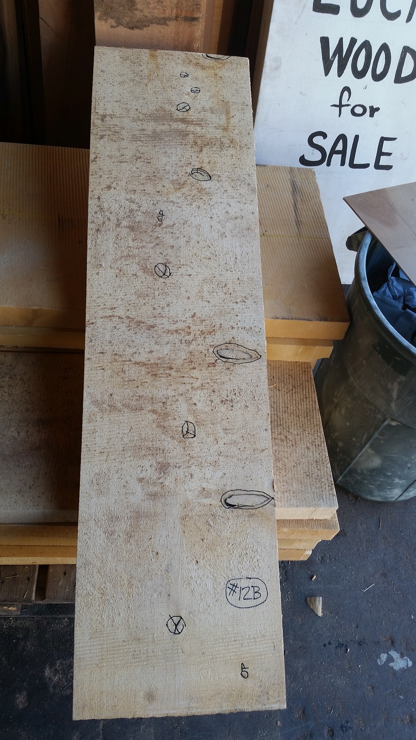

What should I expect of a select finish grade AYC in terms of defect. Knots,pith,end checks,face checks,etc...
material is 10/4 x 14 and wider
rough,KD.
thanks for any insight or possible site that may have the ruling listed.

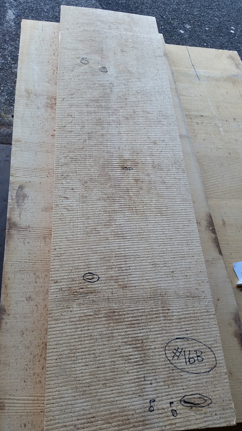

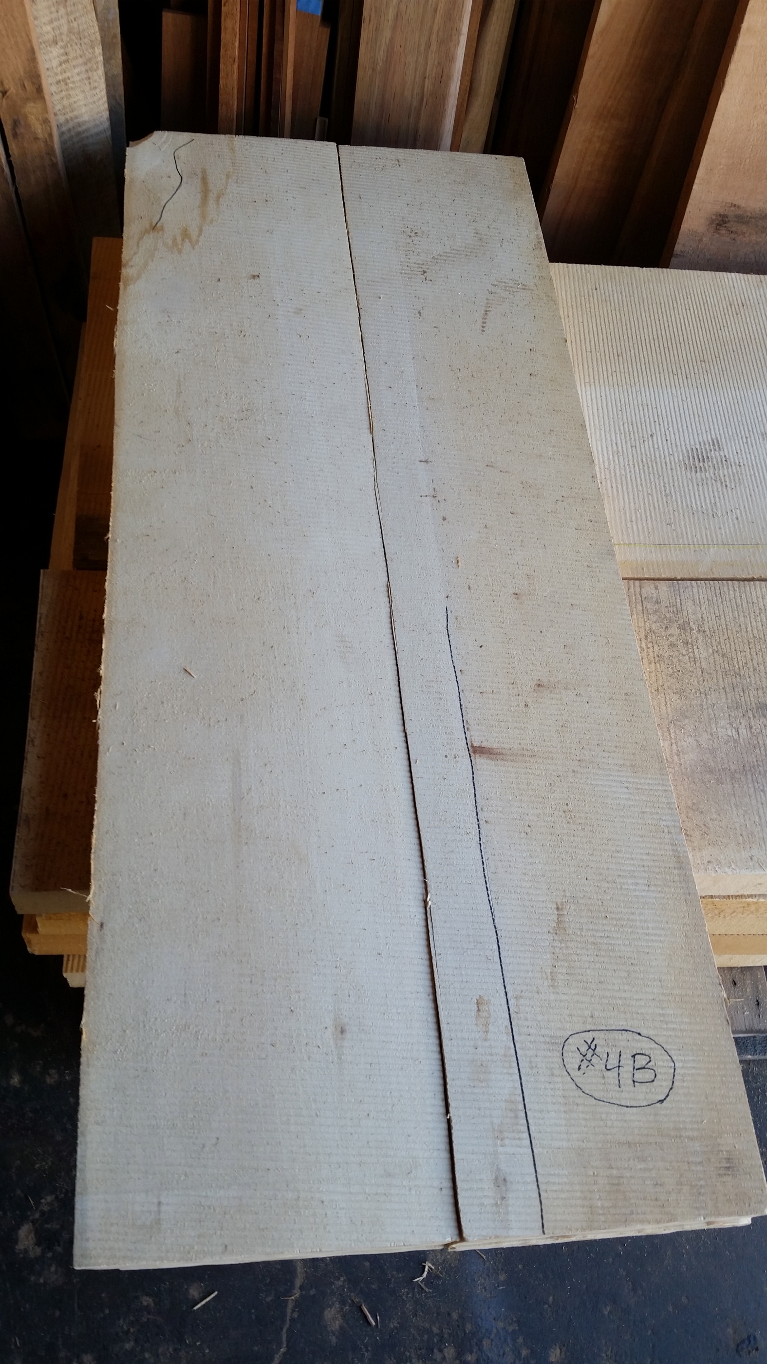

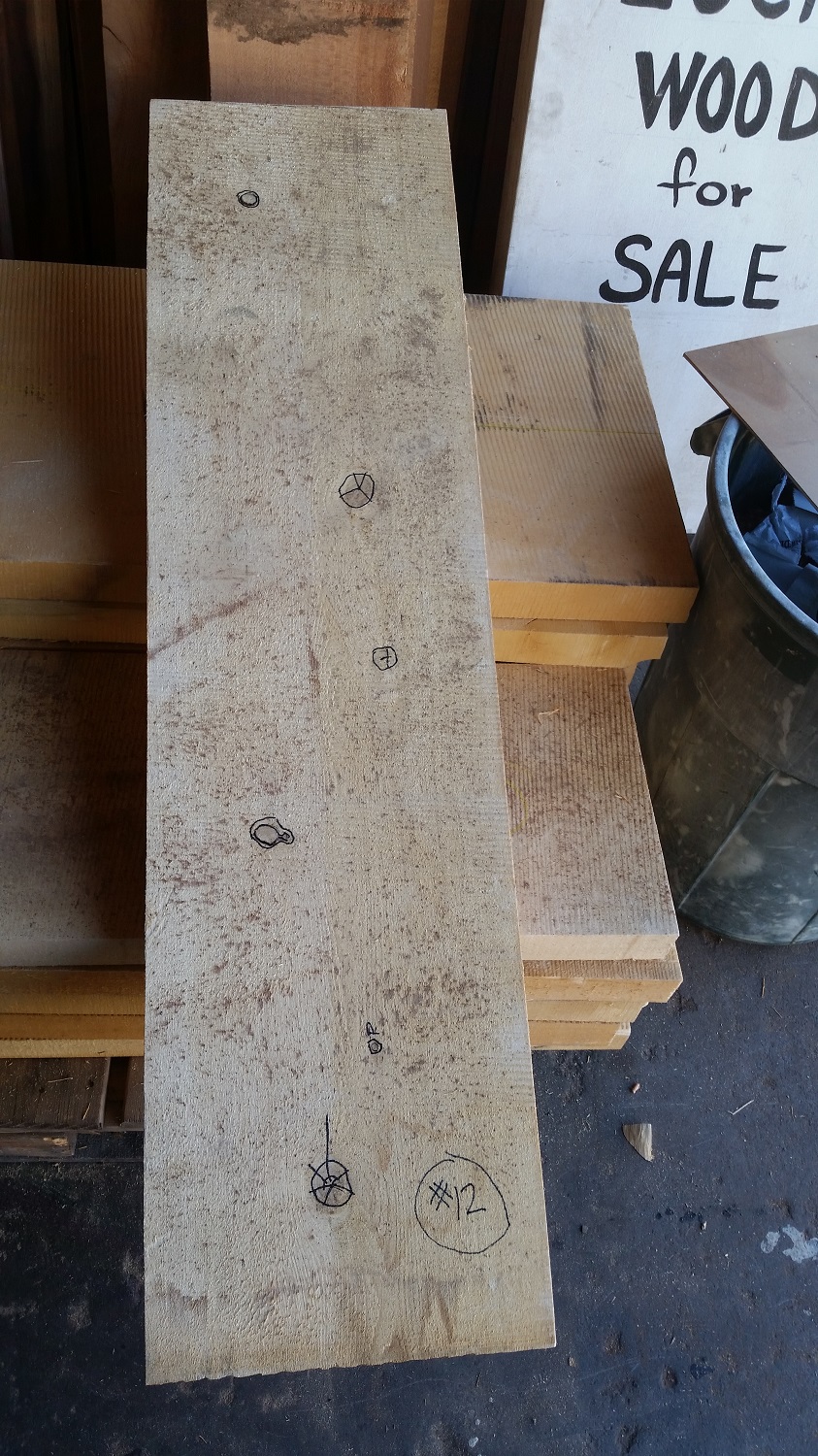

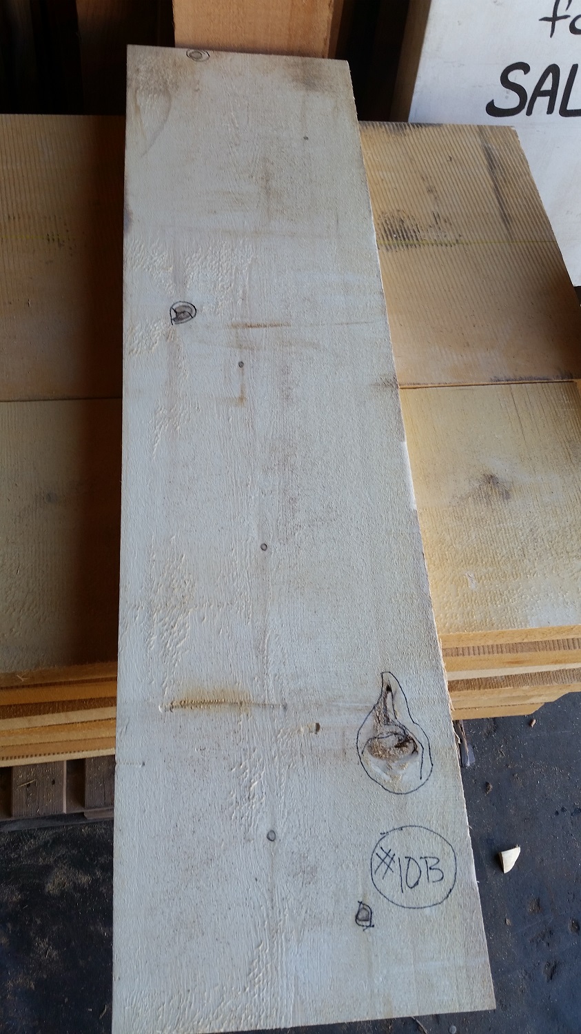

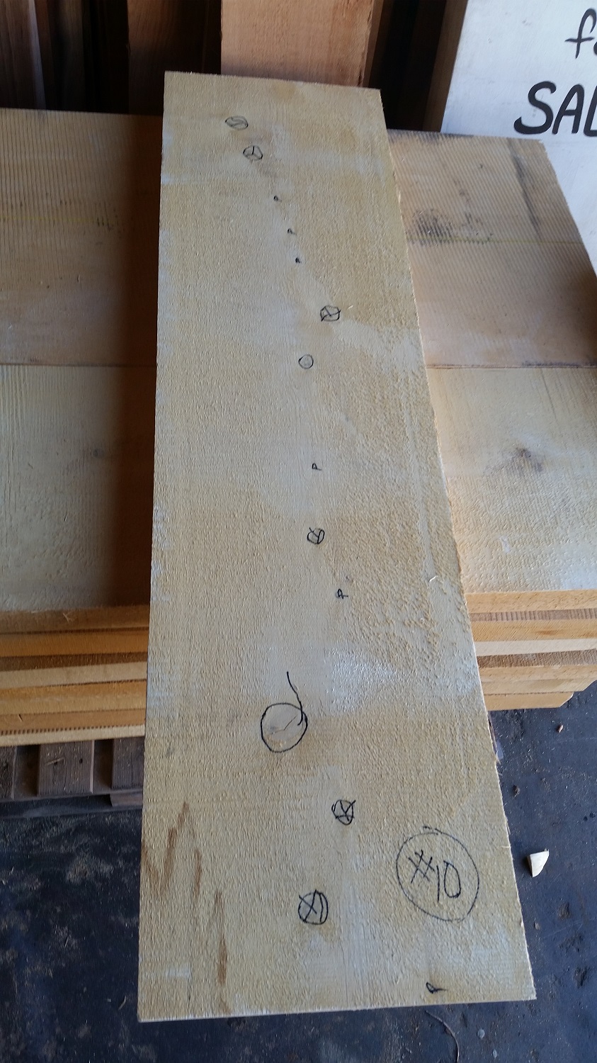

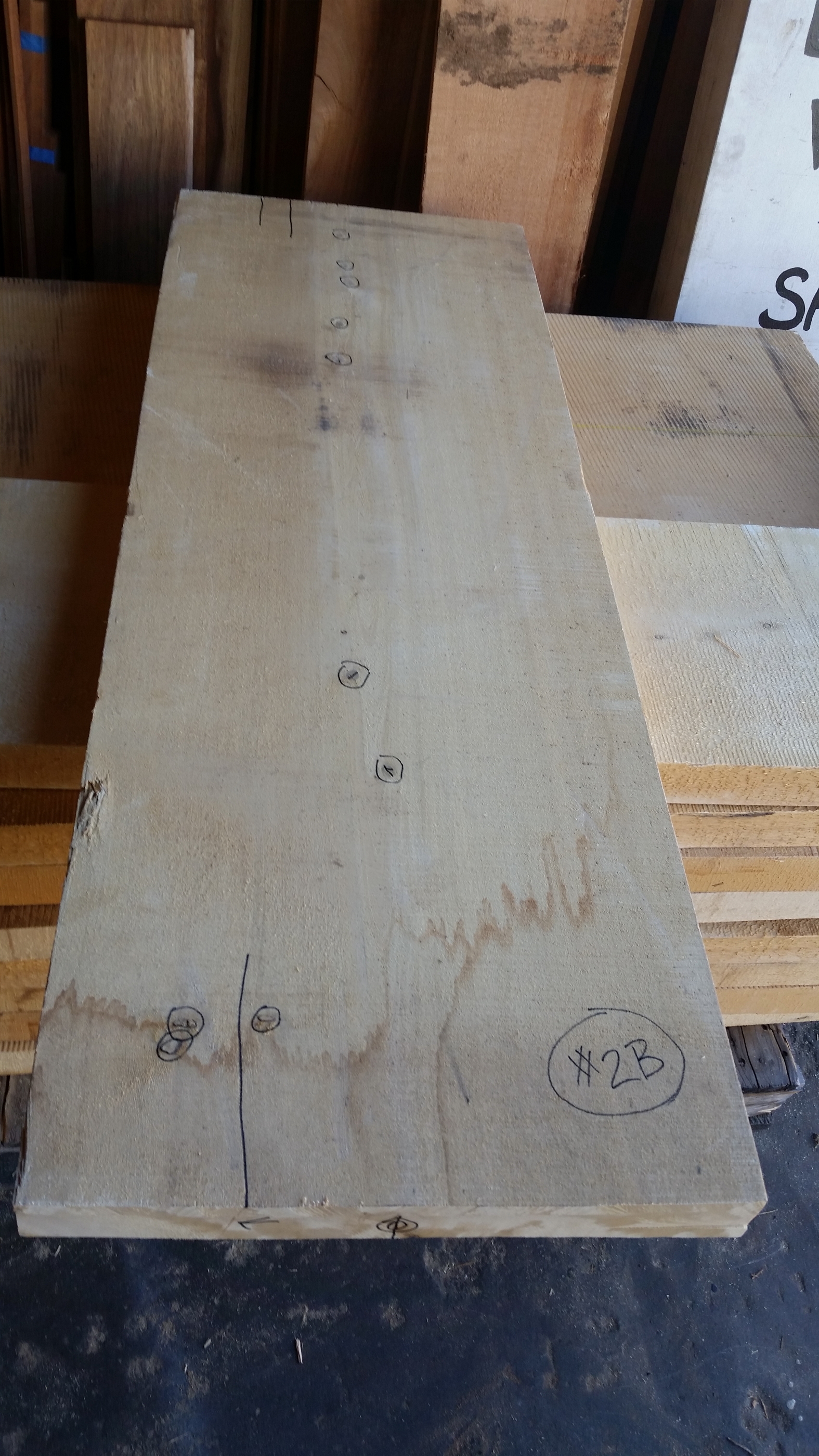

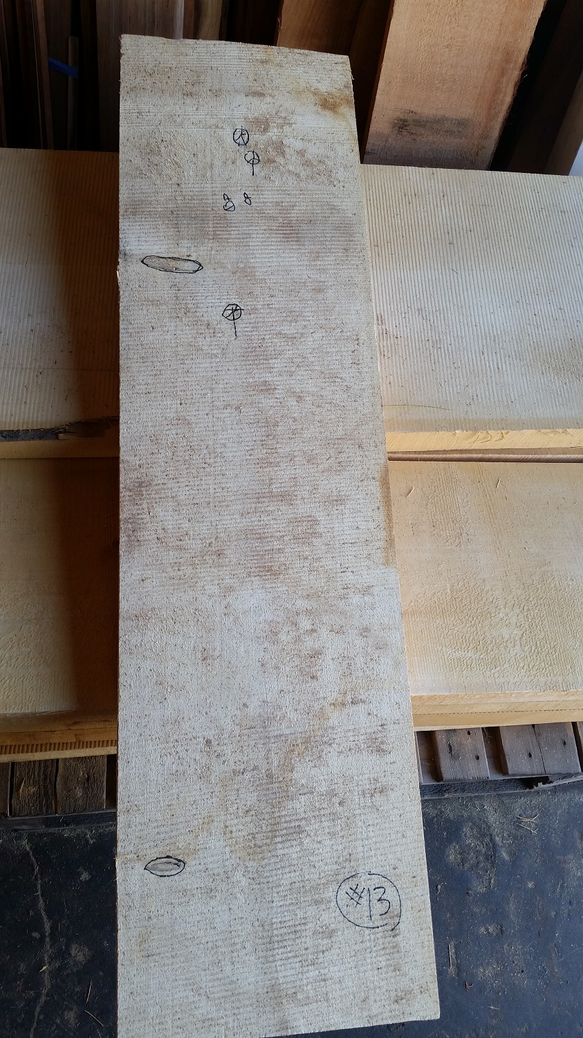

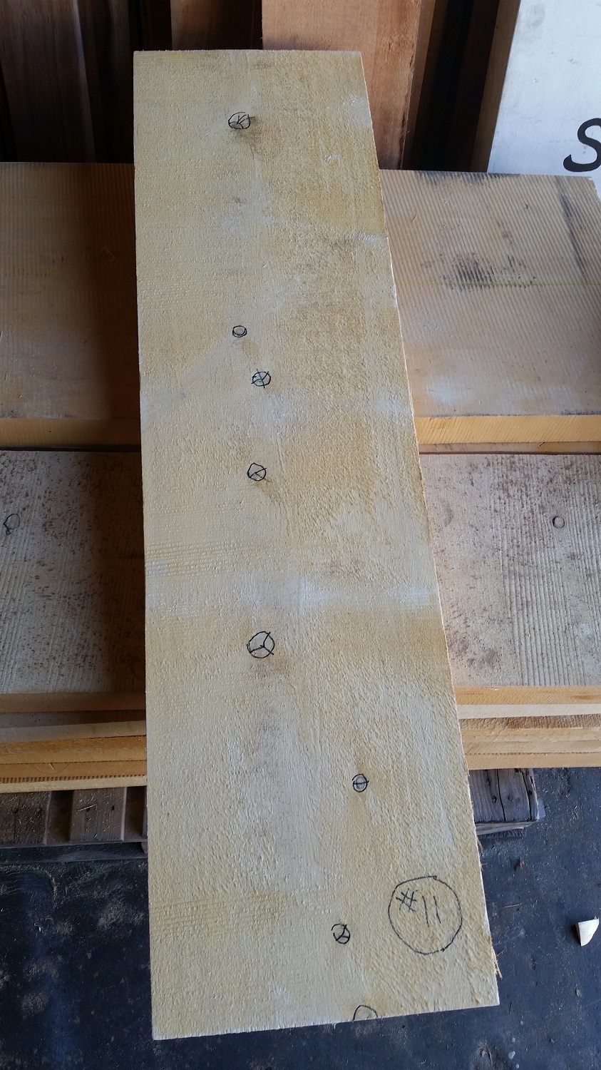

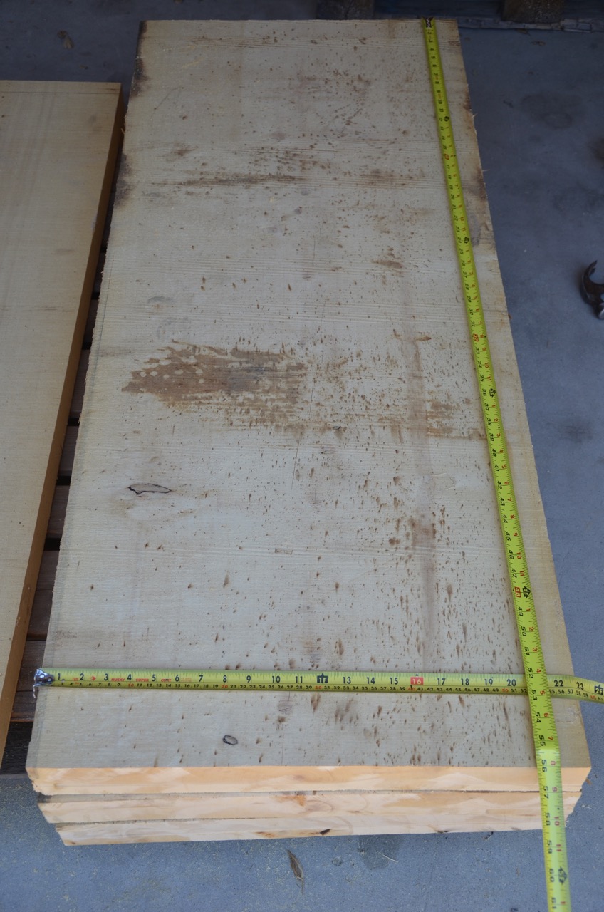

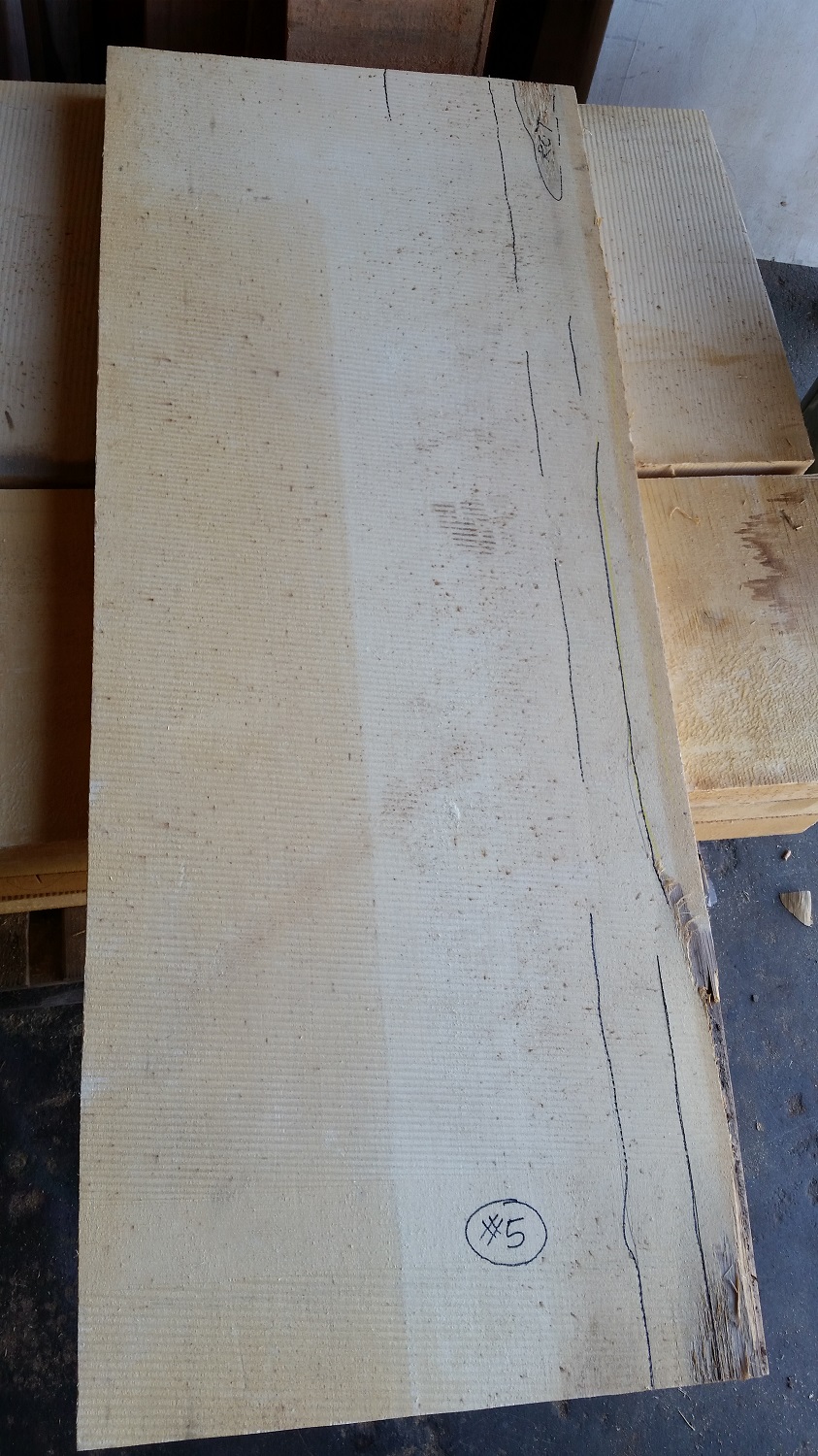

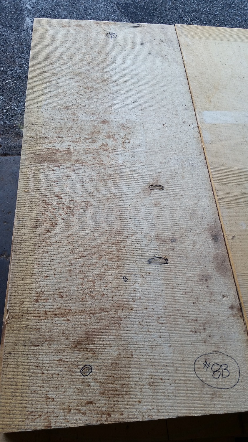

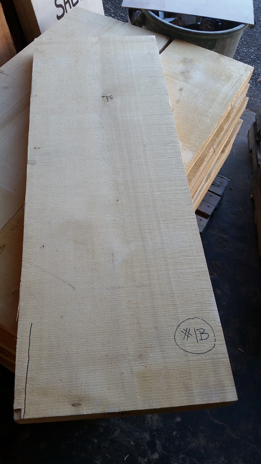

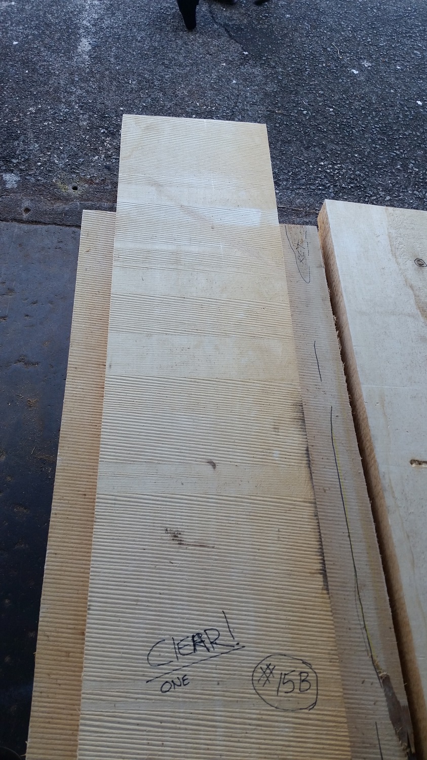

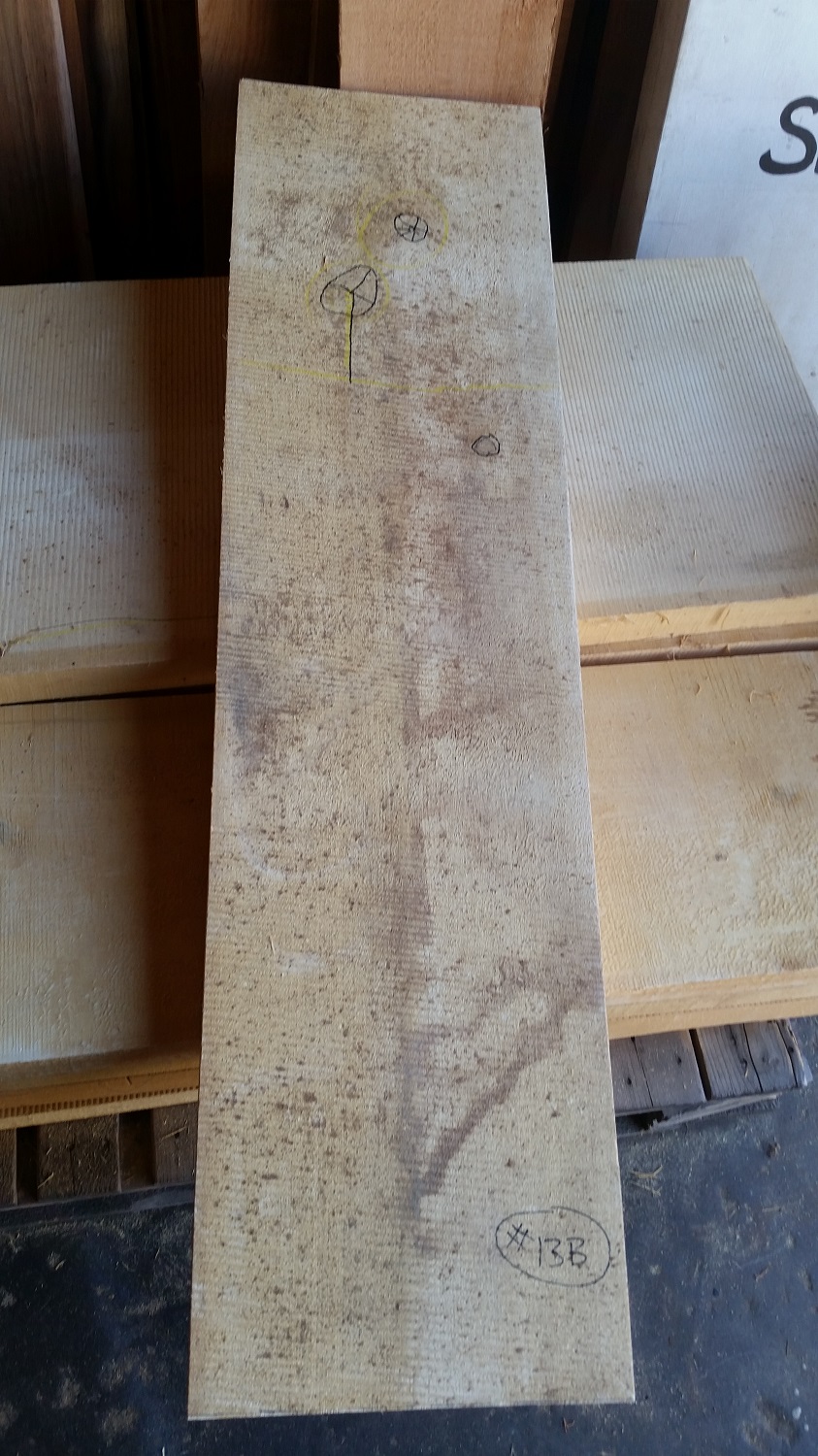

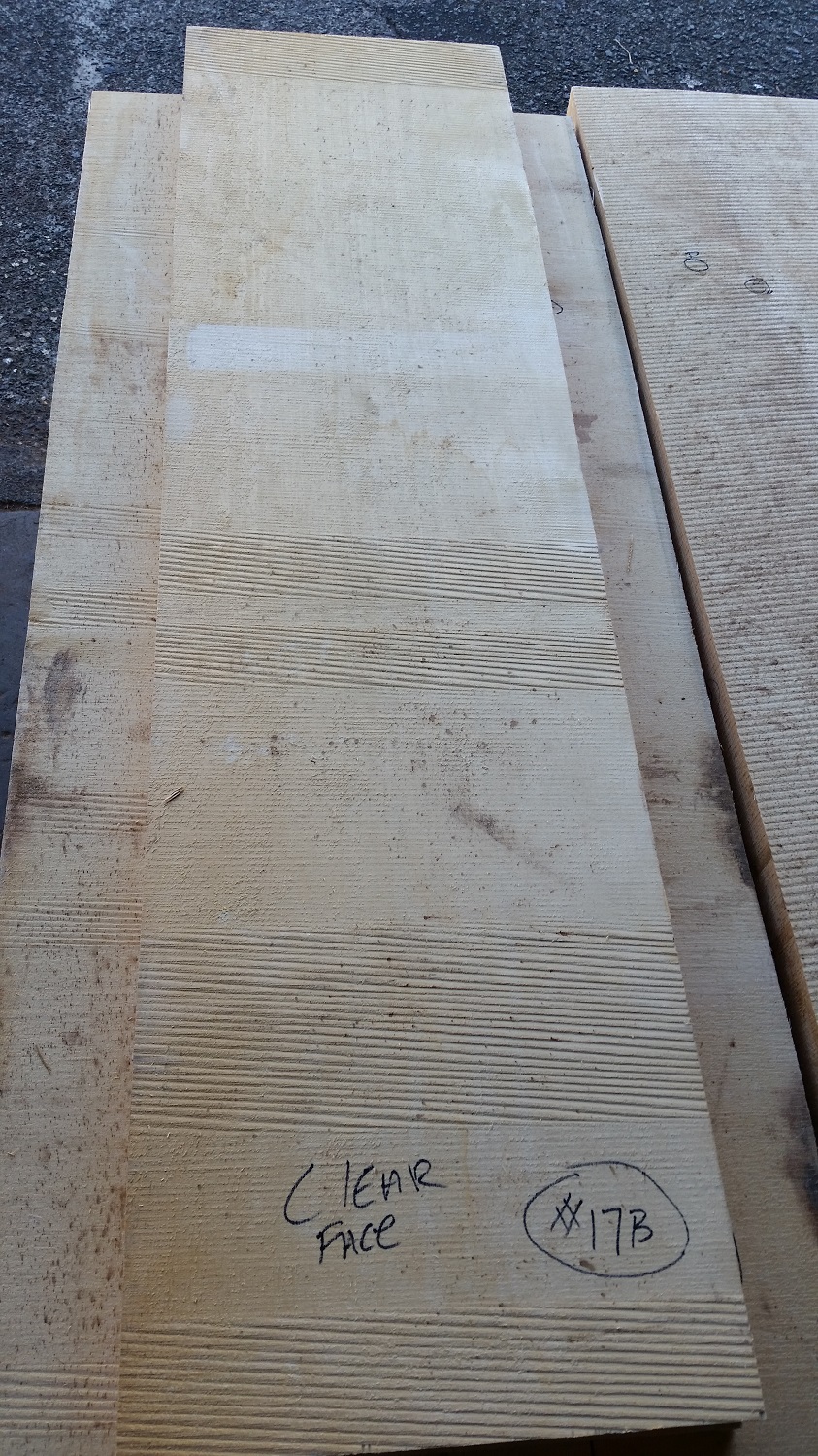

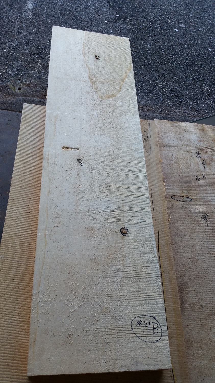

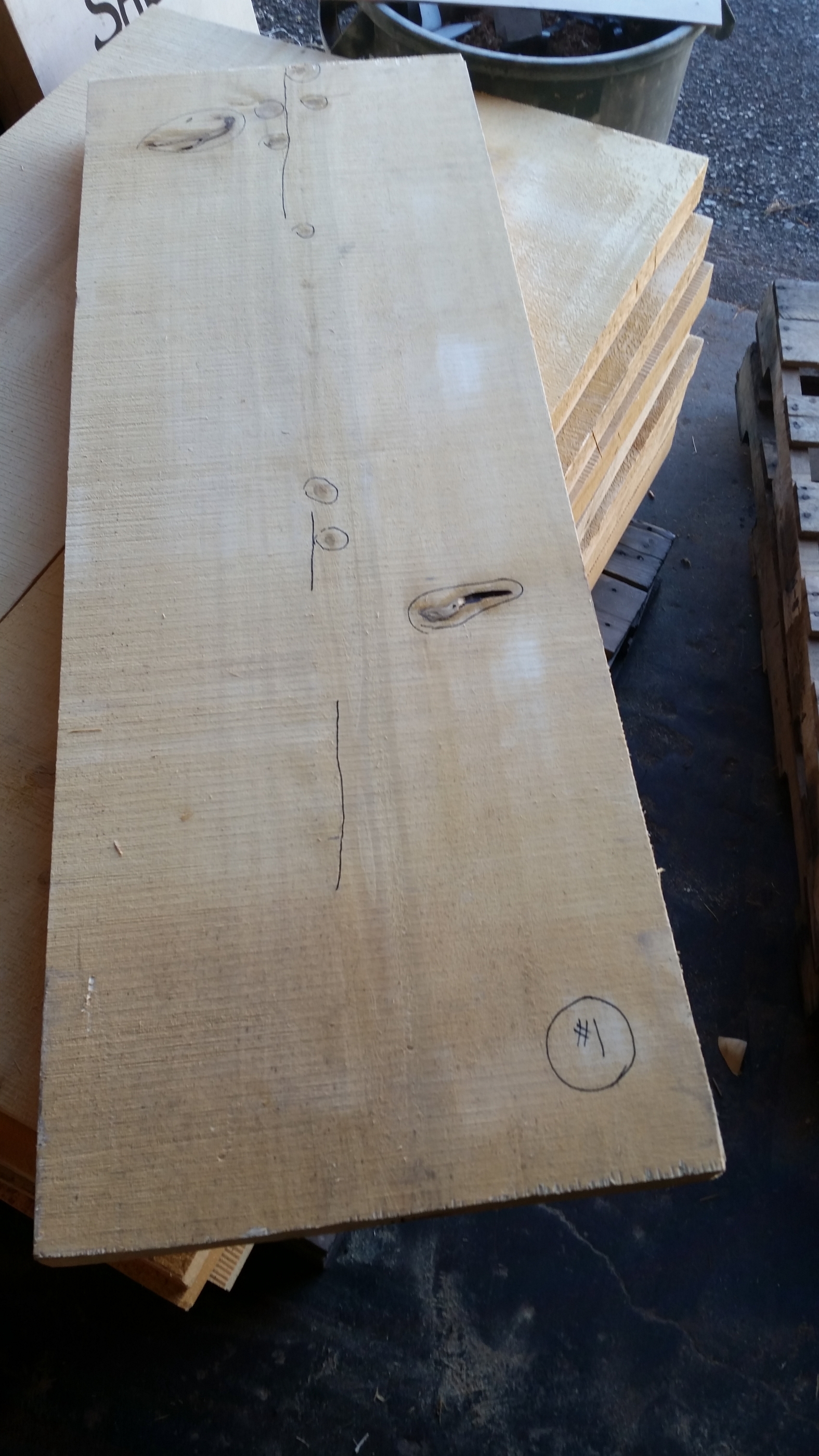

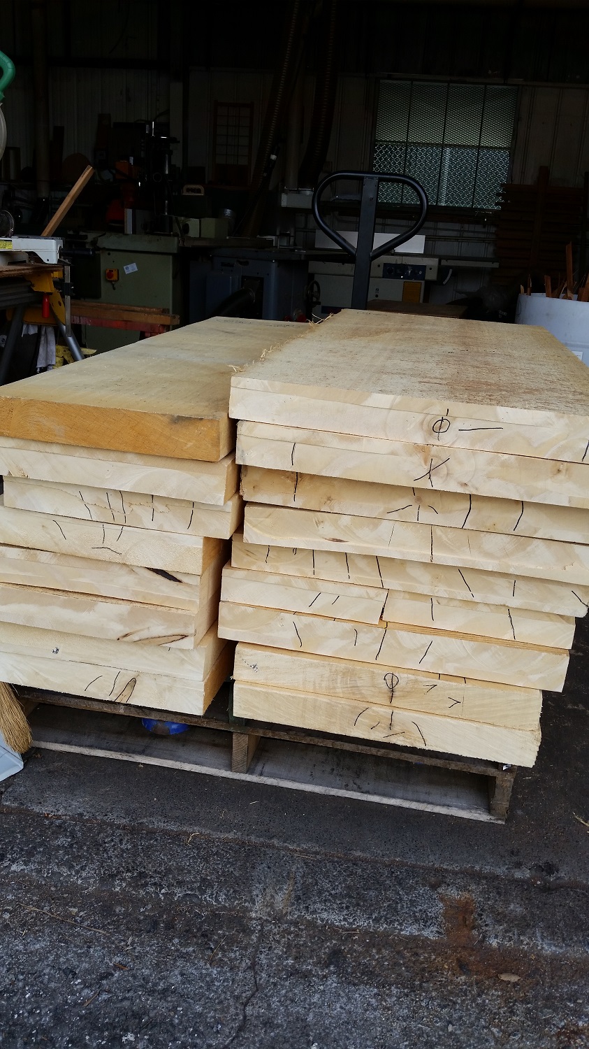

correy smith Member
Website: http://www.matsukazewoodworking.com
Yes Alaskan Yellow Cedar . Cupressus nootkatensis.

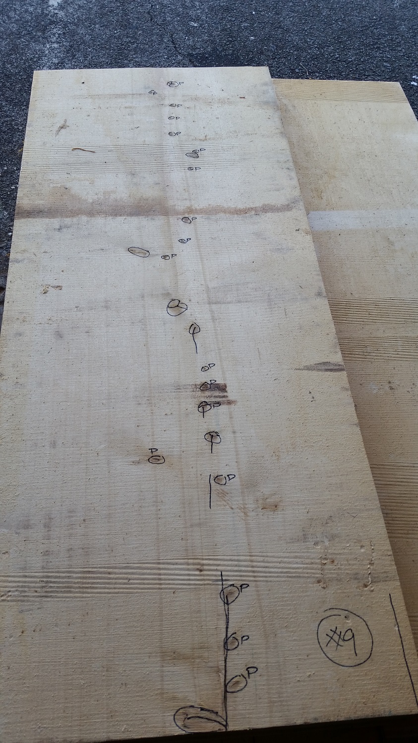

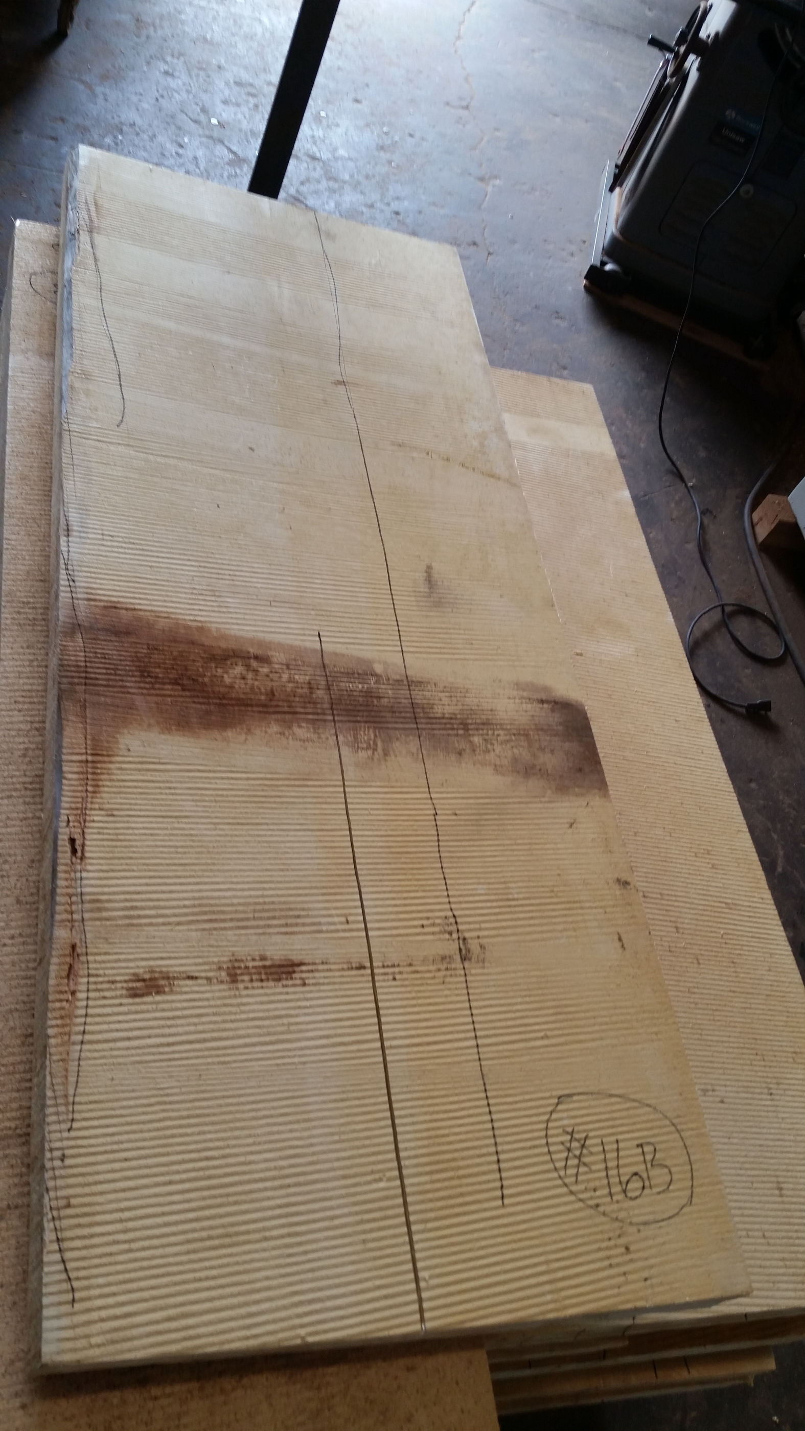

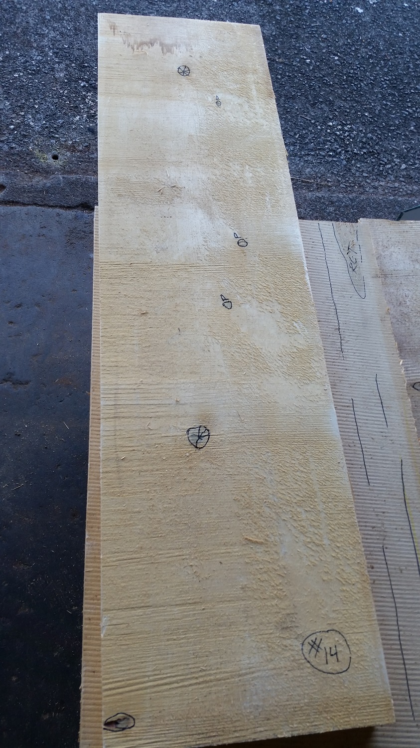

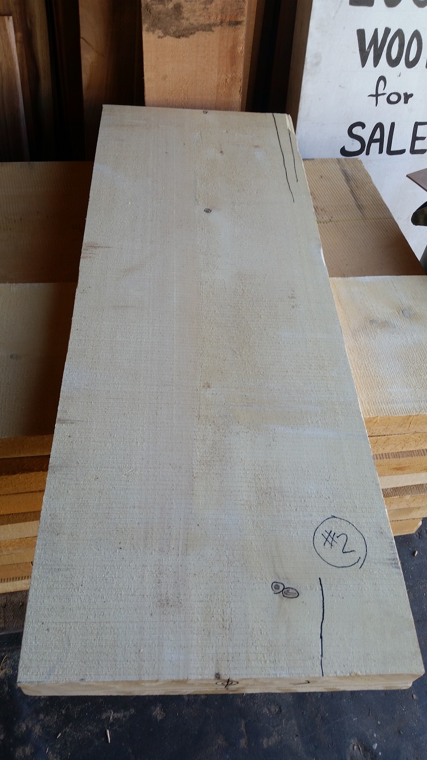

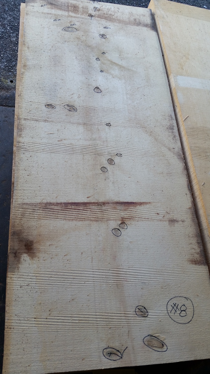

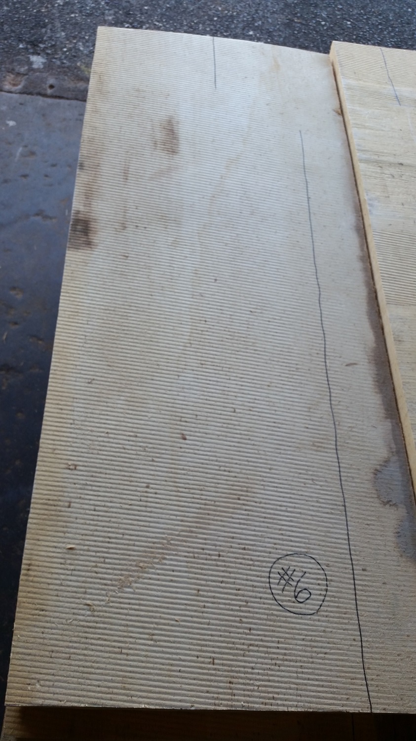

Yeah, other vendors had said c&btr was the common select appearance grade. Most described it to be essentially clear material with a few pin knots.
A&BTR one guy said was clear to near clear vertical grain.
I just received a shipment and now trying to figure out what grade I received.
I did not expect box heart and so many knots. Most are small. Some are pin. Many are medium "quarter sized", several large.
The surface checks are trouble some, deep, and plenty. They need to be cut out and glued back together.
With how much checking there is in some of the pith areas I think I would have to cut out all pith. Would pith be included in C&btr? How many knots allowed for C&btr?
End Checking/splits reduce length??
Do I look at the whole as a lower grade and bulk tally or deduct for defect and scale as A&btr??.......
When scaling in the rough are there any special rulings for which face you pick for Alaskan Yellow cedar?
Typically rough is worst face scaled?

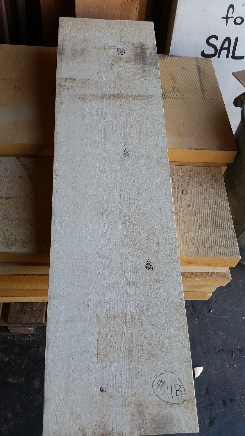

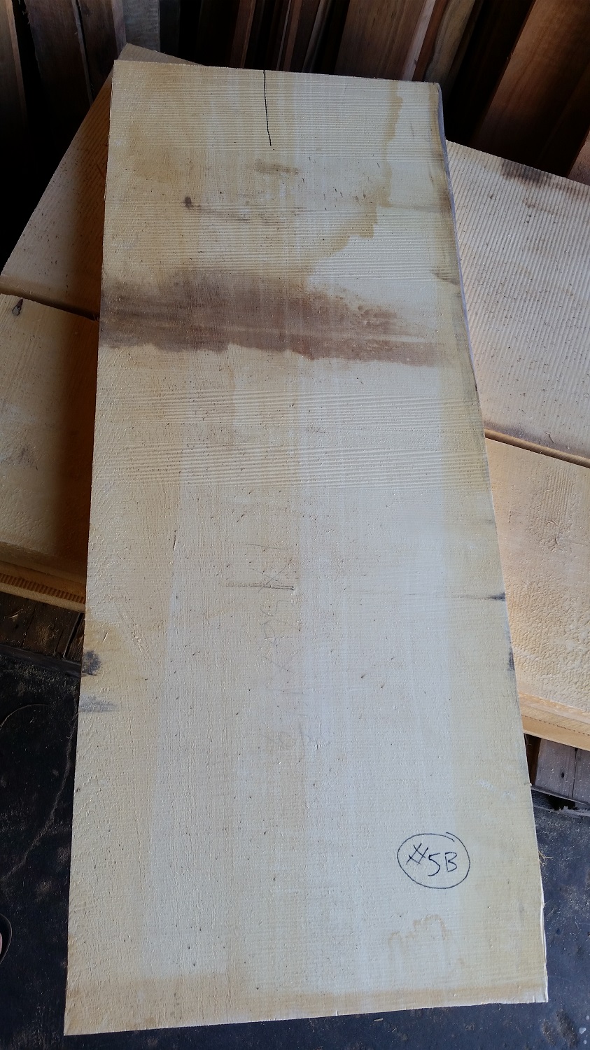

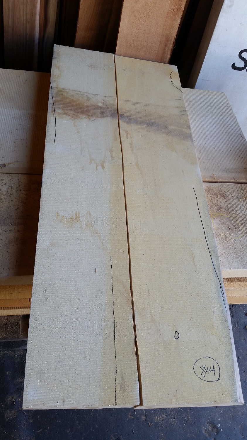

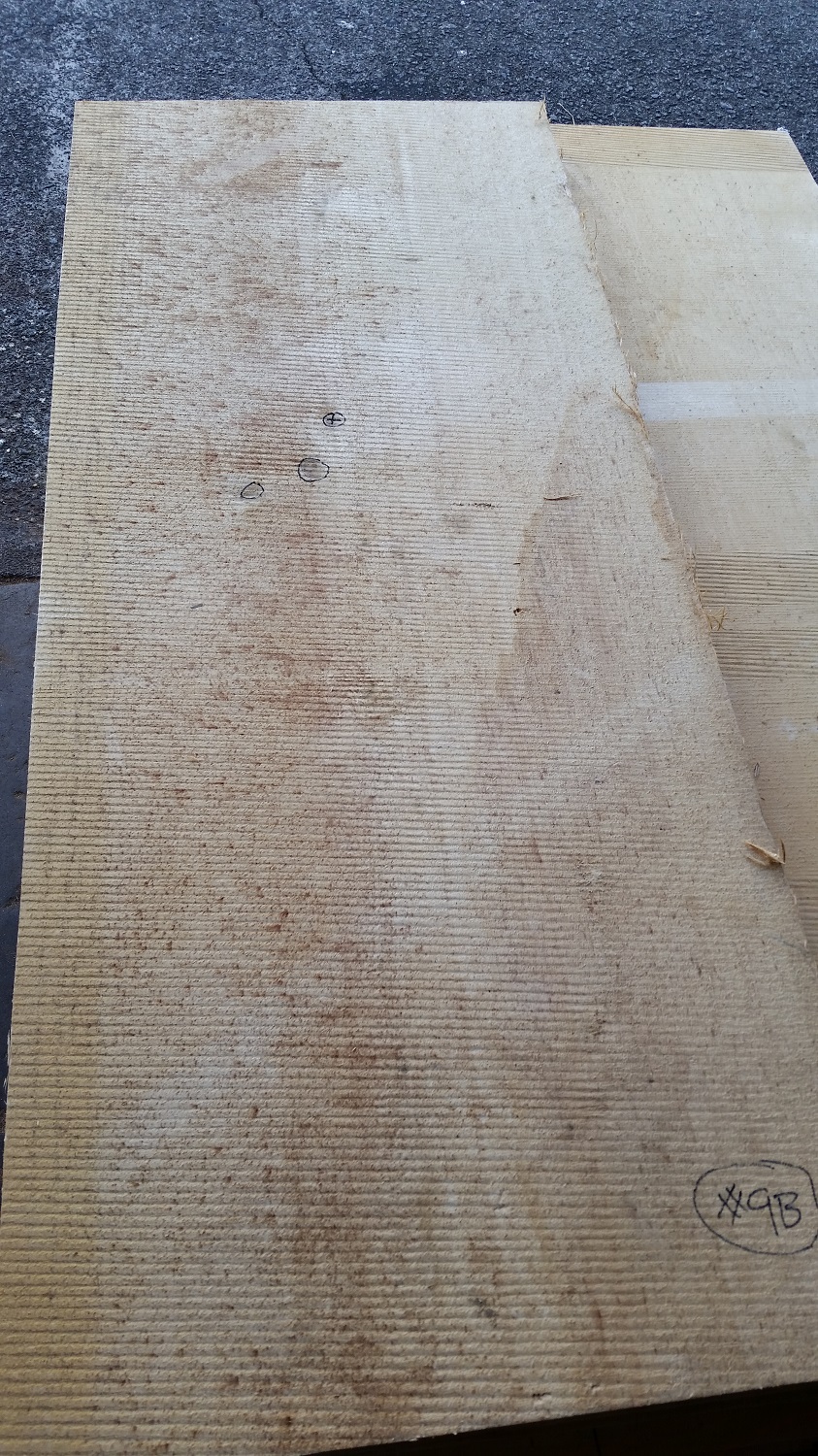

here's a few pics there were 17 boards.
I did take pics of both face.
If any one was up for it I would post them all and maybe the experts can grade it for me?
Here a sample Ill post more if anyone wants to see.
Thanks.
View higher quality, full size image (1575 X 2800)

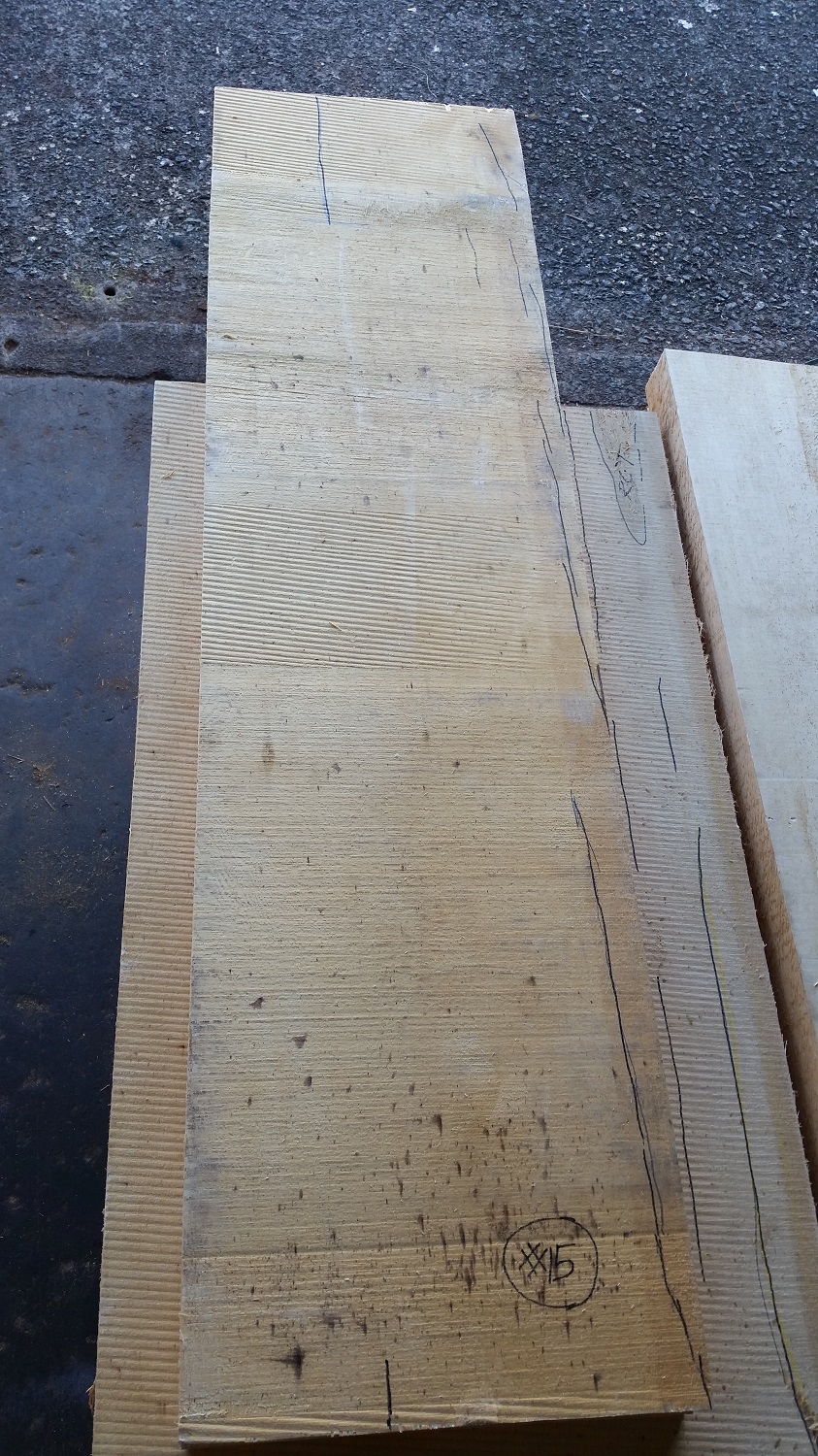

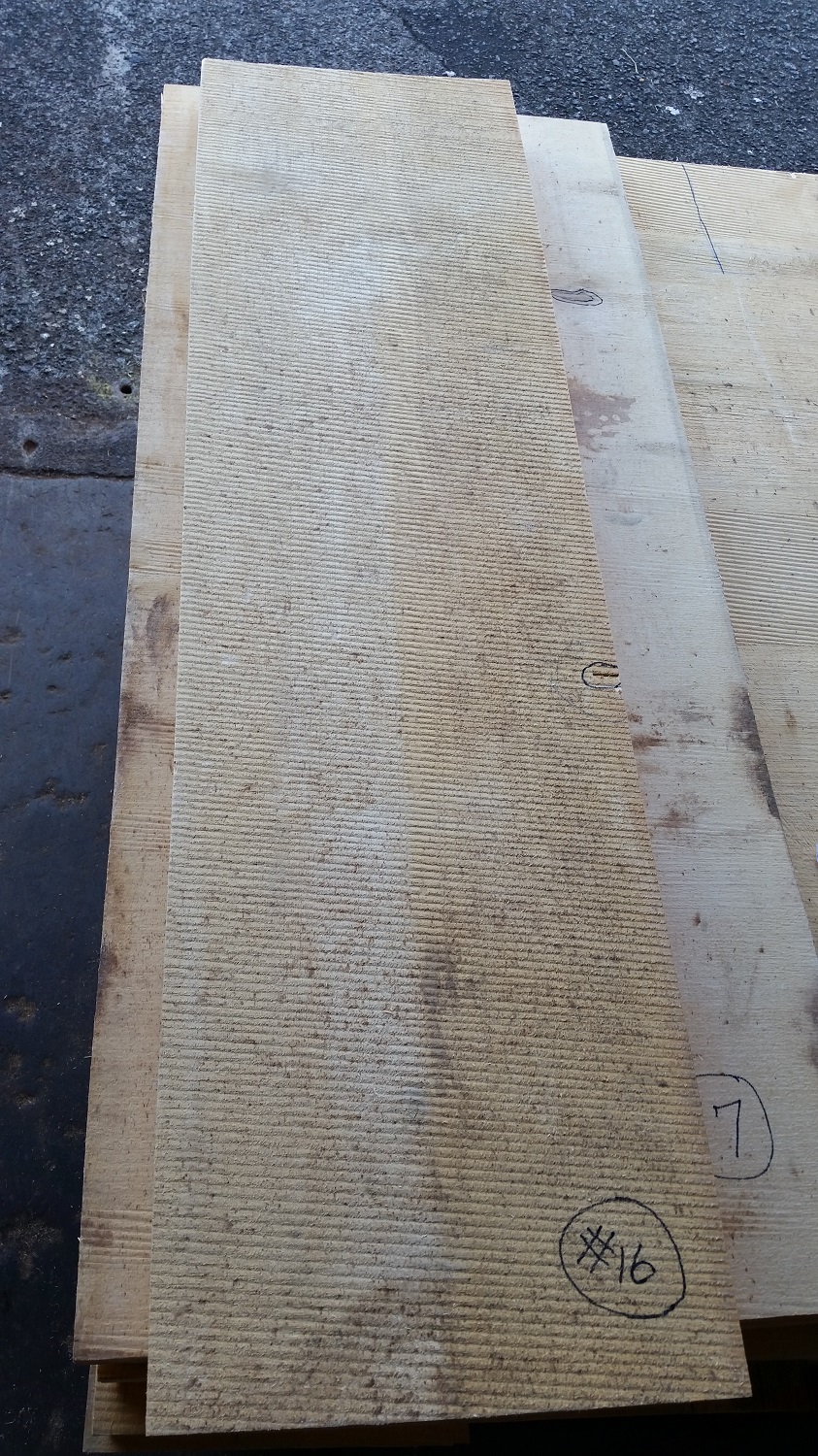

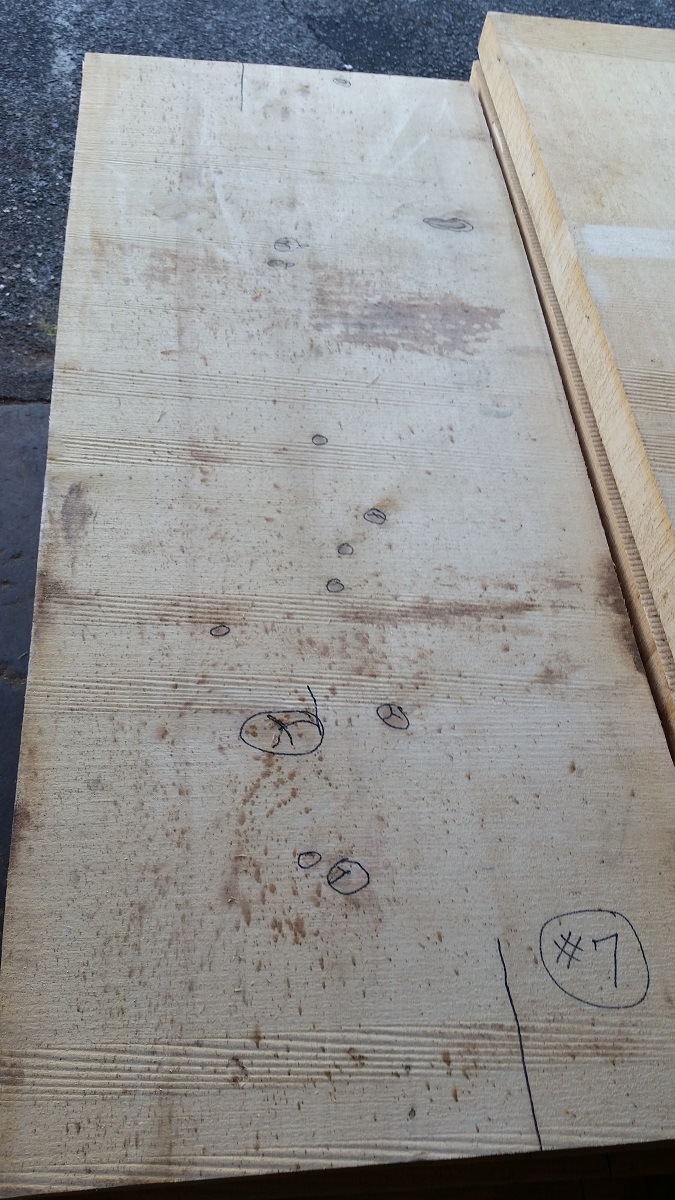

9/5/16       #7: AYC lumber grading? ...
correy smith Member

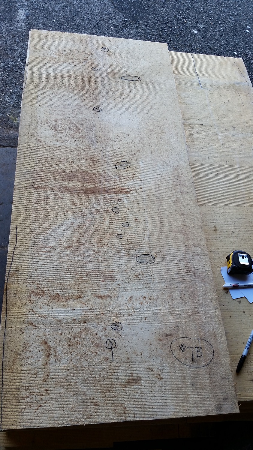

I labeled pin knots with a P
some knots were detached from the surrounding wood, some are checked so I marked the checkes on the knots.
Not that there is not plenty nice clear lumber once you cut out the defect.

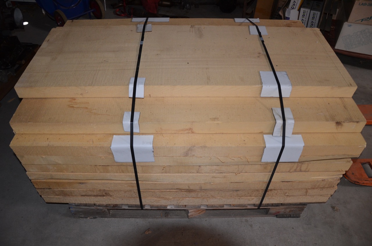

What was shown to me as sample
View higher quality, full size image (848 X 1280)
View higher quality, full size image (1280 X 848)
9/5/16       #21: AYC lumber grading? ...
correy smith Member
What would you say STK or D/C&btr? A&btr????lol
Would you still scale out checks for STK? I would.
Thanks.
