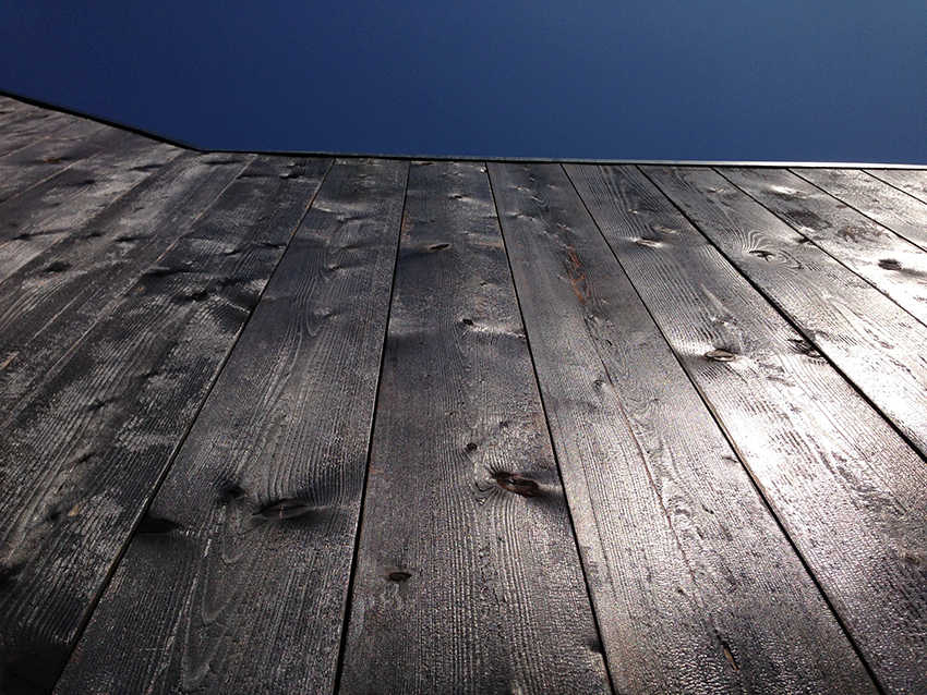

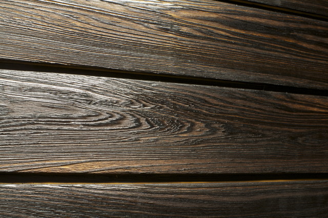

jaycee
all the info regarding Shou-sugi-ban is to lightly charr the wood then seal with oil. Iam not looking for 100 yrs of use be glad to get 5 to 10 on any exterior type wood. here are a couple of pic I pulled off the web its kinda what Iam looking to do.
View higher quality, full size image (640 X 426)
View higher quality, full size image (850 X 638)
