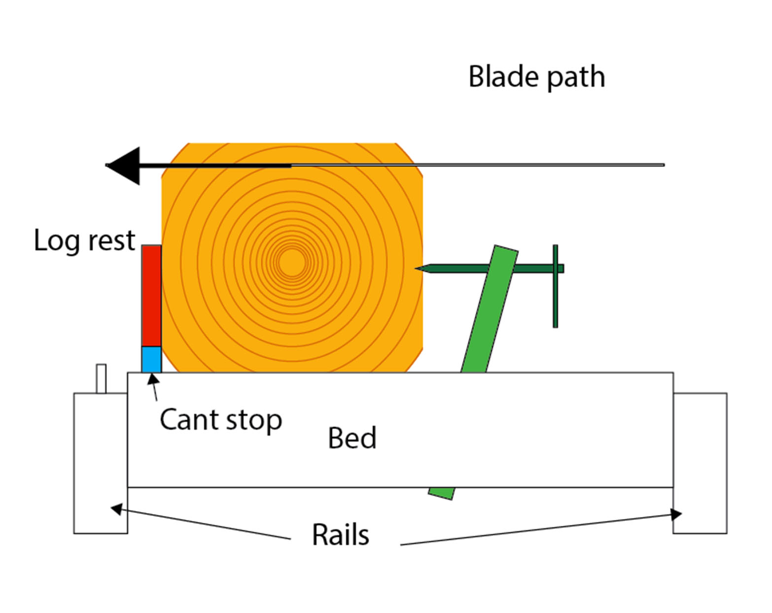

In Fig 1, there is no doubt, the log dogs are needed:

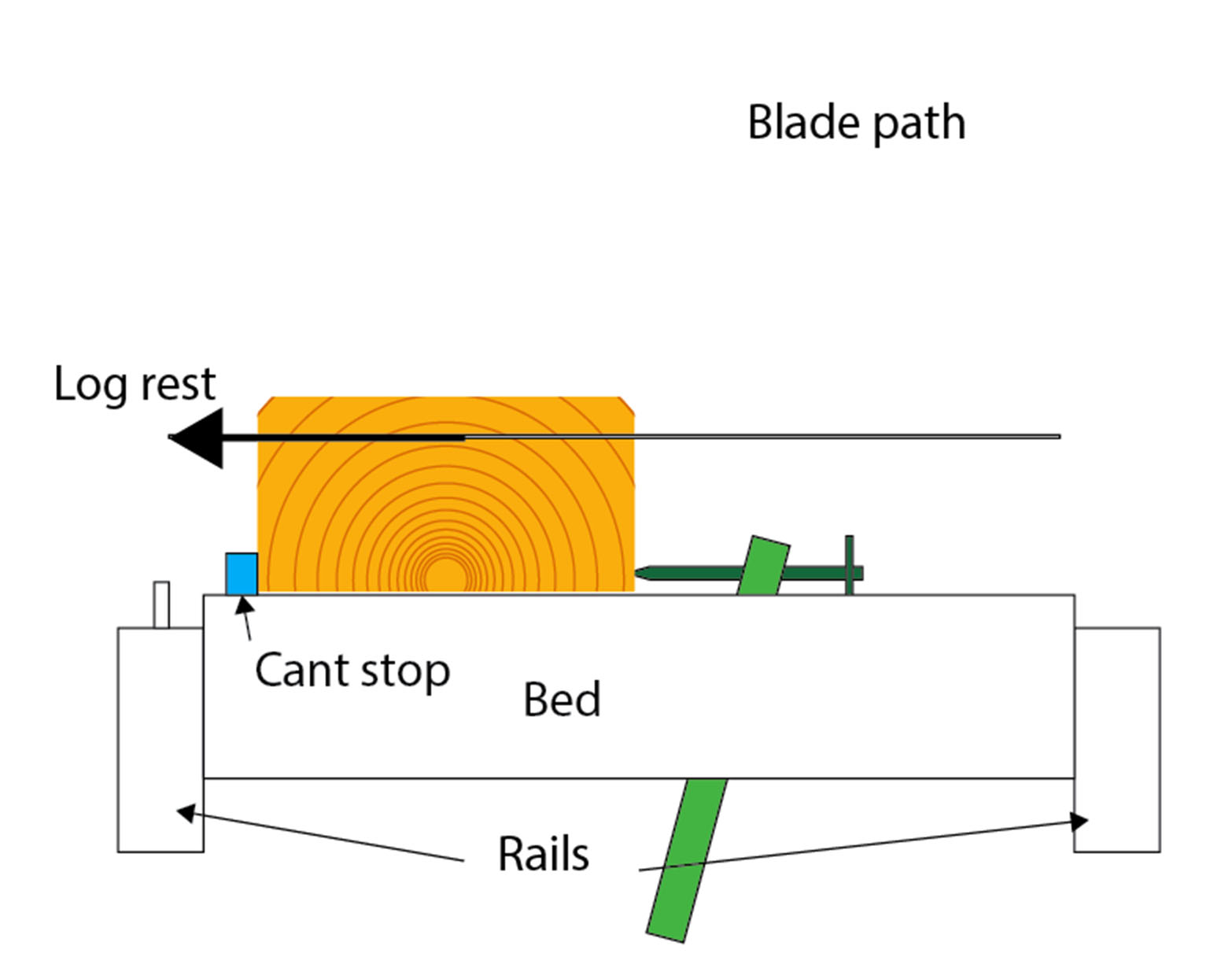

In the Fig with the cant, I also suspect they are needed:

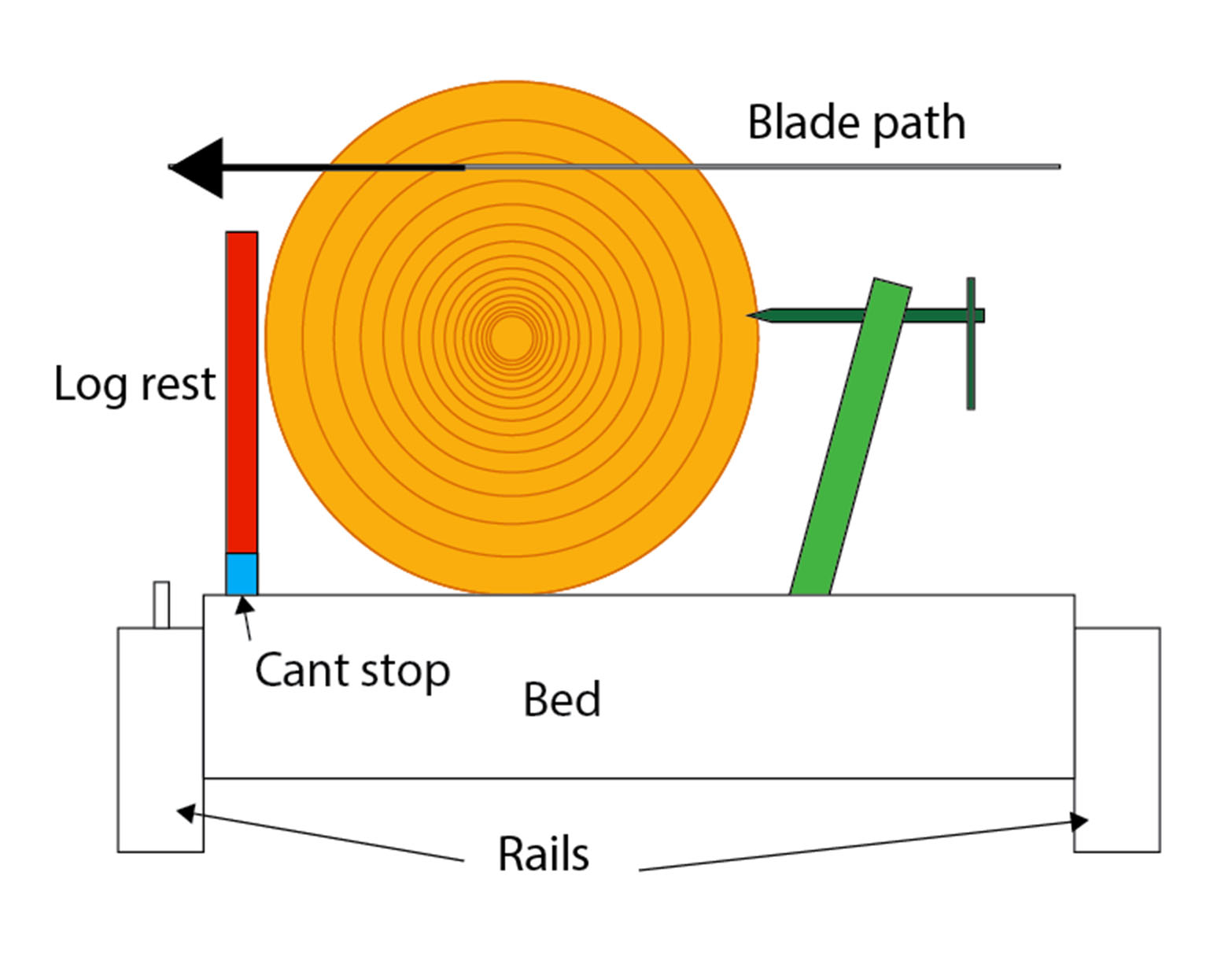

It is really in the 3rd Fig, that I worry. The force applied by the blade has the same horizontal component, but the vertical component is less.

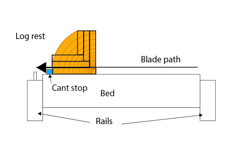

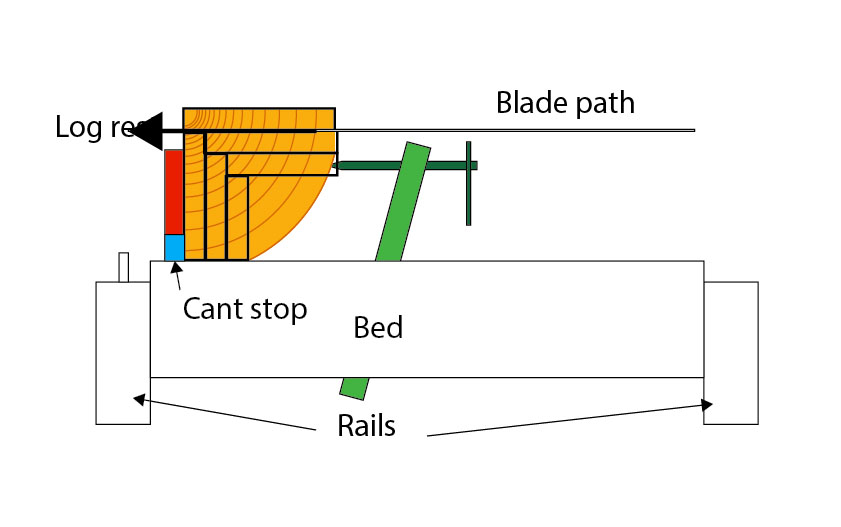

More clarifications for the second question. Yes I saw the video that Dave showed (the Norwood guy).But he balances the 1/4 log on a thin edge and has to make sure the top surface is horizontal. To me that looks like a lot of complications (Fig 1).
I had done what is on Fig 2: cut the lower board of the 1/4 log, then remove that board, turn the left over 90 degree and again cut the lower board.. and so on until the left over becomes firewood.

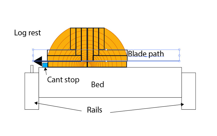

I was wondering about putting two 1/4 side by side as in Fig 3. then doing the board removal, left over flipping and so one. Of course, the log rest is hard to place in this condition... that was what prompted my first question....

Philippe, nice drawings! It really helps picture what you are trying to do. As far as the cant goes (top set of illustrations), as long as the blade is pulling the cant against the stops, you are probably ok, because of the weight. When you get down to the last couple of cuts, you don't have the weight, and the cant is more likely to flip up. A good test is to try to turn the cant with a cant hook. As long as it resists turning and the log stops are up against the flat side so it can't slide over them, you are probably ok.
I don't see a problem with quarter sawing the cants 2-up, as in your last illustration, especially with the weight of the wood on top-- but again, the last 3 or 4 cuts will need clamps.
