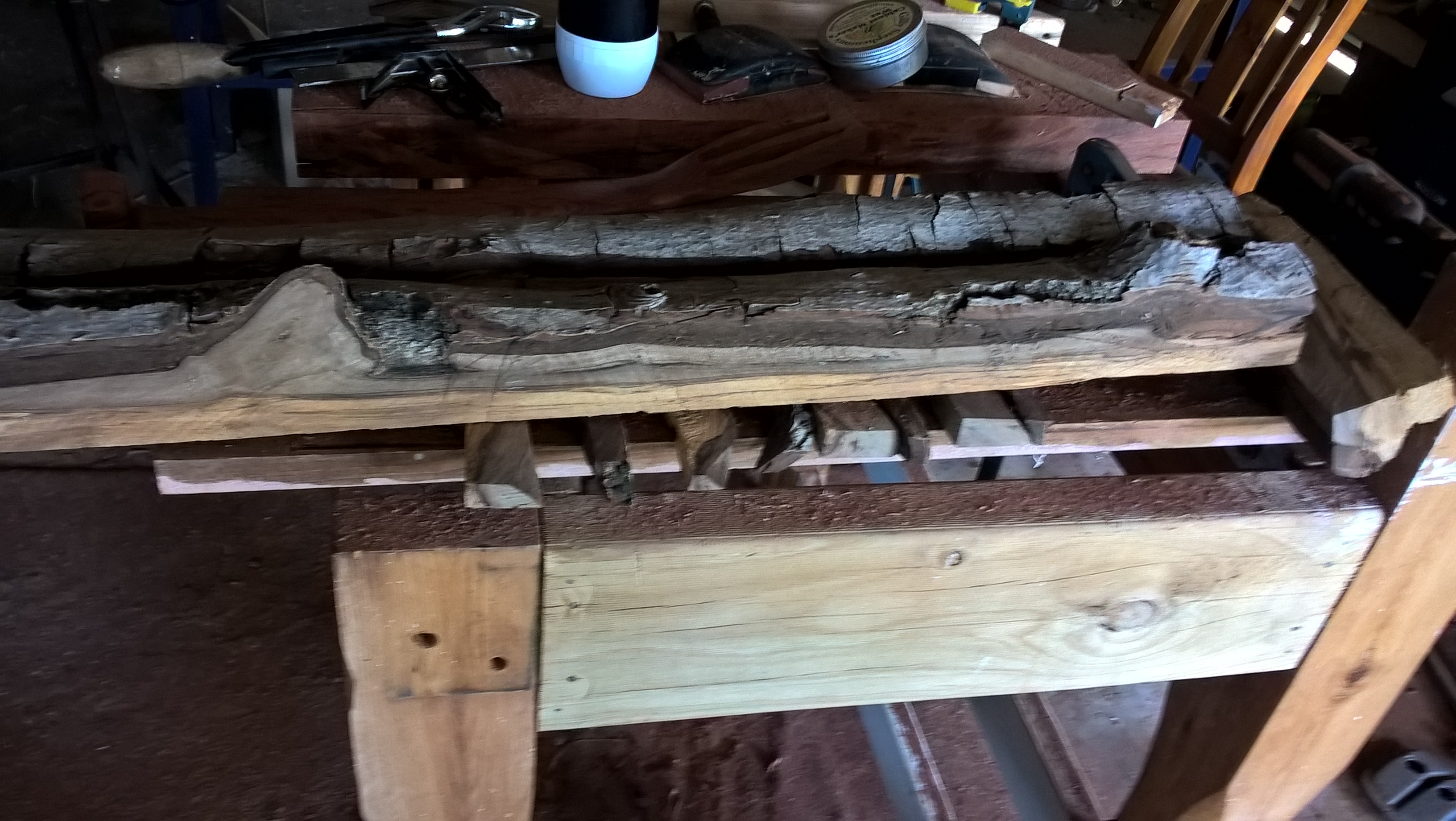

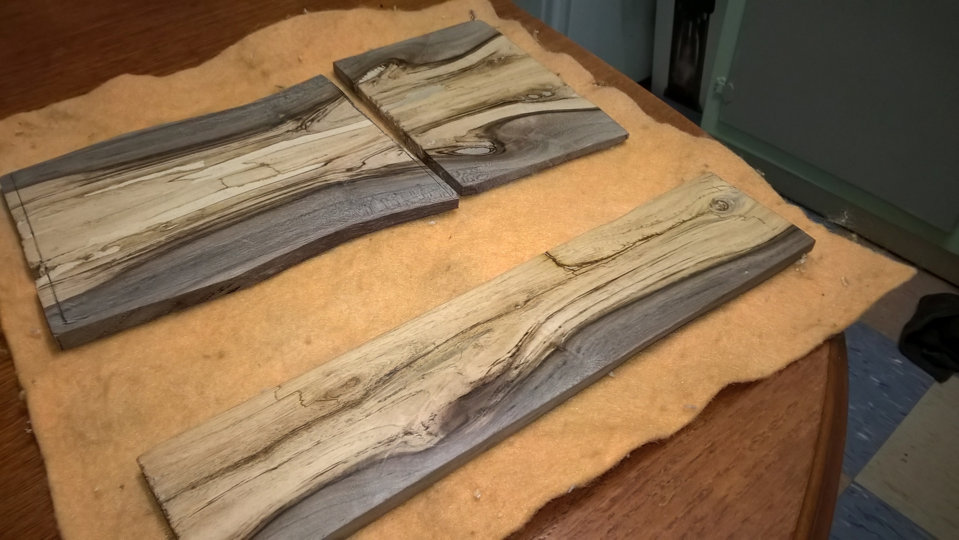

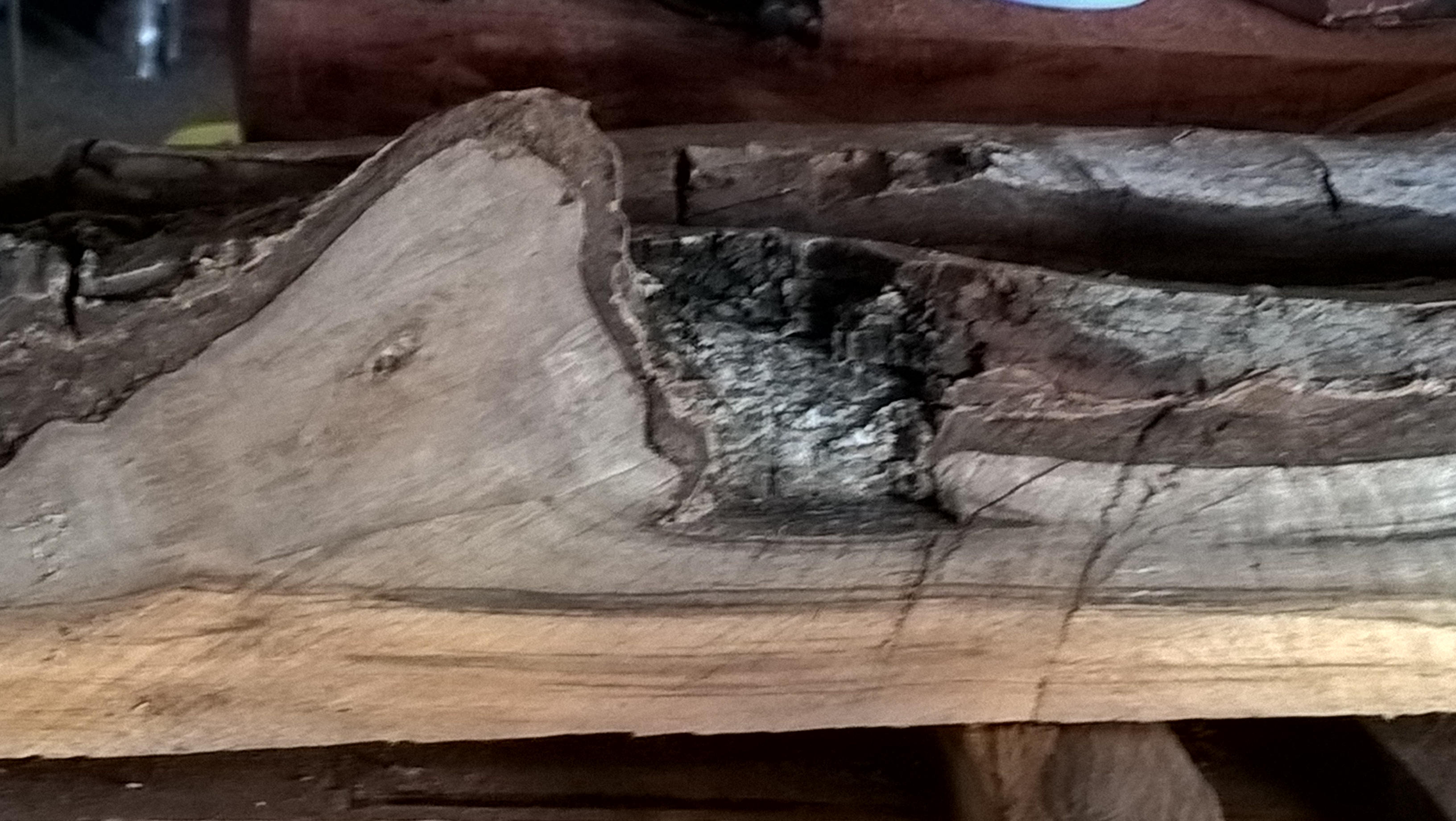

This limb I have cut into out of a walnut tree in my yard ,I assume is butternut, I can't find a description of wood that matches it the heartwood is soft like balsa but the sap wood is really hard and dark. Is this common?

That is some very attractive firewood you have there.

Firewood????? LOL!!! People pay premium for spalting like that!!!
Butternut I'm not sure of BUT the light soft wood is due to the heart is in the 3rd stage of spalting....which is beginning of rot. With the pics it appears the tree was dying from center out (how most hollow trees start). You actually caught it at the correct stage and able to get a few beautiful boards. I let woo/logs lay around for years to achieve what you accidently gained. The dark wood does appear to be walnut/ butternut. BEAUTIFUL!!!!

Hold on, are you joking? Can't tell from the way you type. But you are asking if you can get butternut out of a walnut tree? It's rotten in the center of a walnut branch, that's all. Hope I'm just not playing along with the joke, or even worse, now I will be the joke.

I guess the joke is on you since you spoke it. Yes butternut is a form of walnut...some call it light walnut. I've seen dk walnut be light in color and one of the butternuts I sawed was a darker color and if I hadn't cut the tree standing seeing he bark and tree as a whole I would've guessed it as walnut. I'm sure the trained eye that handles it everyday can see the difference immediately as with pecan and hickory are usually graded together also chestnut oak and white oak...they look similar but have nothing in common in rot resistance (chestnut oak is open cell).
Rot....your correct....that's what true spalt is at 3rd stage....the black lines are a battle of ??? and ??? in the second stage.... the late end of third stage (if allowed to go that far) is rot of none usable. Spalting is stopped at which ever stage it's at once dry and won't go any further.
I hope that info helps you.

When wood is first harvested, the sapwood contains many sugars. These sugars are attractive to various fungi, that are grey or blue in color. The heartwood does not have food for them so they avoid the heartwood. These fungi invade the wood in a few days to weeks.
However, other fungi do like the heartwood as these fungi are eating the basic components of wood...the lignin, which is the stiffener and glue that holds the cells together. These fungi prefer dead trees and take months to develop, so during that time, the sapwood is drying and Getting "hard" while the heartwood is beginning to soften and is still quite wet.

This piece is just part of a branch that fell off in a storm I have more of it that would be larger and better quality, the worm holes and rot could probably be similar to knotty pine in cases where I have glued the two pieces together the centre third where white is also hard and free from decay so two thirds of the other wood I have is good either way, But why is the sapwood so hard is this normal other wood has soft weaker sap wood this is the reason I can't find a description to identify it properly .
The pieces I have I am going to cut two pieces into the ends of the board so the sapwood is a frame and the soft heart wood will be carved to hold rings in place ,maybe a little flocking.

The heartwood is soft due to decay. The sapwood appears hard because it is dry. Further, we do know that not all basswood is soft. A wood carver can tell you, from experience, that some basswood is quite hard and difficult to cut. So, not all basswood is the same.

We have had a change in weather here in Australia and the other small boards I have cut seem to have adjusted an the difference between the sap wood and heart wood seems to have evened out there is less rot in these boards it's a really nice texture ,although the sap wood does still seem harder than the heart wood o have assumed it is just from the spalting then I wonder if the dense woods I have would have done the same for eg. The gidgee lengths I have which have a white layer of sapwood over the dark marbled and ringed heartwood which is incredible hard the sap wood would then become harder then the wood is ATM it could be nearly then considered stone. I would love to cut some of this.
