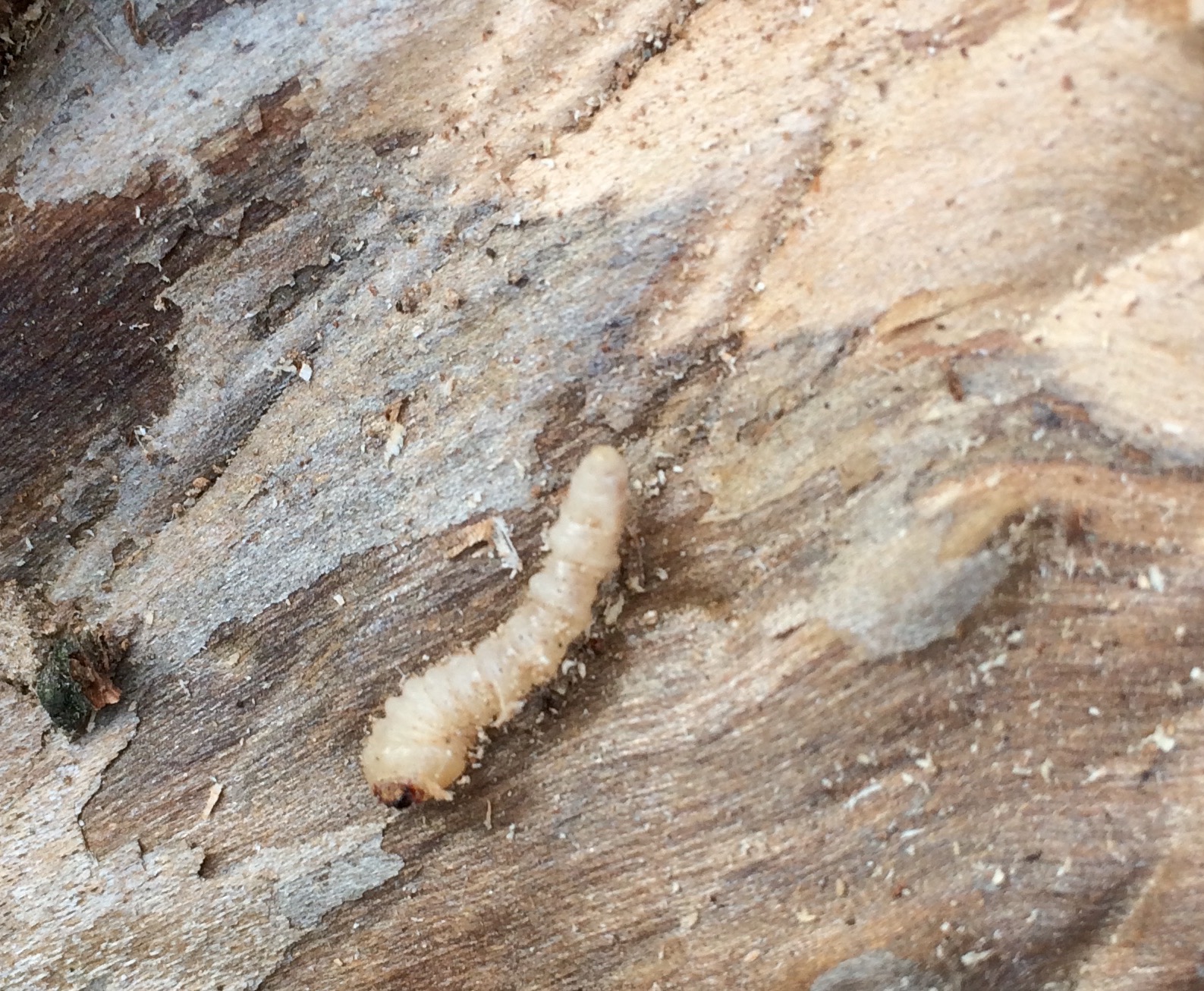

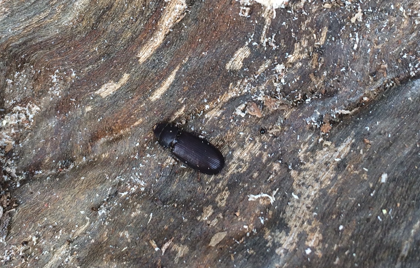

So I thought that the wildlife in wood would die off at 130 degrees in the kiln. Today I found these two bugs slide under the bark of a junk of wood which was in the solar kiln for 5 weeks and the temperature in the kiln went up to 140 minimally, but the bugs survived

Note that the grub shown in your picture needs moisture to be active, so the wood was still fairly wet. They cannot damage or eat dry wood.
The second picture is one of the anobiid beetles, and they like wetter wood also.

Gene, that is the part that surprised me, both the beetle and the grub where directly under about 1/2 inch of bark and I would thought that the heat would have penetrated that deep, but apearantly not for long enough. It sure seems like the little buggers are tougher that I thought.
