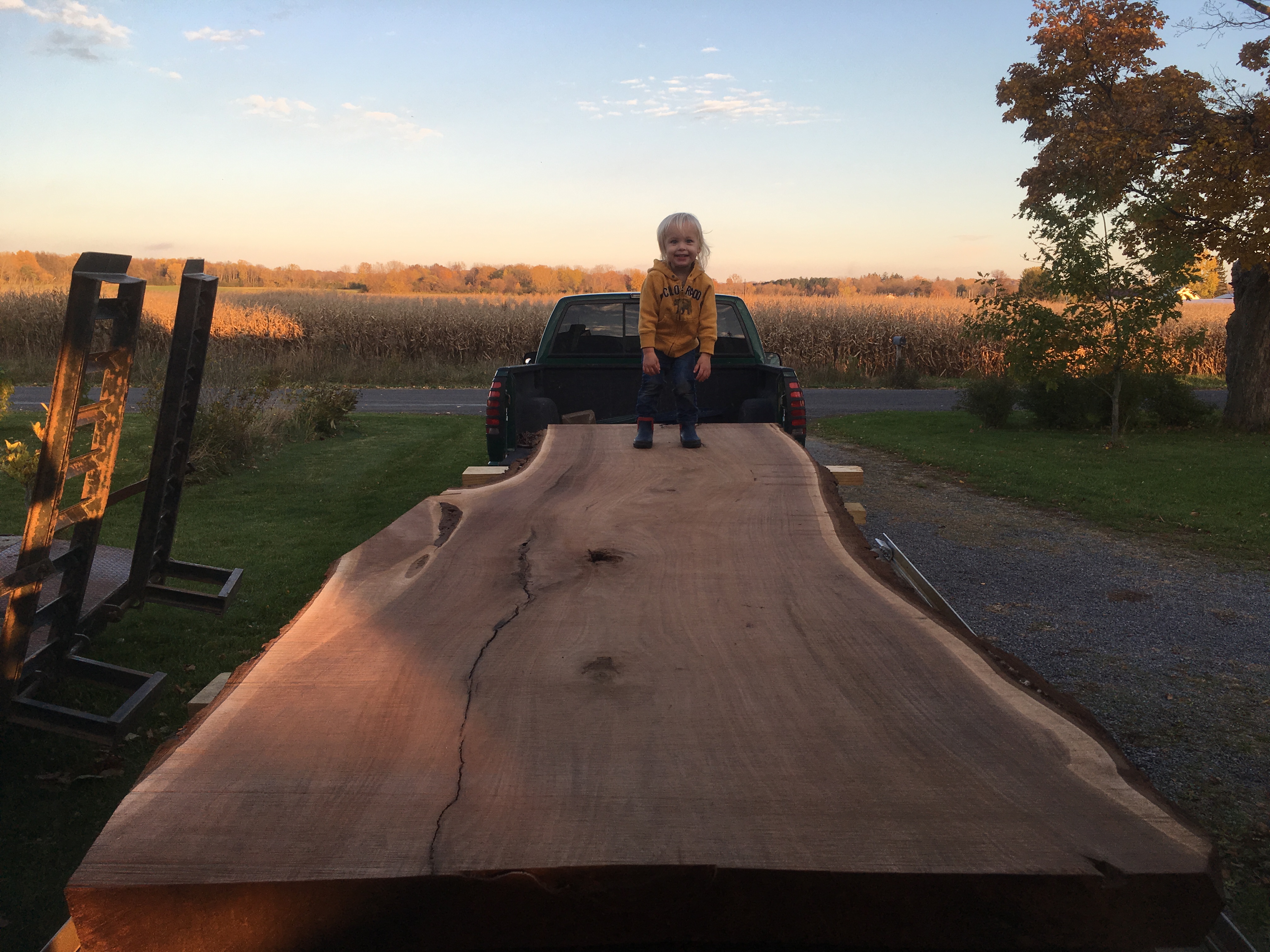

Hello,
I'm a new member here, though I've been to the site many times. I have just had a friend saw up a massive walnut tree into thick slabs for me. The slabs are mostly 3 1/2" thick, 3' to 4' wide, and 10'-6" long. I have put two coats of anchor seal on the ends and plan to coat the few knots that are on the sawn faces. I will air dry them in a barn with plenty of air circulation and hope to build some nice tables with these in a few years (or more 😕) The bark seems like it will come off easy now while it is still wet. I think the bark would be much more difficult to remove after the slabs have dried. I'd like to keep the sapwood as white as possible and reduce the chance of mildew growing and bugs boring into it.
Do I risk checking on the live edges if I remove the bark now? Would I be wise to leave the bark on while they dry? Any suggestions or tips would be appreciated! Thanks.

Sounds like you have things under control. Your wet and dry seasons are the opposite of what we have in Western Oregon, so early rapid drying this winter may be an issue. The problem with looking for signs of the wood drying too fast is that if you can see any, it is too late to correct. Besides end checking from rapid drying, the wood will develop what is known as honeycomb. This happens when the wood on the outside drys and shrinks around the wet core of the wood. At first, the wood will develop stress fractures throughout the surface of the board, but as the core begins to dry, the wood on the outside will relax and the cracks will close back up. So, you usually will not see any obvious problems with the wood until you cut into it and see all of the stress fractures throughout. White oak is particularly susceptible to this type of drying defect, but walnut and any other hardwood that drys too rapidly will honeycomb.
Note that the outside of the top slab in the stack will be exposed to dryer air than the rest of the slabs which will result in more drying defects on the outer slab's face. So, if you can place the best slabs lower in the stack and either a lower grade slab as the top piece, or some green boards set on stickers to cover the top slab. Also, the center slab which contains the core of the log will be prone to cracking along the very center of the core. This is because the cells of the first few year's of the tree's growth are made up of cells that are different than the cells of the tree at older ages. This juvenile wood has a greater radial and tangential shrinkage rate than the adjacent wood cells which causes the two tissues (wood) to tear apart from each
other. There is not much that can be done about this except to avoid the core when slabbing.
One way to deal with the powder post beetles is to spray boron (farm supply store) onto the sap areas of each slab. This helps to discourage powder post activity although not always completely. The sap layer in walnut is much more susceptible to insect damage than the heartwood. Walnuts produce many toxic chemical compounds which inhibit insects, rot fungi and even other plants (juglone compounds for example). These compounds are concentrated in the heartwood and much less so in the sapwood.
Great photo! Your helper reminds me of when my daughter used to "help' with the sawing. Seems like yesterday, but it was over 20 years ago....

That's COOL set-up you got to dry in!!! I didn't have storage when I started....as a matter of fact I just filled the last one I built 28'x44'...AD ing takes up some space BUT I believe it's the BEST long term for the wood and worth it. NORMALLY (in a drought) I'm in a good area that drying is stable with good temp and RH swings that work those cells and relieves stresses very well. We didn't cut as much this year due to being Blessed in my construction business so I didn't risk as much drying to fast.
I agree with Mark...great lil helper!!! Be safe!! Thanks for the pics!!!
