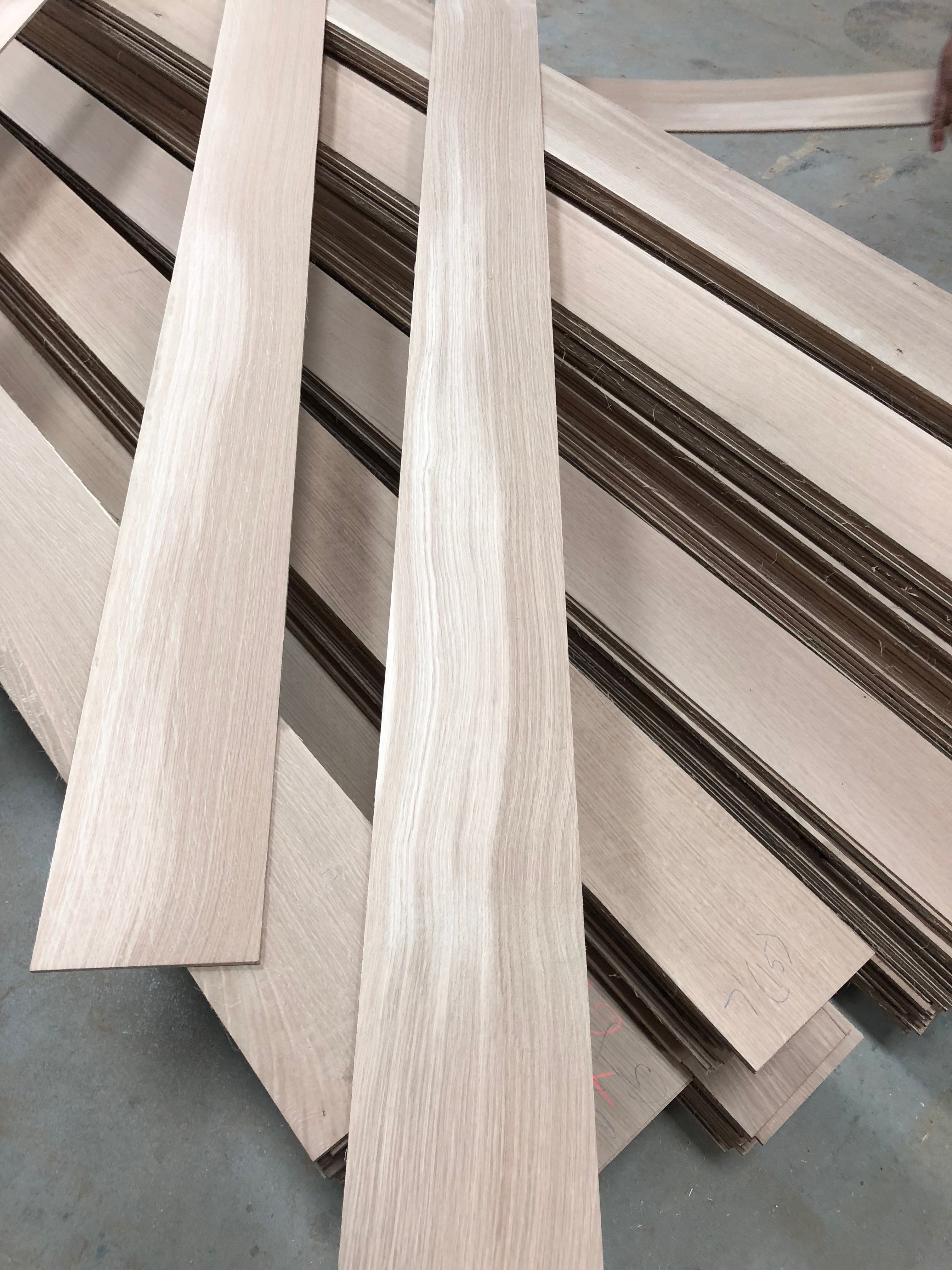

We have been re sawing some 6/4 and 8/4 select KD rift white oak and we are seeing
a discoloration in the lumber. The discoloration is all inside the lumber and not visible on the outside. It kind of looks like sap wood but its not. We have asked our lumber supplier about the defect and were told that they sell a lot of the same wood and no one complains. They also said it may be a defect caused by temps being too hot in the kiln. We have never seen this kind of issue with rift white oak.

Did you buy the lumber "with defect"? If so, it is yours unless they will let you return it. If they quoted and made no mention of the defect, then I would send it back. Rift W Oak is a premium material, and it should look like it.
Often, summer temps will get high enough to support bacteriological growth within the wood/log if it is not sawn and sent to dry soon enough.

We bought the lumber as Select 6/4 rift white oak and there was no mention of defects. I agree and my first thought was the logs laid too long and the defect was
fungus or bacterial growth of some sort. My concern was for future material and how we should deal with it on any new orders of lumber with the supplier or others. Thanks for the input.

White oak does indeed develop this white streaky color in the living tree from time to time, but not often. It seems to be related to injury or external event in the living tree that prevents the development of normal heartwood. In one case, we found fungi, but it was the only time we studied the wood extensively, so we do not know if fungi are present all the time or fungi cause the problem. In any case, iis not related to drying.
It is not a defect in the standard NHLA grading rules. However, if it a defect for you, then when you buy this product, you need to add a requirement that such appearance is a defect and the material will be returned for full credit. Adding a modification to the NHLA rules is common.
Because this is related to the site where grown, you will not see it when you change the region where you get the wood.
