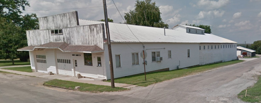

My Great-Great Uncle owned a lumber yard in Emden, IL. It is still family owned, but being in a tiny farming community, it's just barely open. The building was designed for air flow through stickered bunks of wet pine that was brought in by rail. During the summer, windows were opened in two huge cupolas on the roof. Doors at the bottom of the outside walls were hinged on top and opened. That drew air all through the building. Today one of the cupolas remains, and of course the bottom doors haven't been opened in decades.
View higher quality, full size image (863 X 343)

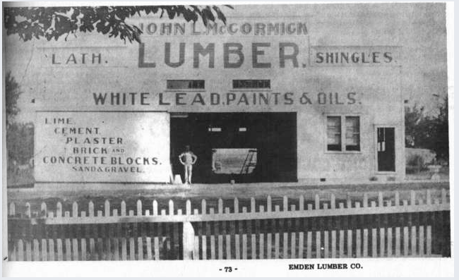

I should have added this picture of the Emden Lumber Co, before my Great-Great Uncle bought it. Here he was as an employee, standing in the doorway.
View higher quality, full size image (650 X 397)
