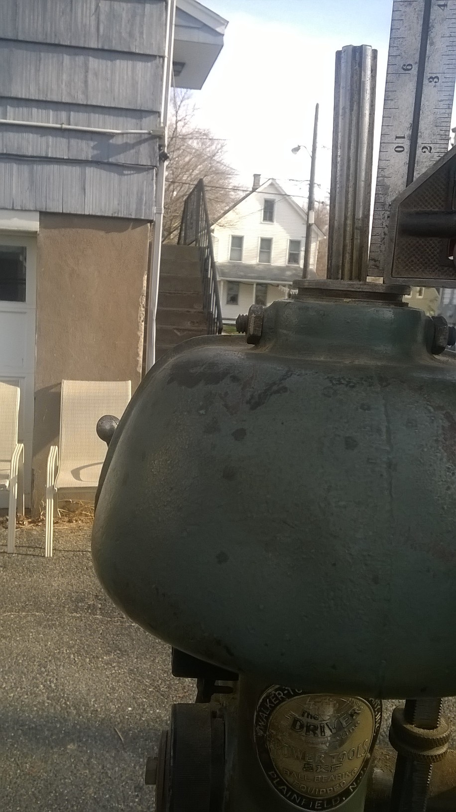

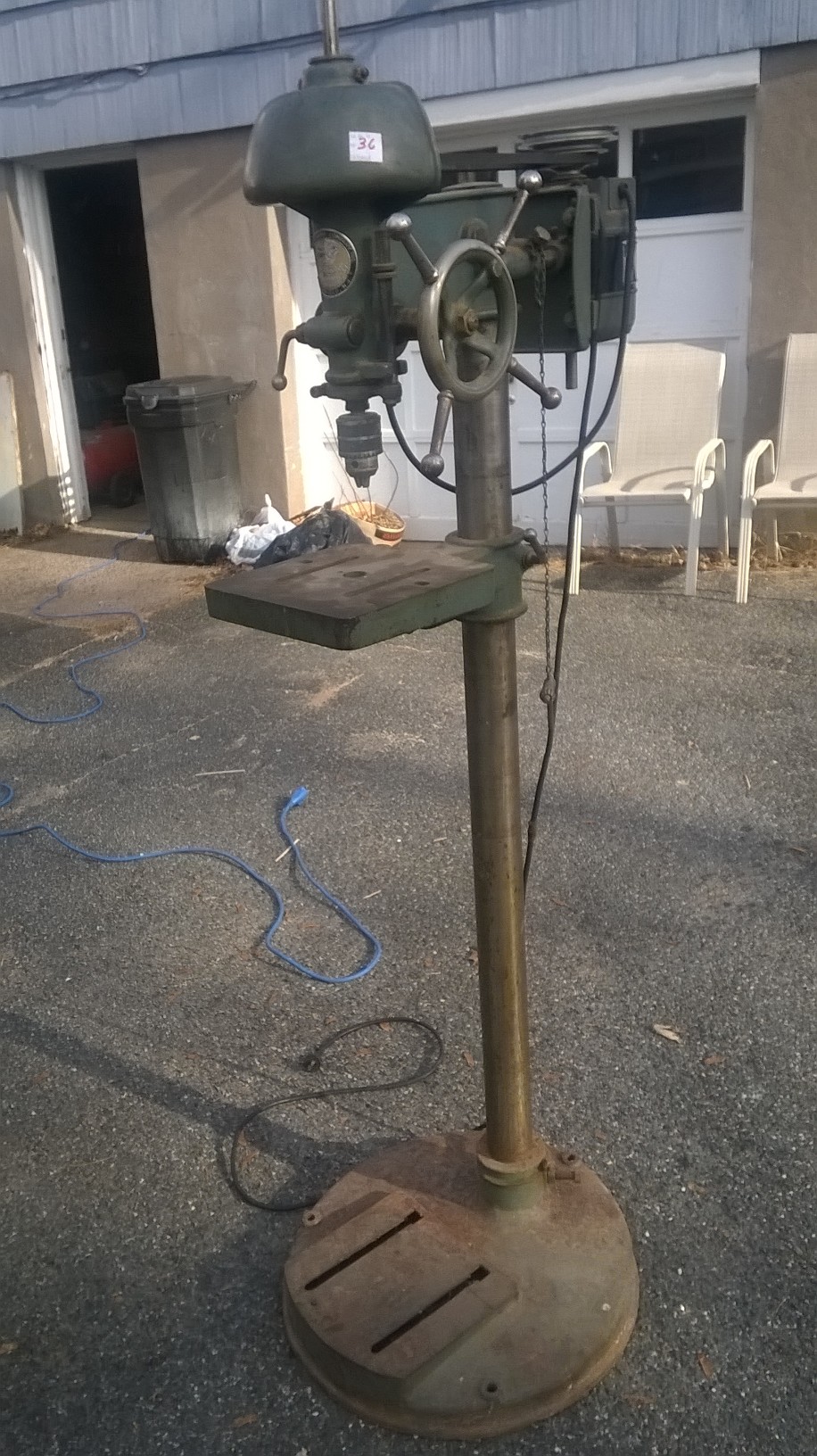

Just picked this bad boy up at auction. The shaft is bent at the top right where it goes into the bearing. Some numb nuts must have dropped it on it's head. I am going to post this at the OWWM forum but also am posting here as i've had problems with pic uploads on that site. My question is similiar to the lathe one, how do I get the shaft out to have it straightened? I know it's probably pretty easy but why not ask before I start hammering. Thanks...Joel

Take the pulley off the top first, then remove the nut on the left side opposite the hand wheel. I think that is all you need to drop the whole quill out.
However, I picked one up once like this, and fixed it pretty good without taking it apart.
I chucked a center less ground rod about 3' long in the chuck, with the table set just below the end. When I rotated by hand, the amount of runout is exaggerated by about 12, so it is easy to see which way.
I then positioned it where I could put a block of wood against the chuck, and struck it with a big framing hammer. If you rotate it after each blow, you can judge how hard the next blow needs to be to get it centered.

Thanks Keith. I got it all apart yesterday. I ended up cutting the shaft out with a sawzall as it was to badly bent to salvage. Getting a new one soon. I've yet to even need a special tool. I paid $15 for that thing. One man's junk is another man's treasure!
