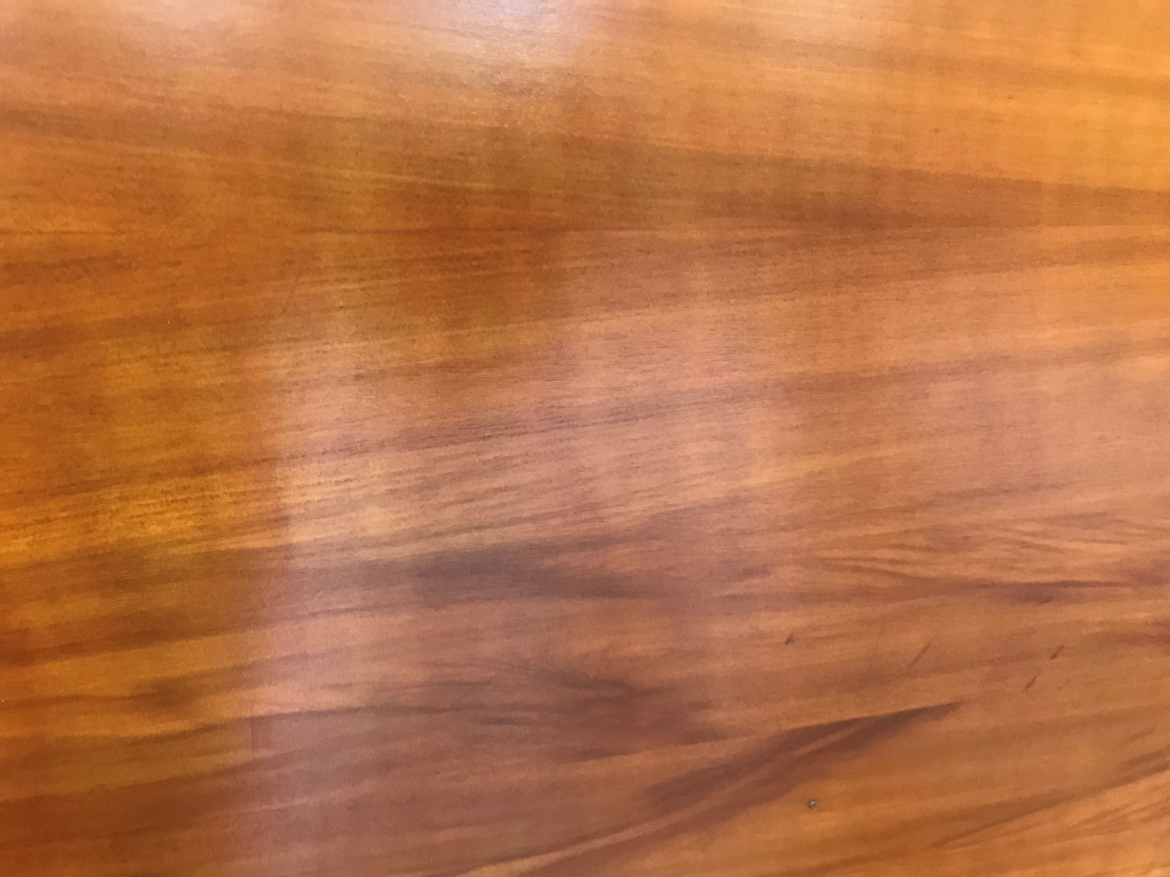

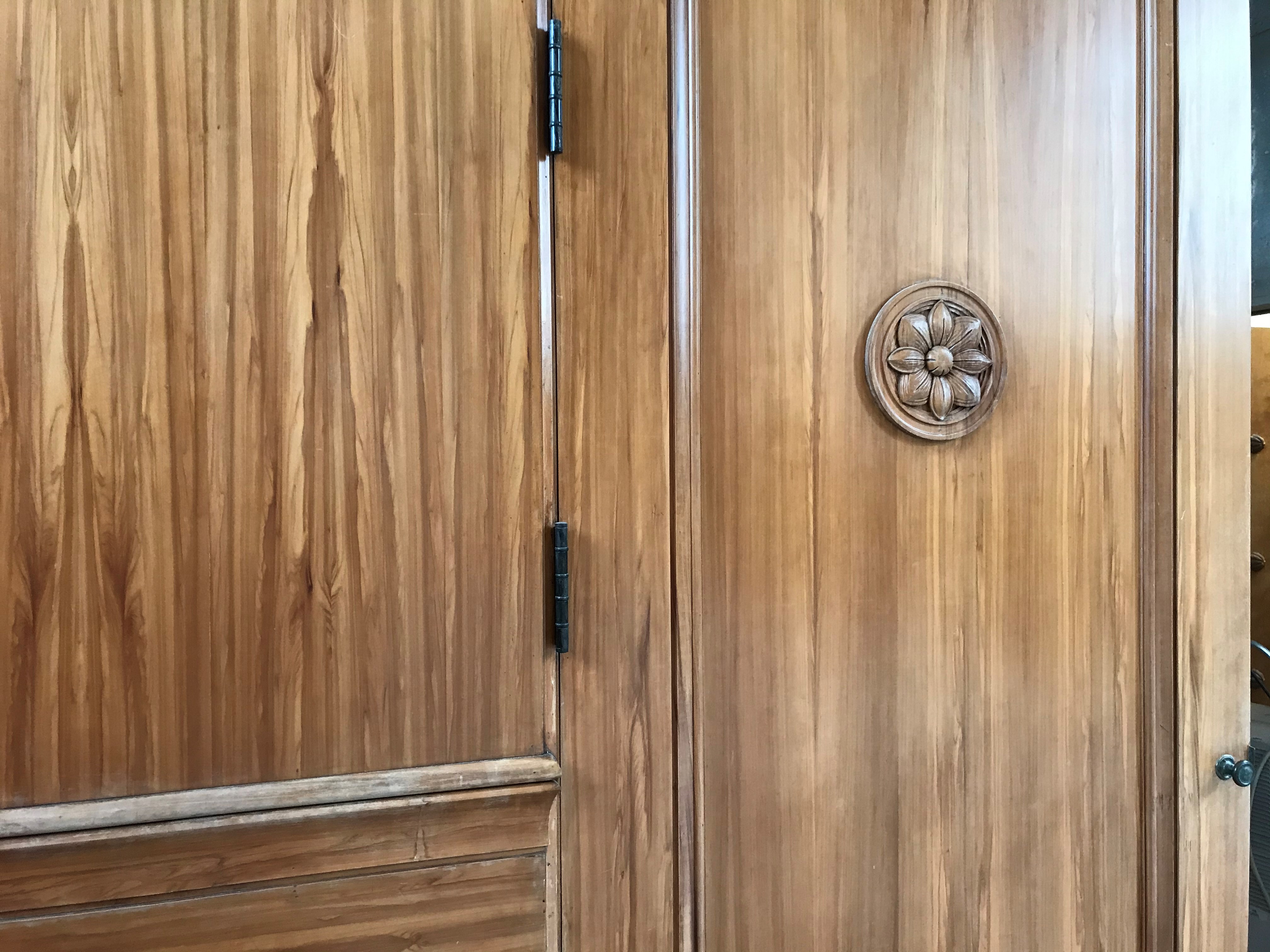

I am managing a restoration (damage caused by broken sprinkler pipes) of a wood panel room. There is a mysterious wood grain pattern showing up on the walls that got sprayed with water. It looks like plywood grain pattern. However, there is another wood grain pattern on the wood (we think it is Gum) veneer. It seems like the plywood pattern is on the shellac. Does anyone have an idea of how it showed up suddenly? It is not showing up on the wood that was not sprayed. When the woodworker subcontractor did light sanding and refinished in the mock-up, the pattern still shows up. See 3 images attached. How do we get rid of it?

The crossgrain texture is the veneer beneath the face veneer. It is either a plywood face or a crossband veneer. The water has swelled it causing the texture to print through the thin face veneer.
If you have sanded enough to achieve a smooth surface you may have sanded enough of the face veneer in areas to get below the wood that has changed colour due to light exposure and oxidation over time. I don't know how you can fix this other than shading with a transparent stain to even the colours. If it is what I suggest then it might take only a few weeks before the differences blend (I'm not familiar with gum's light sensitivity)

Good call Tom. You've really got a mess now Stefan. I have no idea how you repair that sanded panel now. Going to need a replacement plan now. Who pays for that is going to be a hard discussion. Better call your insurance man now!

That one is pain but to be honest your second two photos dont look terrible but its hard when your not in the space.

That first photo looks bad. If you can manage to restore a good portion of what is in the room, you may consider engaging the services of a good faux finisher to match the damaged surfaces to the salvageable, or even have them faux finish the entire room.
Your restoration options on restoring the wood veneer seem limited at this point, as even using a lot of lacquer tint to mask the shadow grain may not work well. I am presuming that replacing all of the woodwork is not in the budget or otherwise out of the question.

I think this is due to water popping, which creates water in the tissue to appear. You can use a better primer according to the type of filler you have used to remove this.
