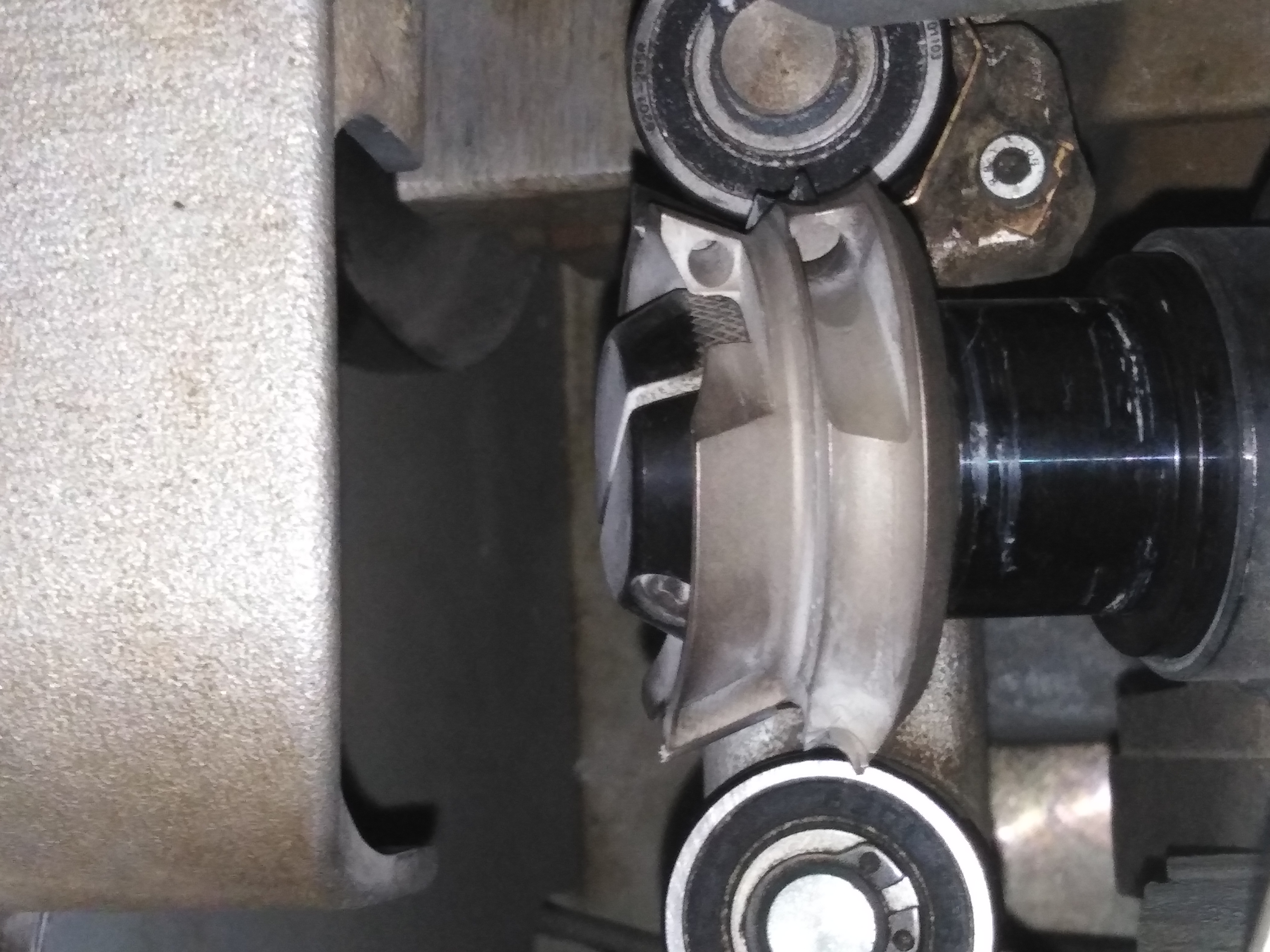

Hello all
I have been using my edge bander for about a year
And i am start to having problem with my trimmer unit it is giving me wavy rounding edges
I check it out while cutting it is spreding to much pvc on the small wheels knowing that i am using the same vaccum
Does my trimmer need changing?
View higher quality, full size image (4160 X 3120)

The cutters need to be changed regularly and need to be sharp
All cutters on the machine must be sharp to get the best results.
