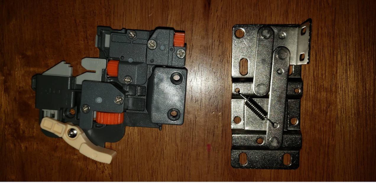

Because of the virus, the cabinet shop is closed. So I picked up the parts to assemble. I was able to do a good job on 12" base cabinets, but there was no nub for the front of the drawer to sit on. That was issue 1. When I got to the bigger base cabinet, I ran into another part. Without knowing exactly where they go, I'm stopped. The base cabinet is 12 inches of drawers in the middle, with 24 inches on the left and right of that, for sinks. Thanks for any help. See picture of parts. I suspect the gray part with the lever is for the drawers, in some way. I'm totally stumped by the bracket with the spring loaded wire. Thanks for any help!

The hardware on the left is an undermount drawer release, for the LEFT side of a drawer. The right piece is a tip out mechanism for a sink false front, this one is a RIGHT

Stuart, that totally helps me! I can go ahead and assemble now. I do have those tip out containers, so I get that those are not just false drawer fronts now! Also solves the drawer issue I had. Thanks so much!!

Stuart has it correct except I think that tip out hinge is a LEFT and it's shown upside down.

My bad, That tip out is upside down, I didn't follow the long arm geometry properly when I "opened" it up in my minds eye. :)
