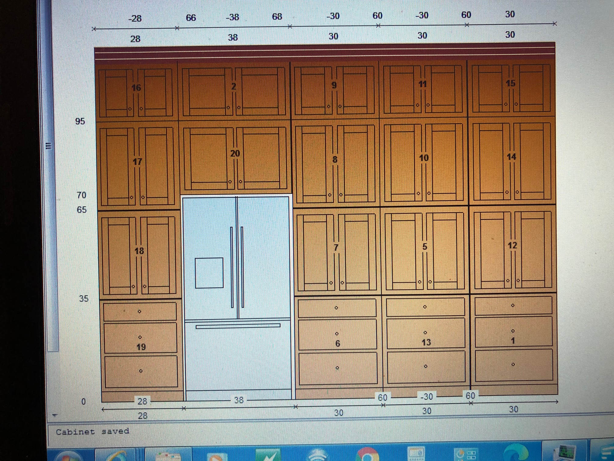

Ok, here's my problem. I'm a woodworker with many years experience making custom furniture. I've taken a job for a whole house of cabinets. I've already completed the vanities, utility cabinets, etc. The plans call for floor to ceiling cabinets across a whole wall, no counter top, just cabinets and a refrigerator. and they are the FULL DEPT OF THE FRIDGE (approx 28" deep), (see pic I made from Cabinet Planner software, which may not be the final design). The wall is 156" (13 ft) by 10 ft. tall.
So, how do you join the faceframes for a seamless (or near seamless) monolith look. I plan to spray all cabinets with a pigmented catalyzed lacquer, so I prefer to do it all in the shop.

Make cabinets 6, 13, 1 a single cabinet
Same with 7, 5, 12
8,10.14
9, 11, 15
Then you can just stack them with a horizontal line to deal with. Cover it with a bead or nothing. Same with the other cabinets.

First of all I would build the cabinets 24" deep because any deeper is impractical storage. I would build beams of plywood 4 x 4" section and screw to the wall to mount the cabinets to.
I would raise the upper cabinet line to the height of the fridge opening to achieve a consistent horizontal line. If you are concerned with a seam being visible you could add a bead at that horizontal to hide it such as a bead.
You would end up with four face frames applied onsite - upper and lower bank of 3 x 2 cabinets to the right , 2 x 2 cabinets above and left of fridge and two lower cabinets to left.

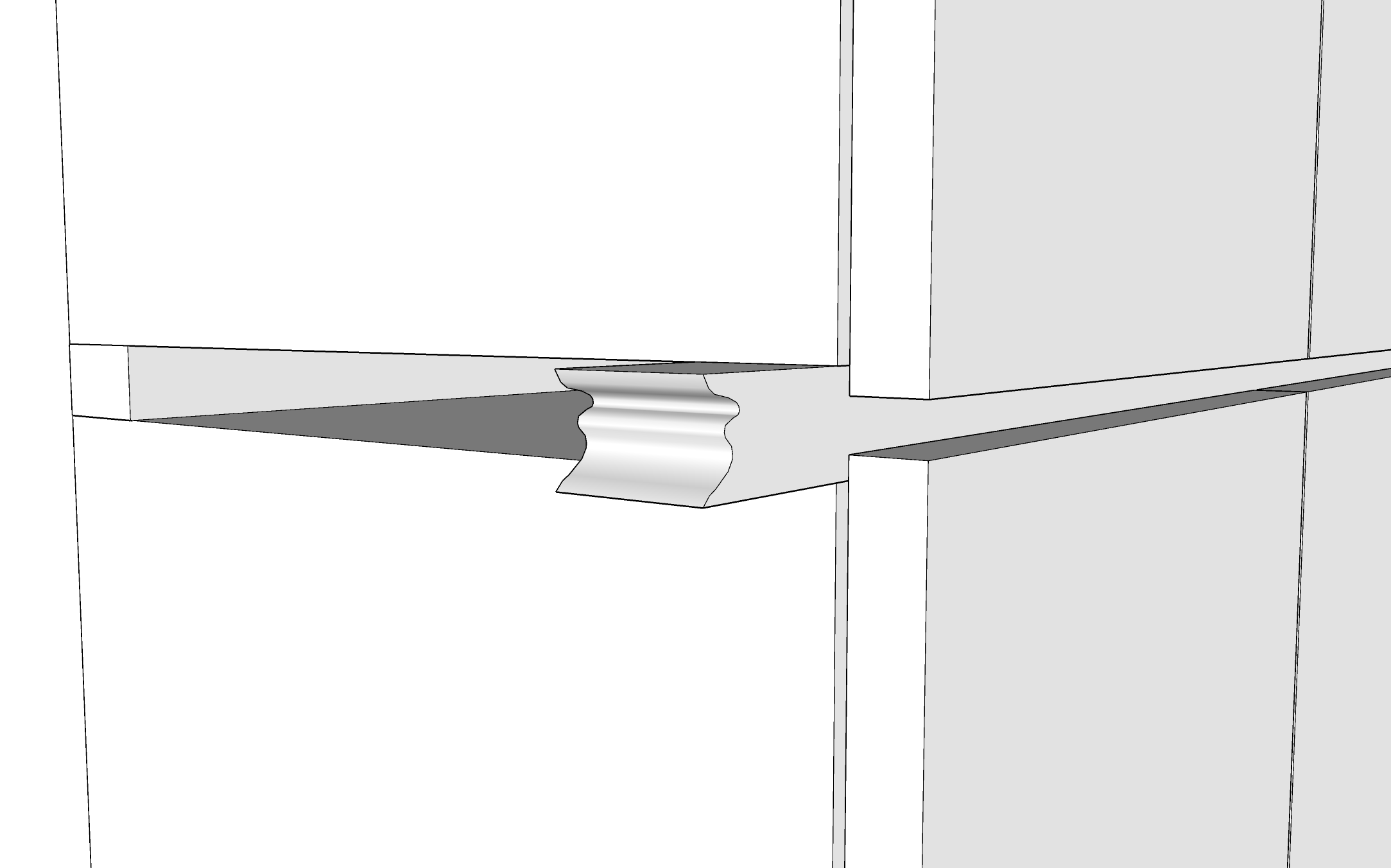

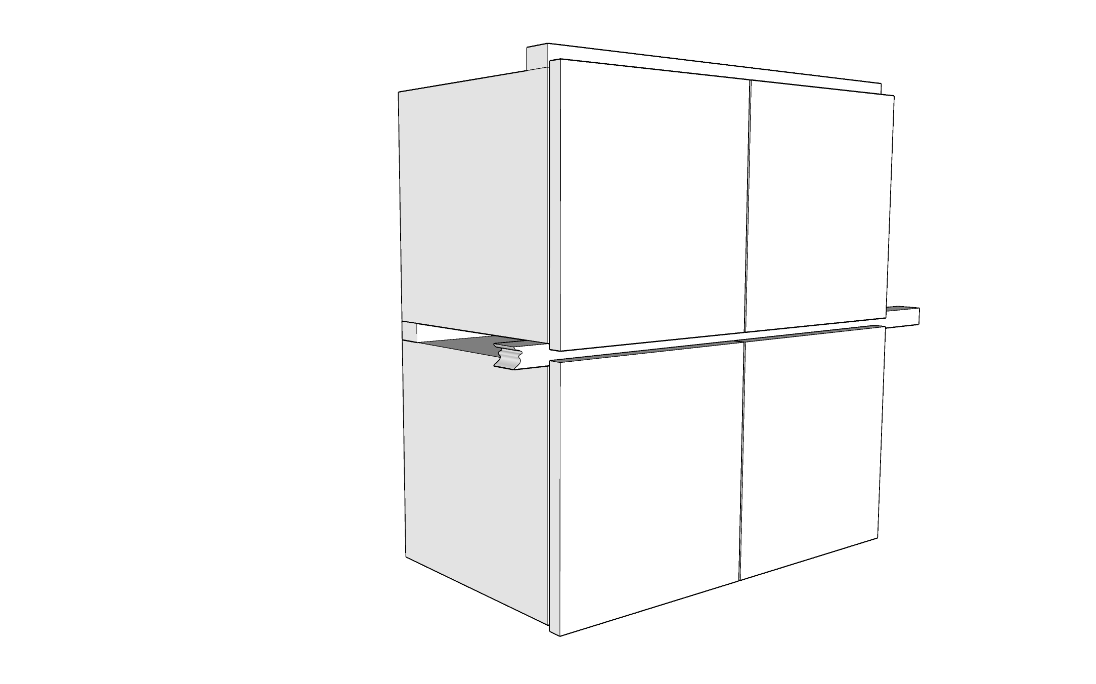

Even if you need face-frame look, I would build frameless cabinets with oversized doors that protrude beyond edges of the cabinets (not a problem for upper and lower edge, and I think hinges exist for more than full overlay), and then I would put horizontal and vertical beams between cabinets during the installation.
That way, doors would cover seams between cabinets and beams, and the only seams visible would be short lines where vertical beams meet horizontal ones, provided that the horizontal ones run in one piece all the way from left to right.
See the quick sketch on pictures bellow for details (I omitted vertical beams for clarity).

Follow Leo’s cabinet layout. It’s always easier to build long units vs tall.
Pack the wall out so you can use standard 24” deep cabs. It will save the customer $2k in plywood. They will barely use the 24” depth.
Two basic options with the face frames. Easy option is to frame each unit then add a little astragal trim piece. The harder option is to temporarily fix the cabinets together in the shop. Apply your face frames so that the upper units frame over laps the lower. You glue, screw or nail The frames on. Do not glue the overlapped joint or butts. Let it dry. Sand it all flat. Disassemble, paint install. If done properly this will look really good. We do this with bookcases all the time. Even beaded face frames.

Leo G. I think your idea for combining cabinets is spot on. Makes sense to me to build them horizontal rather than tall, as you and others have also suggested.
Good idea to raise the line of the second tier to be even with the fridge. I'll try to get the customer to live with the 24" cabinets, we'll see how that goes.
