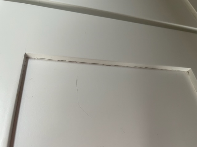

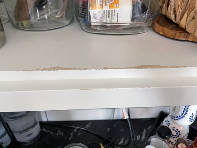

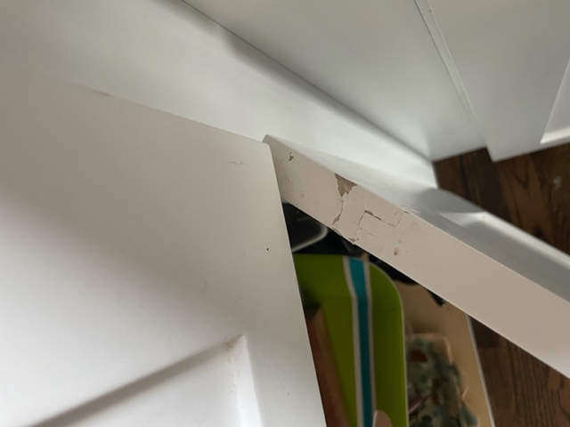

We are homeowners who completely gutted a farm house to the studs 3 years ago and now are having problems with our painted cabinets chipping and paint de laminating. I was hoping to get opinions on weather this is natural wear and tear or possibly poor craftsmanship.

Top photo looks like expansion (rather contraction) of the center panel on a 5-piece door... that is unavoidable if the maker used a solid wood panel.
Second picture looks like normal where and tear - finishes aren't going to standup to years of rough-bottomed jars being drug across a sharp corner.
Third picture looks to me like moisture damage into an mdf stile but it's hard to tell. Looks like that cabinetry is past it's best before date in my opinion.

Thanks for the response....should brand new cabinets be past their best by date after less than three years? I understand the chipping from useage but I have had painted cabinets before and never had either of the other problems.
If it is unavoidable if the maker used a solid wood panel, should he have used MDF or a different method? It doesn't seem reasonable for 3 year old cabinets to need to be repainted? Also these cabinets were not bargain or cheap afterthoughts...we paid over $20,000 and expected them to last longer than three years before needing to be fixed...am I being unreasonable or are my expectations not realistic?

Second, while its the current trend, white or most any pigmented finish, on shaker cabs, is akin to when people buy a black car and everyone says "hard to keep clean". The cracks at the panel/rail/stile are pretty much inevitable unless you either use crap MDF routed doors (no panel/rail stile, door machined out of ground sawdust), or the manufacturer leaves a large gap there so the finish doesnt bridge over that joint. Both are what you will see at the home center on even "high end" cabinetry. Intentional gaps to avoid posts like yours. Your doors look well made as these manufacturers would typically have an intentional edge at the rail/stile where you see a very small crack in one of your images.
The edge of the shelf/bottom of the cabinet is clearly heavy wear. Hard to say if a different finish would have avoided that but you can look at new high dollar cars and see all sorts of scratches around the door handles where women (or men) dont take their nails, jewelry, key rings, into consideration and that heavy wear point is all scratched up while the rest of the paint looks acceptable.
The finish issue on the top edge of the door, in my opinion, does look like poor edge soak where the stile sucked up most of the finish and left it a bit thin.

I agree with everything Mark said - also to the point that this is a commercial forum and I don't want to be sucked into critiquing others' work without ever having seen it in-person. That being said, I have my custom tool supplier grind a "paint notch" into the knife that plows the panel groove to avoid this very issue of finish cracking and the panel-to-frame joint. We as cabinetmakers are not perfect... even the climate in the house will have an impact on the doors' longevity, and we have no control over that.
Re: the finish on the edge of the shelf: I've even seen UV prefinished plywood and melamine coatings fail in this type of high/hard use area. It is what it is, and when I complete install on a kitchen I make a point of telling the client that the finish WILL where depending on how they treat it... this usually compels most clients to respect what they just paid thousands for.
