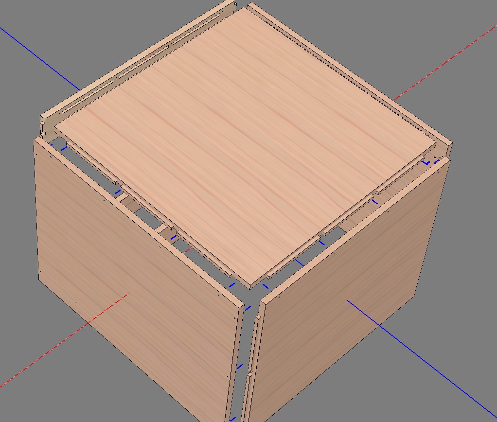

Presented for comment here is the captured back configuration recommended us by our CNC cutter, who has done this for years with success.
Backs are 3/4 material, same as all other carcase parts, which eliminates need for nailers. Inset is 1/8" to permit a little scribing if needed to adapt to wall bumps. If your walls are worse, correct them.

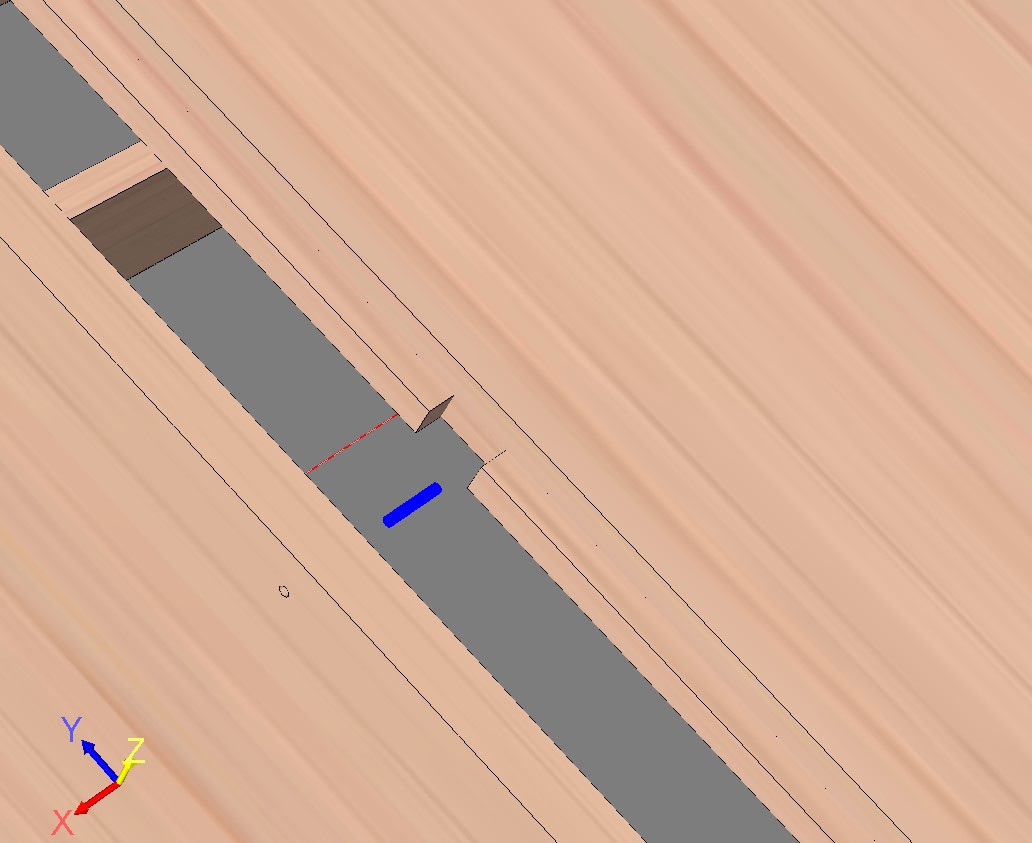

Joinery is a variant of blind dado, called "lock dado" by Thermwood, the machinery-maker that has the freeware package eCabinets used to produce this set of images. Blind dados are interrupted by short no-dado sections, and that is where a 3mm thru hole is bored by CNC for the zip-screws used for all assembly.

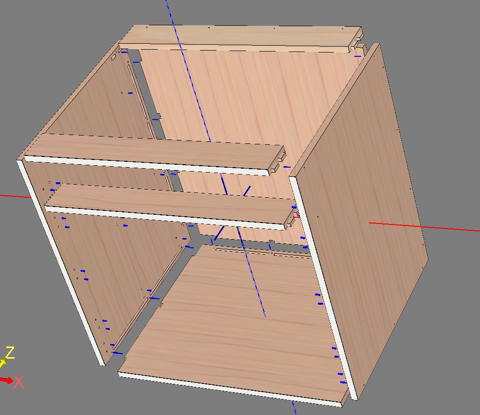

The assembly sequence is to always first join the back to whatever top and deck there is for the assembly, then with a side ("end," "gable") laid flat, the subassembly of back, top, and bottom is set into mating mortises, and the other side fit to the parts, then screws driven, the box flipped, and remaining screws driven.
Add glue if you wish, but we don't. All goes quickly, and we are pleased with it.
In the images, the blue dowel-like elements are the 3mm thru-holes that are CNC cut. Exploding the assembly in this software, the holes come away as separate elements.

3/25/22       #2: Captured back revisited ...
Cris
Change you're deck to back flush. That way you can eliminate the flip operation on the deck.
