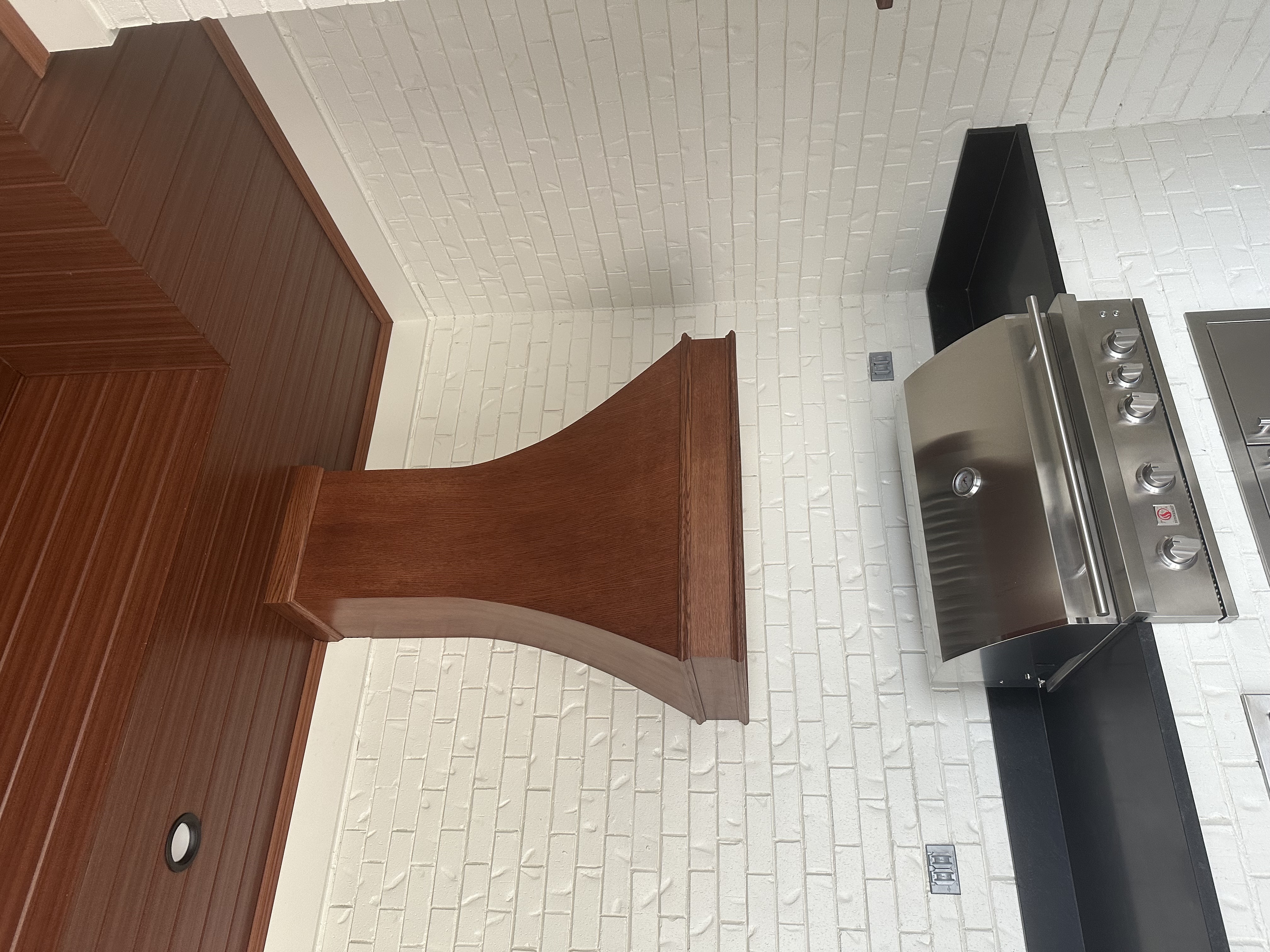

Leo, in your picture I see there's a corner block above your hip rib but it's hard to tell from the picture if the rib is mitered along its length, is it?
If it is, how did you make the miter cut? I've made miter cuts along a curved piece before using a jigsaw set at 45°, cut the curve on one side and flip it and cut the curve on the other side.
How long did it take you to build the first one? How long does it take now after how many builds?
I've been asked to build these several times and I can never imagine that for what I would have to price it at that they would move forward with it, considering the cost of what a pre-made one is. But maybe I'm overestimating the time involved.
4/4/25       #8: Wooden range hoods ...
Yes it's mitered. I'm sure I used a router bit. The bending Poplar wasn't mitered because it was a painted unit. It was butt jointed. This was done a long time ago and I don't remember exactly what I did. I think I put the side on and trimmed it flush and then overlayed the front onto it. If I was going to do this in a stained piece I would do the same thing but then veneer the piece and still not worry about trying to make a curved miter.
Probably took me about a week to make it and paint it. I haven't made another one with the duel curve on it so I couldn't tell you. Everything I do is custom and I don't do a lot of things more than once.
The closest I've come to making another is the other hood I've put a picture up of. But that one isn't anything near what I think you need to produce.

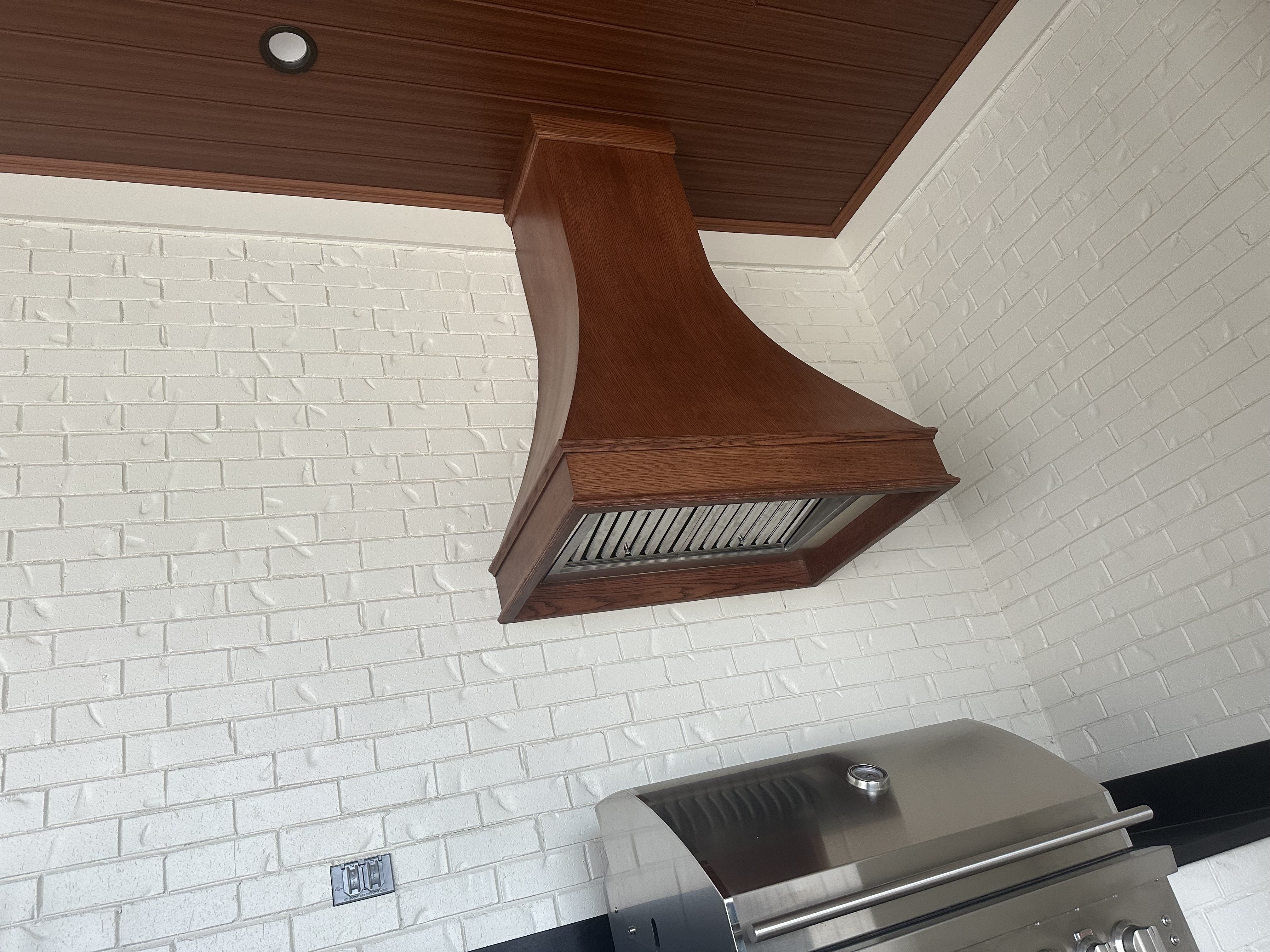

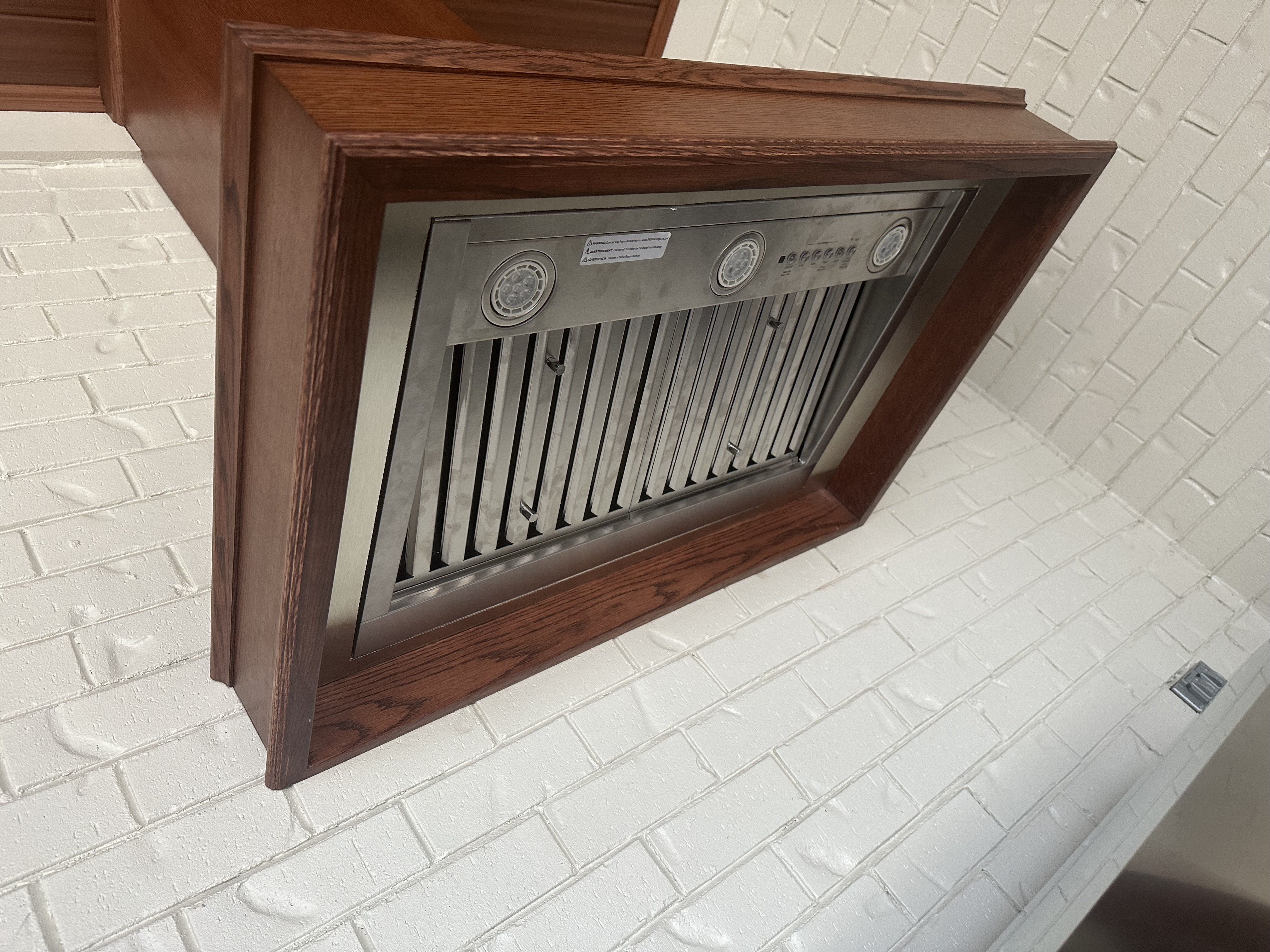

Most people doing those swooped hood shapes use either bendable MDF, 1/4" MDF in laminated layers, or kerfed plywood. Two layers of 1/4" glued over a form gives a much cleaner, smoother curve and is way less headache than trying to force 1/2". If you can get bendy MDF, that’s even easier.
11/30/25       #36: Wooden range hoods ...
Chris
I got it done turned out pretty good
