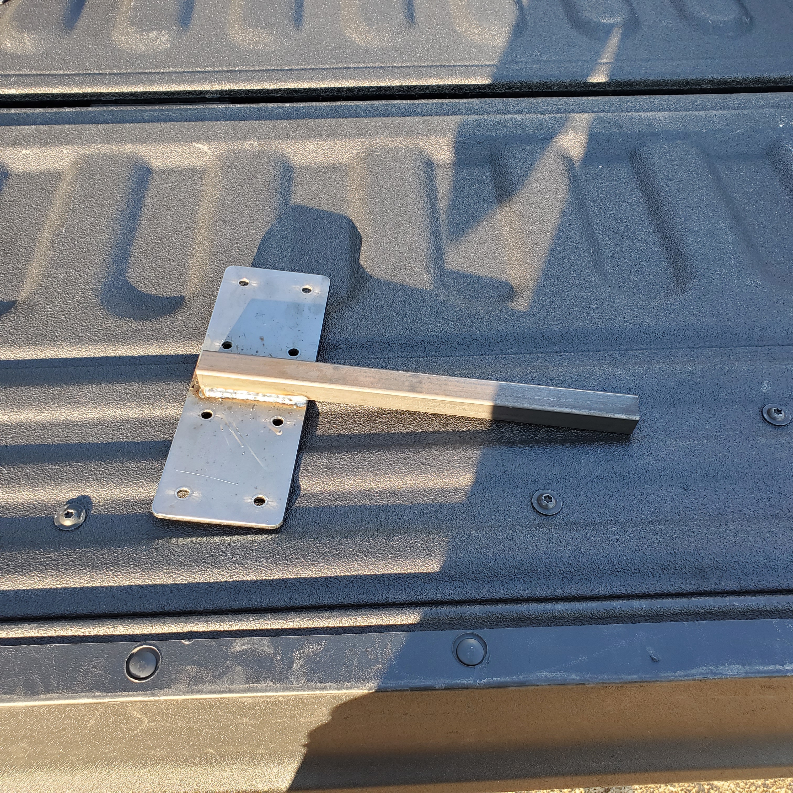

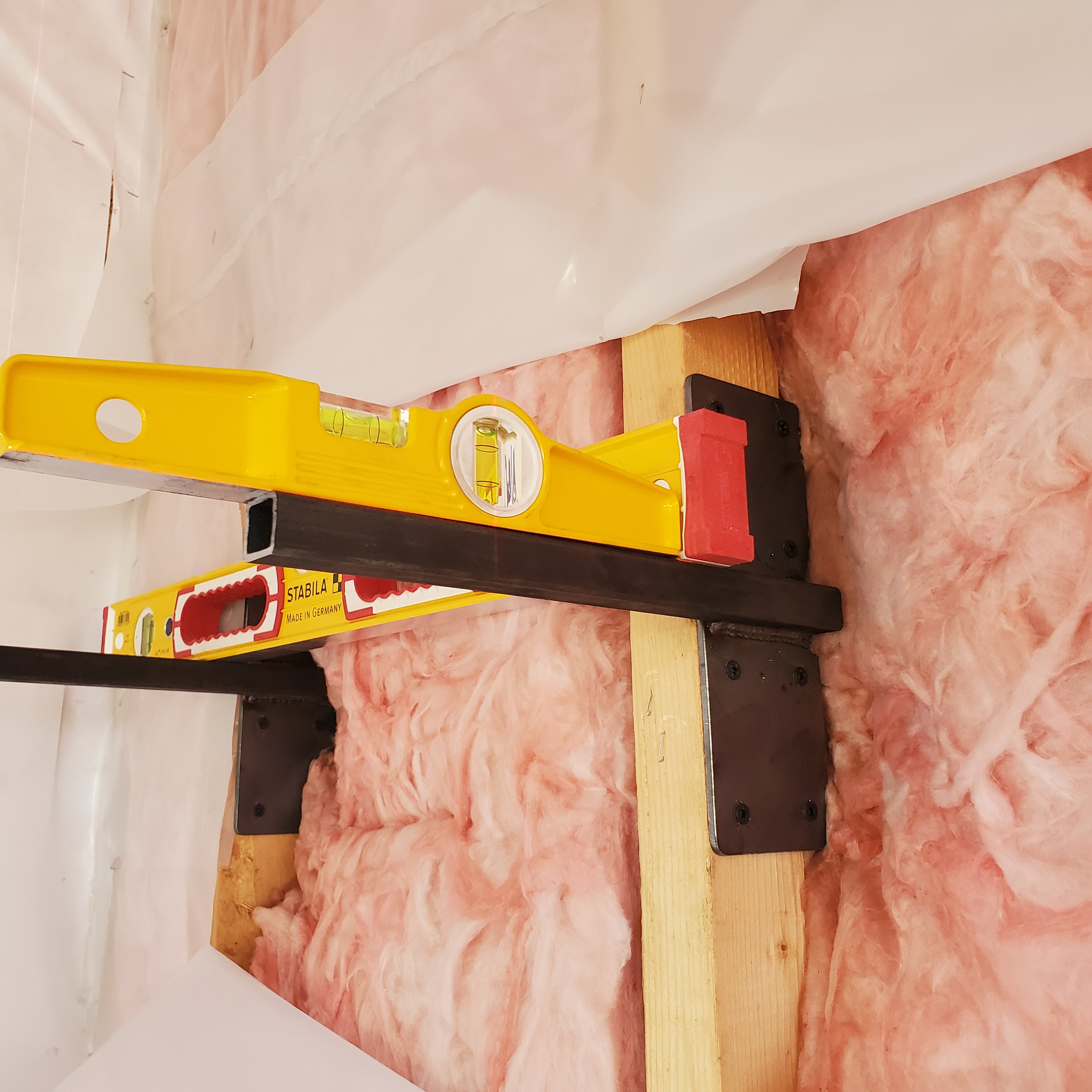

I have a metal fabricator plas out 3x8 plates from ⅛ steel. Then weld on a piece of ¾" square tubing 90º to the plate.
The plate gets screwed to the side of the stud with 8, 1½ long screws.
Pretty stiff. Not very expensive. Requires opening the wall if a remodel or not a new wall.
I don't have a picture in my phone. I'll try and remember to grab one tomorrow

Found pictures.

Karl, those photos perfectly illustrate why your custom bracket is so solid. Attaching the steel plate directly to the side of the stud is a great way to maximize shear strength and completely bypass the drywall crushing issue Leo mentioned. Welding the 3/4" square tubing creates a highly rigid moment connection that easily eliminates that "spongy" fulcrum effect Travis is dealing with.
Out of curiosity, when the wall is closed back up, do the drywallers just tape directly around the square tubing, or do you leave a slight gap and cover it with the back of the torsion box?

Depends on who's doing the taping. Most of the time my floating shelves are 2-1/4 thick, so theres a fair amount of forgiveness when it comes to that.
