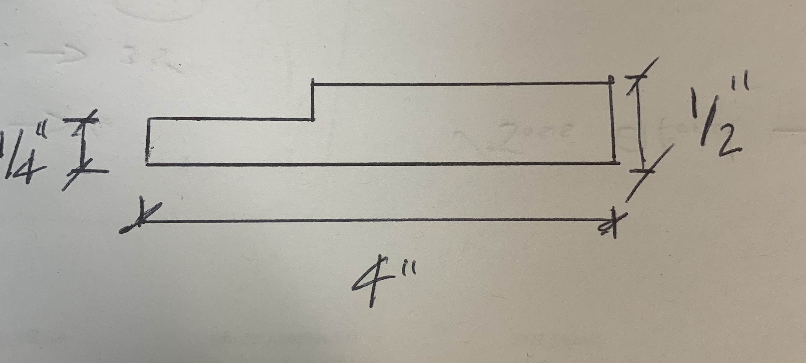

I would like to build some plastic slides to run a saw down. I would like to build them out of some sort of plastic, I need them to be durable, not brittle and act as a strait edge so durable. The longest I would need is 8 ft. The reason I want some kind of plastic is they will get wet.
My questions are?
What material do you recommend?
What feed and tool speeds do you recommend?
What tooling do you recommend?

UHMW, HDPE, or solid surface drops if you have a shop close by that would give you some would be my suggestion. A lot depends on your availability and your budget.

Umhw. hdpe, and Starboard may not be rigid enough to act as a straight edge. It will flex in the middle if it is clamped only at the ends. Phenolic would be a better choice but I would make it out of two layers of 1/4" thick that is screwed together. Phenolic can be tapped for machine screws.

No such thing as a plastic straight edge. The slippery materials recommended will sag under it's own weight. Time is profit. But a track saw and make money. Dinking around to save money on machinery is lost profit.
2/1/21       #9: Cutting plastic material ...
Oggie Member
I have 1/4" thick, 4-1/2" solid aluminum bar, a little over 8' long and it sags in the middle when sliding handheld router against it, unless I put additional one or two clamps in the middle.
I doubt the plastic will do the work.
2/3/21       #10: Cutting plastic material ...
Scott
Thanks for the input, I will just use a piece of plywood and throw it out when we are done. I figured if I cut some plastic straight/edge slides on the cnc, I could use them and then put them in the racking if I ever needed them again.
