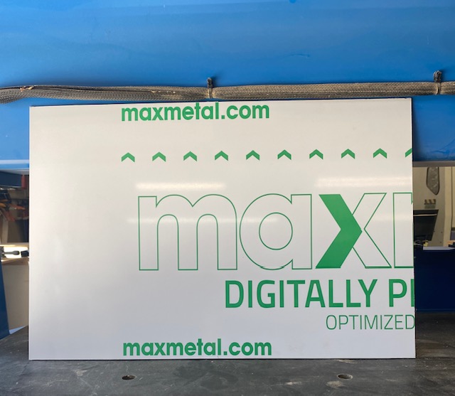

A local sign shop has asked me if I could cut aluminum sign board for them on my cnc. The material is 2 sheets of thin aluminum laminated over a poly foam core, about an 1/8" thick overall. It seems to hold down well under vacuum on my spoilboard. I was thinking a 1/4" downcut spiral would work, but I'm open to suggestions from more experienced operators. Also, I'm not sure about what feeds and speeds would be recommended. Any advice would be appreciated.

I cut this with a down shear 1/4" O flute for aluminum. Be careful of chip reweld due to the down shear. I a final pass step over of .015" and get a clean edge. As the bit dulls you will get a small burr on the lower edge.

Tom - what do you recommend for feed rate and rpm?

150 ipm at 18000 gives a chipload of .008". It works for me. That is the max spindle speed for my machine.

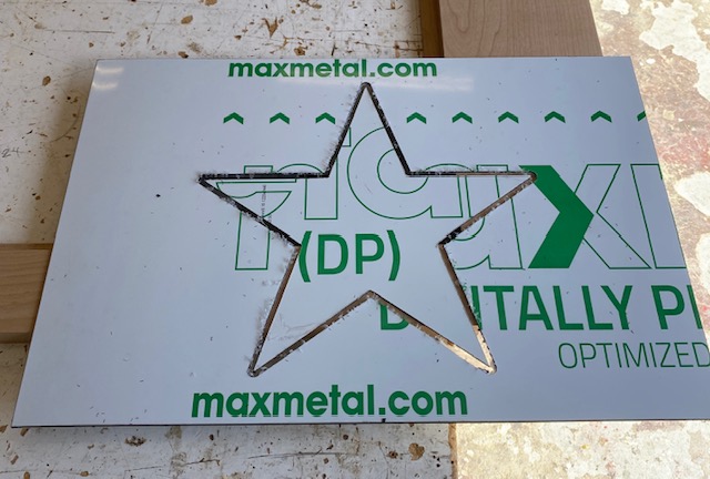

I found a 1/4" downcut O flute bit I'd forgotten about and made a test cut with the recommended feed and speed. It seemed to cut just fine, I'll look into an upcut bit if I end up doing more of this. Thanks again for the help!
