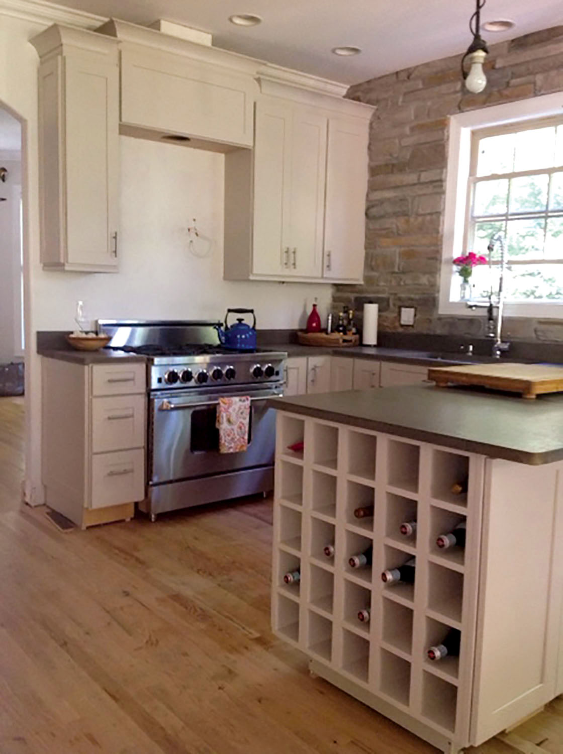

Hi
Just curious what methods others use to apply finish to the interiors of wine cubbies. The 4x4 cubicles that you put individual bottles in. Particularly pigmented finishes. Do you paint the unassembled cabinet parts flat (masking joints) and then assemble? Shooting lacquer or CV into the cubbies after assembly results in poor finish quality. Any insight appreciated. Thanks. Image is not of my work just an example.

Finish the parts first then put them together!

BobbyS
I second the motion!!
... We fully assemble them, then next, we just unscrew and remove one end- so the interior is open enough for easy spray access.
Lastly, we only have to screw the end back on. Done!

Nick
I agree with mastercabman. But oftentimes you don't get the chance to finish ahead of time. In that case l spray them out the best l can, (a AAA setup is my tool of choice for this. let them dry well for a couple days to a week then sand them smooth, starting with 180/220, 320, marron stoch-brite or mirlon pad. It's more about touch in those cubbies than looks so just get them covered then make them smooth.

Spray them before assembly. Brush them after assembly. The film finish doesn’t have to be perfect.

Bill
We build all of our wine cubbies using “magic wires. Finish flat and assemble. Really simple. And perfect finish.
Easier to install as well.
