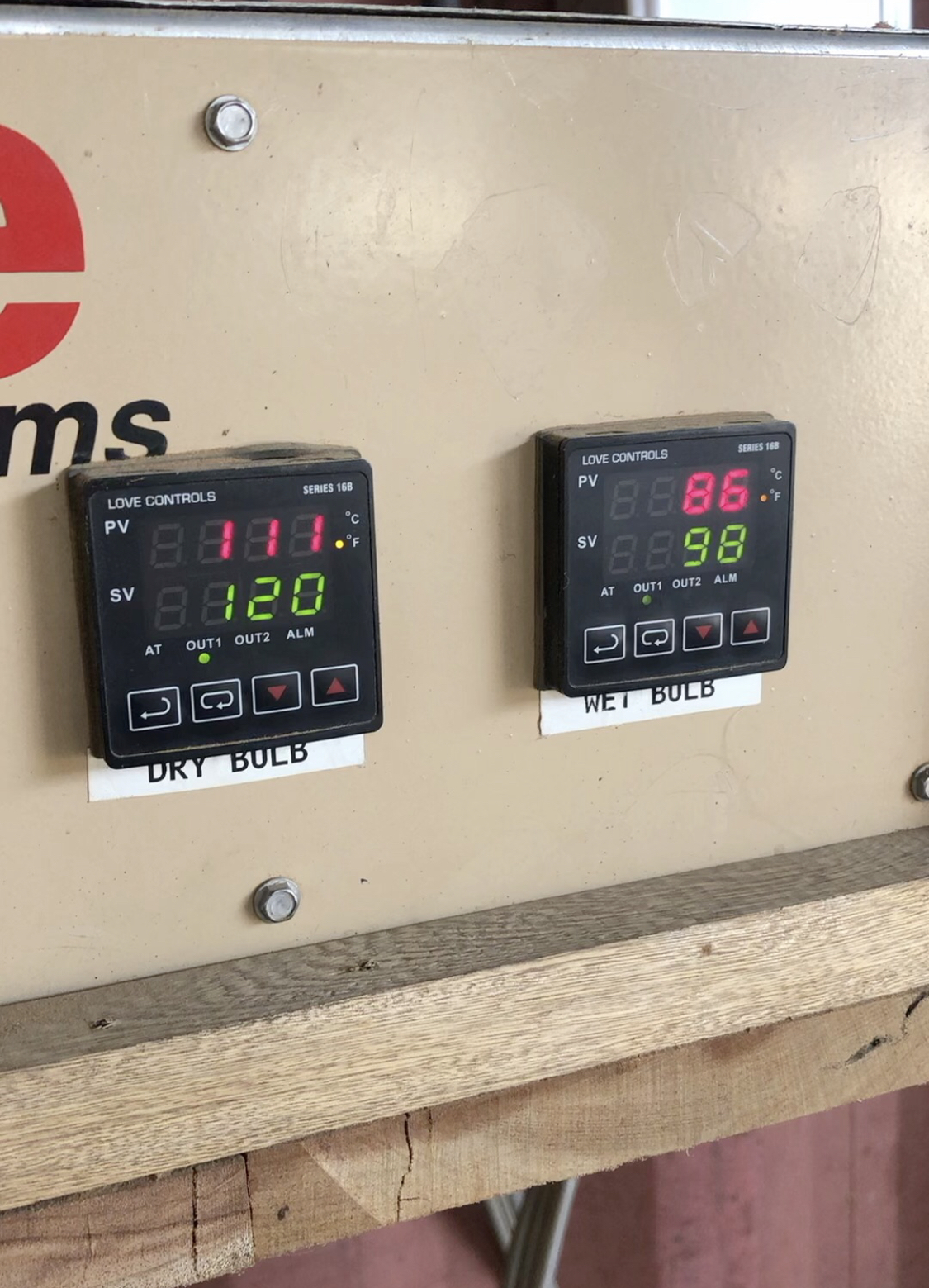

The 16b love controller has a lot of functions and I can't find anything online to tell me which one is correct for the kiln.
It seems the newer NYLE kilns come with their own controller, and have more specific settings ( so if any of you are PID controller experts I could use some guidance >_<)
1. First of all there are two PIDS, one for dry bulb one for welt bulb which makes sense in terms of getting the read on both temperatures but do both get set in same settings or different?
I have the dry bulb pid set to 120 and the wet bulb set to 98
2.We have been running both on ON/OFF and just setting the temperature to what we want, but it seems to just be heating and not.. well controlling or maintaining certain settings,My guess after some research is it should be on PID setting and set to Heating or heating cooling dual loop. There are also functions like Ramp/Soak and so on. ( very unclear to me which one I need)

I have attached the b series manual for the controller as well as a photo of our control set up.

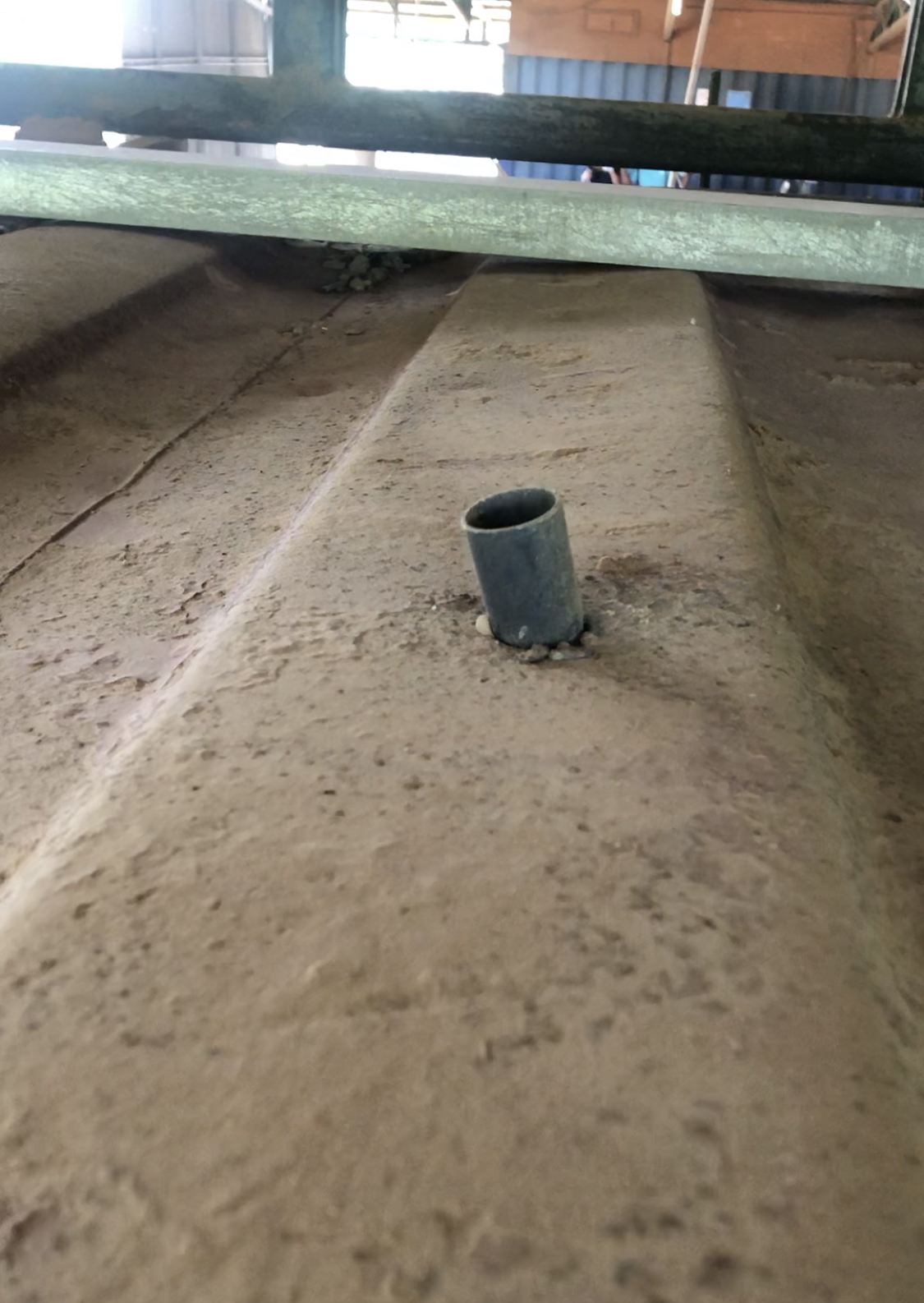

I am also attaching a photo of a random hole/pipe sticking out of top of kiln that I think...would be best to be closed?
