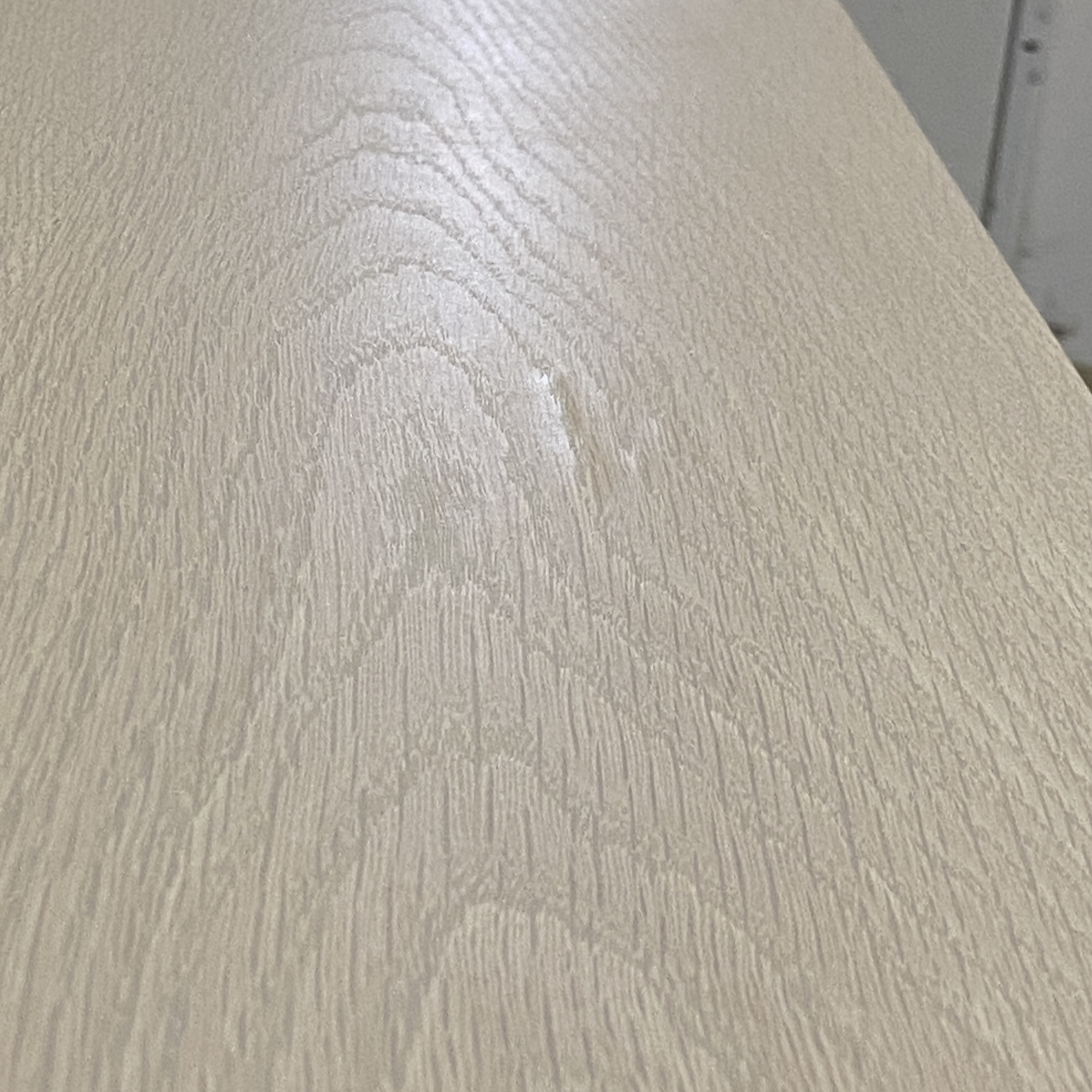

We are getting some bubbles/lifting in raw veneer and the bubbles are following the grain like finger-shaped.
Some data:
- plain-sliced white oak - raw veneer 0.024 thk
- substrate is Medex
- glue is Titebond III, applied with roller
- Joos Press, 176 deg F., 6 minute press time
- After veneering, the wood is bleached (2-part) and then stain + lacquer
Is Titebond III the wrong glue?
Is the press temp too high?
Is the press time too short?
Could the bleach be damaging the glue?
Most of the time we have no problem.
Any help is greatly appreciated!

I would not use Titebond III in a hot press. David Sochar on Woodweb has pointed out that the glue loses the majority of its strength a high temperatures. Titebond II on the other hand is not as badly affected and is what I use in my hot press.
The bleaching process will soften a Type 2 glue line if it is not fully cured before moisture is applied.
I press at a lower temp, 60°C or something like 155° F.
My guess is that the combination of weakened glue from heat and expansion stress on the veneer from soaking it, caused the wrinkling of the veneer. Probably most evident on the tangential grain and not so much on the radial grain. The photo shows the porous grain is the area of failure. Maybe you did not wait long enough for the glue to cure before bleaching. Moisture easily penetrating the pores to the glue line.
Call Franklin tech support for advice on whether bleach will be a problem too. Is Medex water resistant? I'm not a fan of pressing on mdf. I have had a couple of failures with it and HPL where the laminate pulled up a thin layer of mdf very easily.

Wrong glue. Use cp adhesives urea formaldehyde glue. Or uni bond 800
1/16/23       #4: Veneer bubbles - wrong glue or some ...
Dave Edgerton  Member
Plastic powdered resin adhesive

yep - to echo what was said, wrong glue. i would suggest a urea resin, i use unibond with great success. good luck.
