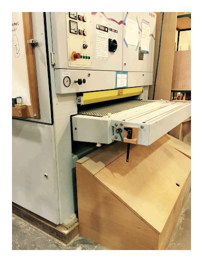

Sustain is, I think, the hardest part of the 5 (3?) S to implement. To standardize the sustain part you need more than just group hugs. The first "sustain" thing we ever did was to wire the chuck key to the drill press so it didn't keep walking off.
Here are a couple of other examples:
We used to have two large chests that lived under the infeed & outfeed of our wide belt sander. The conveyor bed has a 5 inch range of motion. The laws of physics decreed that since these chests were horizontal surfaces shit would get stacked on them.
So one day a guy who worked for me came in to say the conveyor built stopped running. It took about a nano second to realize he'd lowered the conveyor onto a wooden box that held confirmat screws. The box of screws was wedged so tightly between conveyor and chest that we had to take a sawmill and demolish the box to get it loose. Luckily we got off with just a small tear in the rubber conveyor built. We could have lost the whole sander.
We sustained this from happening again by building our storage boxes with slanted tops. This "S" required no kumbaya and works first time, every time, with every body.

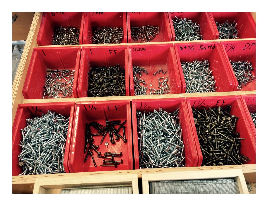

Here's some more of that pointy headed thinking:
We have a couple scissorlift work benches in the assembly area. Both sides of each bench are identically appointed. You will always find hand tools in the right side drawer and screws in the left drawer. Each screw drawer is identically configured and composed in a way that makes it slightly easier to get the right length screw into the right box.
This was a great system until employee empowerment (this one's for you Mel!) took over. The free thinkers in our shop thought it would make more sense to just grab a box of screws and carry them with you as needed.
While this a great short term solution the little boxes don't usually make it back to the same location. Just like trying to remember where the other guy put the salt shaker, getting a 2˘ screw in your hand shouldn't involve an easter egg hunt.
If anybody else has ideas like this that work for them I would love to see some pics.

What do you store in the boxes under the wide belt in/out feed tables?
Do I see the screw bins screwed to the bottom of the drawer to prevent them from “walking” away?

To tell you the truth I don't know what is in that box right now. We originally built it to hold shop blankets but those are in a different spot now. We have similar shaped cabinet on the outfeed end that holds bulk screw storage.
Yes, the screw boxes are fastened down to keep them from walking around. As soon as they are portable democracy sets in and you soon cannot predict where to find a screw when you need one.

As for getting the screw boxes back into the same place every time, make each box unique so that it will only fit into the drawer/storage one way, one place.
If you make a gridwork, notches can be put into the stationary grid and tabs located on the boxes so they can only fit right there. Color coding the boxes (by row?) can help get one to the general location, and the tabs insure it can only go in the one place - the right place. If this is in a drawer in a path of travel, then one must do it right, and complete, or risk blocking traffic and the public humiliation that should follow.

There is no one single answer for everything. If you want the bins back in the same place, put a label on the bin and on the place where the bin is supposed to go, yeah just like the salt and pepper shaker. It not only tells you where to put it, its a visual thing and the mind naturally want to move it to where it should go.

You said: "If you want the bins back in the same place, put a label on the bin and on the place where the bin is supposed to go,........... It not only tells you where to put it, its a visual thing and the mind naturally want to move it to where it should go".
With this strategy you are dependent on consensus to sustain. The real lean people have solved this problem with something called poke-yoka, aka fool proofing. Having a screw to hold the box down means you don't have to hope that "everybody's mind will naturally want to move it where it should go". In this respect poke-yoka makes everybody successful at the highest possible level.
For what it is worth we color coded our hand tools and store them in color coded drawers. You no longer have to look for a tool or spend any extra time to get it or put it away. Our work benches no longer have little puddles of tools and screws that need to be moved before you can use the bench. A clear bench is easier on the mind and is more conducive to humming kumbaya while you work.
