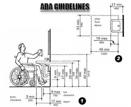

Does anyone have a link that I may view the cabinetry ADA standards.. For items such as, but not limited to:
Counter heights inside and out
Desk heights
Bathroom door openings to a bathroom or stall, etc
Thx

Im in chicagoland. Im trying to help out a hair salon friend who just had her franchise store remodeled and I'm concerned the spacing and countertop heights inside and out don't meet ADA.
From what i remember....
Counters need to be 34" and desk counters need to be 28
Additionally, openings and walk ways need to be a min of 36"

Alan F.
34" max for reception and all other counters, that's the top of the sink rim from the LOW spot in the floor.
27" min clearance at the desk, 29" in the restroom or any single purpose sink. 27" min at a multipurpose sink (easier to do 29" everywhere.) It all subject to local interpretation.

Thx Alan. The 27" is free and clear space, right?
Situation....a friend is a franchise owner of a major hair salon here in the chicago market...
The area the girls stand behind has a wall behind it and without measurung, im guessing there MIGHT be 36" of free walking space, but are there any general rules about that?
Also, the counter where people pay, im not so certain it's 29". I think it may be a bit higher. What is the min/max from finished floor to top of or underside of check out counter?

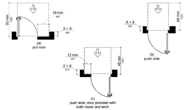

Don't forget about the 18" space to pull a door open.

Pat or anyone...imagine this...the gal checking someone out walks into a space that is basically surrounded on 3 walls.
So my concerns are
1. Does there need to be enough room for the wheel chair to be able to fully turn around and or if so, whats the minimum amount of space required?
2. Does that drawing apply to reception counters both interior and exterior?
Thx!
11/24/15       #10: ADA guideline standards ...
The clip board trick will not work in most jurisdictions! Yes the space requirement applies to both front and back of sales counters in most new work, in most locations. That means the clerk must have a 60" circle clear to rotate her wheel chair. Like said earlier, each location can vary the requirements, check ahead of time.
