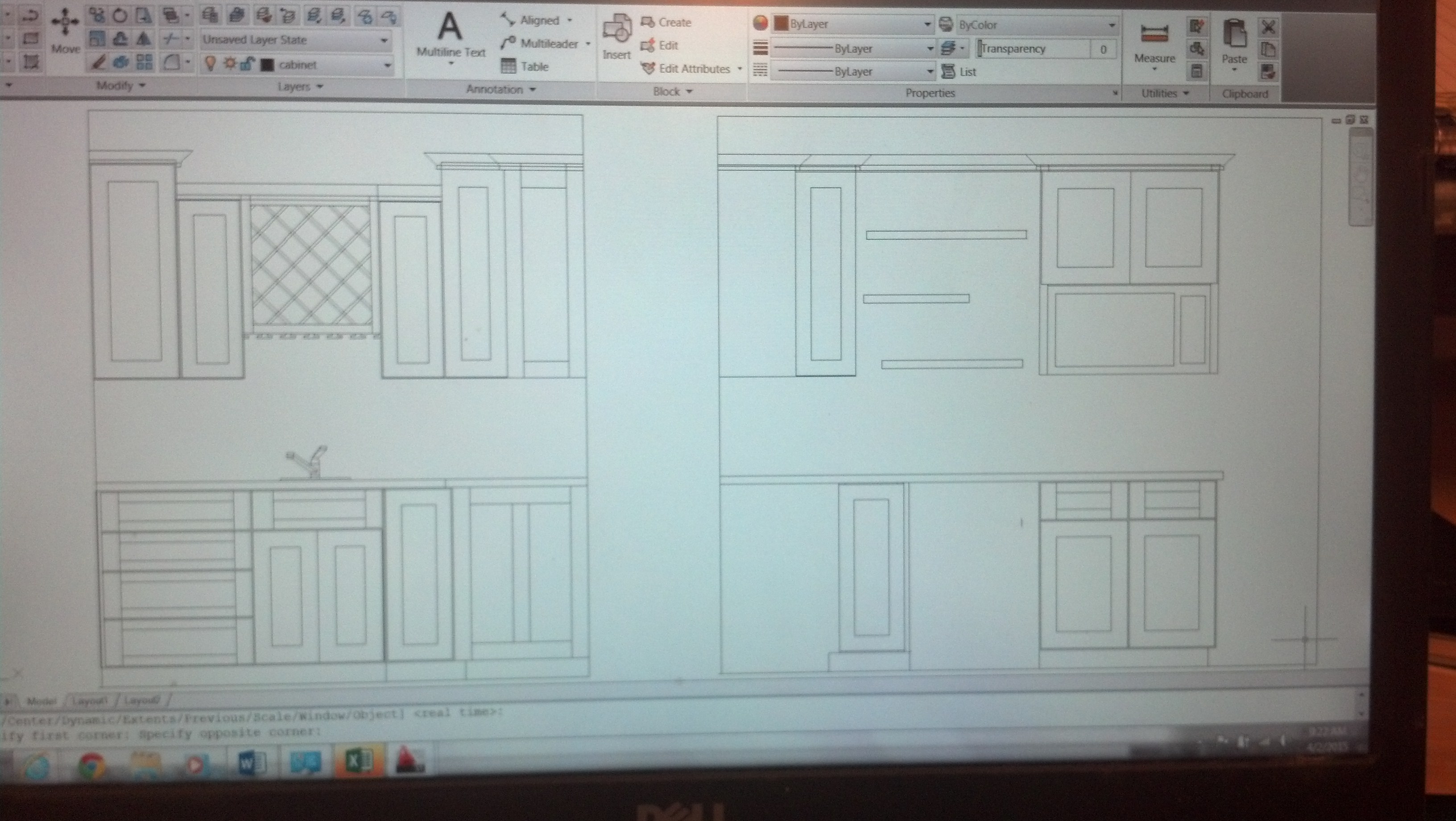

I am looking for the best look to get the crown molding out over the doors, and I am unsure where to stop it. I would like to add a very simple frieze board. I don't know it would look better to go ahead and wrap it around the sides of the cabinet too (like it is all part of the crown), or if it would be better to just have over the doors. One outside will have a finished panel like the doors, but the other finished ends will be plywood. I would appreciate your input.

I glue a "face frame" strip on the top of the cabinet.
