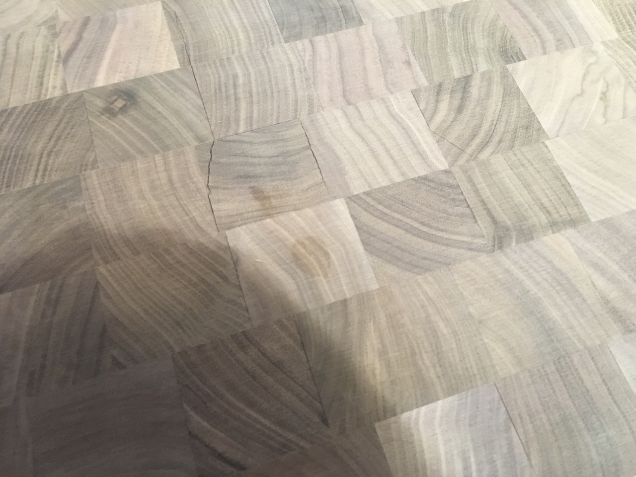

we're experiencing a strange happening in the shop this week and i wanted to get a little feedback.
first off, i understand that there can be too much clamping pressure applied that squeezes out all of the glue and starves the joint. however, what is a good barometer for applying just enough pressure? most of our glue ups are done in our jlt panel clamp and we tighten until we cannot tighten anymore (hand screws, not impact driven).
we glued up a 5" thick walnut end grain top this week that has fallen apart. i don't suspect improperly dried material as we used new wood as well as wood that has been in the shop for some time.
temperature might have something to do with it, but our shop is 65* during the day and 55* at night. this could drop to 45* where our clamps are, but i cannot imagine it getting any colder than that. night time temps have been around freezing this week.
so multiple edge grain glue-ups, then two separate end grain glue ups (all in our panel clamps) and then one glue up with pipe clamps to create the overall size. we didn't notice any issues until after the final glue up (we let it sit for 48 hours with the clamps attached - we just didn't have any time to work on it). for all of the glue ups - these were done during the day and left in the clamps overnight (14-18 hours of dry time). we'd wide belt them from there and prep for the next glue up.
this isn't our first top like this, but the first time we've experienced any issues like this. of 25-35 "rows", there is one that doesn't show any type of joint separation, so the whole thing is falling apart. 90% of our separations (maybe 40-50 total, out of approximately 350 individual pieces) are at a glue joint. we have a handful that have separated at the joint in one row and then caused another block in the next row to split in half.
maybe bad glue? we're using titebond 2. we keep it off the floor, but in our general work area.
any thoughts? we've not experienced this before and have been clamping, gluing, etc. for 10+ years like this without significant issues. we have had occasional separations at the joint but nothing like with this top. the strangest part is that everything looked good until the final block was examined before it was unclamped (approximately 4-5 days after the initial glue ups).

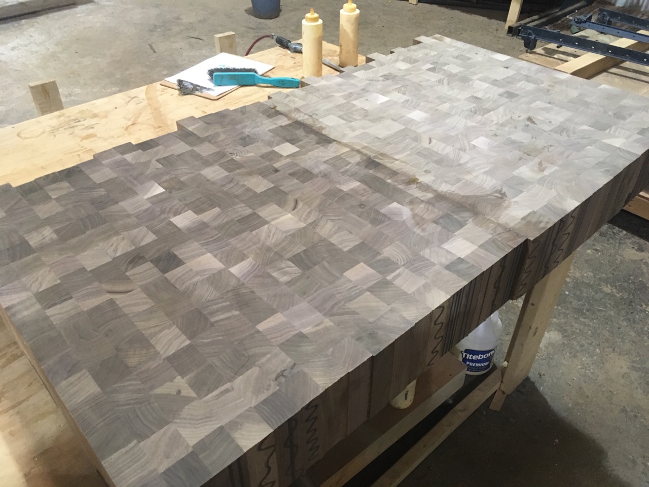

we didn't and don't typically use cauls to clamp. we're working with over-sized pieces so any dents the clamps would cause are inconsequential. i'm also not sure about compression.
the large majority of the joints that have opened up are between pieces that would have been initially glued up in edge grain construction.
see the pics.

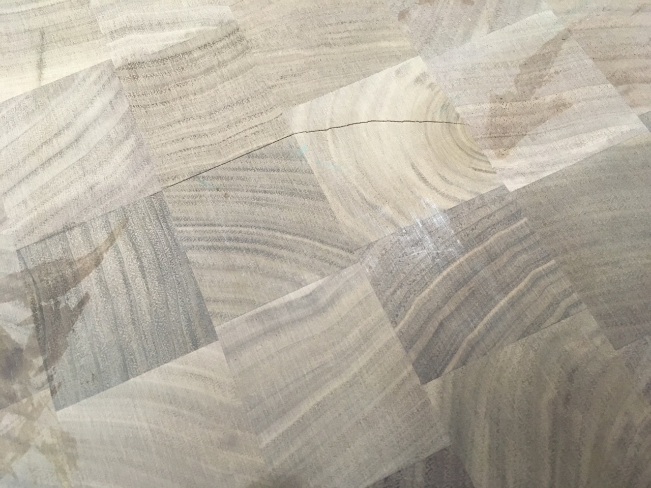

it wasn't dropped. we glued it up on a low cart and my best employee reported the bad news. my guys don't have any problem reporting problems.
there are probably 20% of these splits not along a joint and they seem to be in line with two joints that split apart. i'm guessing the joint splits just caused enough pressure to crack some blocks down the middle. and they could have been there before. highly unlikely that we would have missed them for the sheen number of them present. plus, our edge grain glue ups were 20-30" long so unless there was some weird honeycombing going on, all of the splits should have been at either end of these pieces, resulting in more consistent and less split blocks.
we glued this up on a low cart and had pieces of dunnage beneath the clamps. this put the block 4-5" off the cart, but still within 20" of the floor. the bottom side does look better (not as many cracks) but is still far from repairable.

" i don't suspect improperly dried material as we used new wood as well as wood that has been in the shop for some time."
That sets off an alarm bell for me. Did you check the MC of both stocks of wood? How long was the new stuff allowed to acclimate prior to use? Given usable glue and the milling and clamping procedures you have described I would suspect inconsistent MC in the lumber used or perhaps a major change in RH between storage and shop conditions.
The second photo shows a split running from one glueline extending across an adjacent block well away from a glueline. It looks like some local shrinkage is going on.What are the storage conditions for the old stock? If it was kept in the same conditions as the shop floor I would guess that the new stock included some material of a higher MC.

lastly, the bottom side (when glued was 4-5" off the bottom of a cart) shows way less open joints. maybe 15 total (vs. 40-50 on the top side). thoughts?

Your issue with more broken joints on the top surface versus the bottom is due to air movement. You let the shop temp drop at night, then crank up the heat in the morning. You are getting warm air flowing more easily over the top than the bottom so the top surface changes faster. You do this everyday to all the work in progress in your shop. Surprised we haven't heard more issues from you on table tops or solid panel doors. All this wood movement discussion is solid woodworking 101. As mentioned, read Hoadley's book!
3/20/17       #30: too much clamping pressure - starve ...
the google
rich - i'm curious as to how much room you leave under your panels. i left 4-5" for the last glue up. we would normally leave them on the clamps on a table (so 2" off the table).
i'm aware of what can happen if you leave a panel on a table top with no space in between. i figured i was allowing for adequate air flow.

Kevin Jenness
the google,
If the only real difference is thickness, that lends force to JR Rutter's comment above (#28) about the faces drying out while the core is still wet. As the moisture equalized, the cracks closed up. This would suggest that switching to epoxy would be helpful.
Be aware that the mating surfaces should be rough (sawn or sanded at 80#). In my experience that plus moderate clamping pressure gives a reliable glue joint.
The added expense of epoxy is negligible compared to the situation you have now. If you intend to stick with waterbased glue, perhaps covering the panel on both sides would slow down the surface drying sufficiently to avoid cracking.

Hi everyone! Nobody mention glueing tactic.
I would gluing 2"x2"x8' in to slab first to wide capacity of your machine : planer or wide belt sander. Than cros sliced to 5" plank and glue it.

We built near the exact top out of black wallnut 1 years ago. The top was fine when we installed it. Our top did the same thing after 3 months in the heating season. We sealed the top and the bottom with oil. We did everything possible to prevent any issues when we built the new top. I got the dreaded call about 4 weeks back that the top was split one morning. The splits start near glue joints but actually go across the top. I am convinced that we can not do a 6" thick end grain wallnut top. We have built many end grain hard maple tops with no issues other than the normal stuff (seal the bottom and do not dry one side faster than the other) Please let me know what the answer is to this issue. I need to replace this top again. I am thinking we will produce the top with a thick veneer, glued to a man made core to get the same look.
