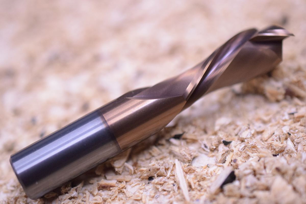

I will say that we are flute sharpening the coated bits which does not remove the coating on the diameter which does make them last longer.
We have had great results with our new coated bits in the 2017 catalog. We have had feed rates well over 1000 IPM. Feedback from the AWFS show, people are saying they went from running 40 boards to over 300.
